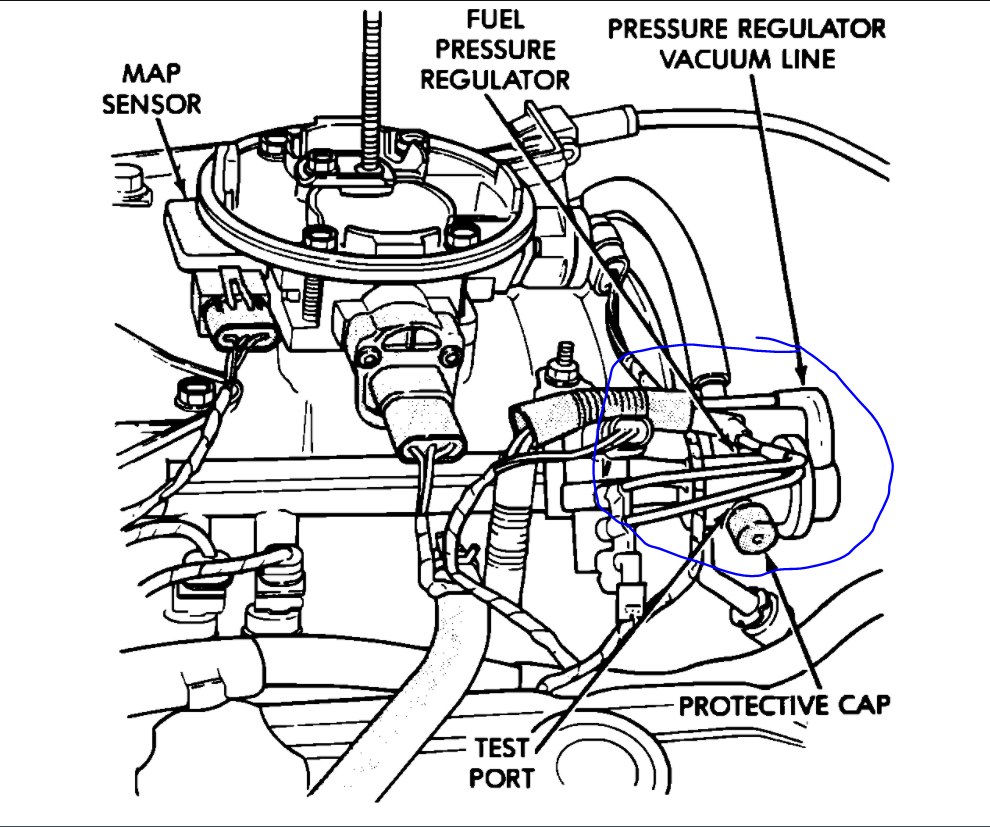

last few months has not started on 1st crank when cold but does all day after that. changed plugs and wires, distributor cap and rotor, fuel pump and filter. choke is closed when cold. might have forgotten any more changes. thought it could be the fuel pressure regulator but part i got that is suppose to be that part doesn't seem to be any where on carburetor. Vehicle listed above has a 3.9l mpfi, dual port carburetor.
Nov 2, 2020 at 3:29 PM

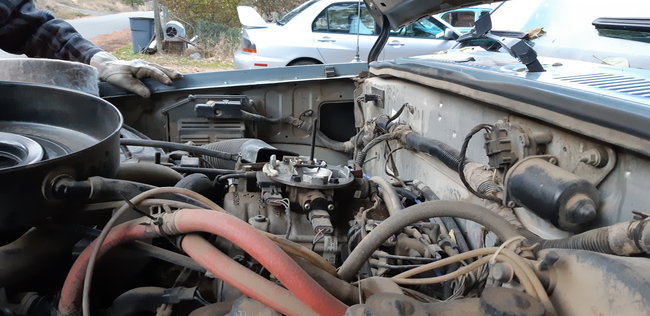

Good morning,

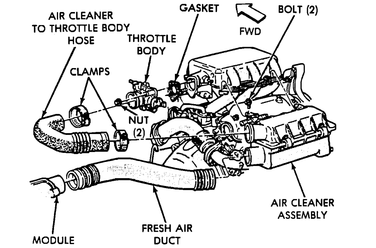

You stated multiport fuel injected. There is no choke on a fuel injection system.
Can you post a picture of the throttle body or carburetor you have?
Cold start extended crank could be from fuel pump loosing its prime over night which means it could be a bad injector leaking or the check valve in the pump.
Can you test the fuel pressure when cold to see if there is any pressure in the system
Fuel Pressure* .................... 331 ± 14 kPa (48 ± 2 psi)
Ignition key ON, engine OFF. Using DRB scan tool, access ASD Fuel System Test. The ASD Fuel System Test will activate the fuel pump and pressurize the system.

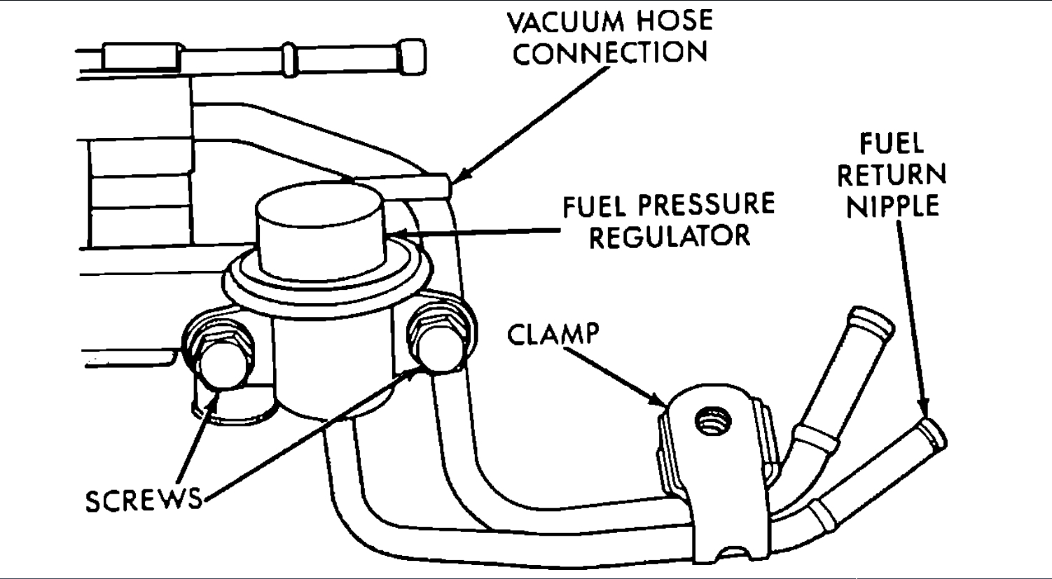

I attached a picture of the regulator for you as well.
The fuel pressure regulator is mounted to the fuel rail assembly at the opposite end from the fuel inlet line. The intake plenum must be removed to access the fuel pressure regulator.
Warning: The fuel system is under constant pressure, even when the engine is OFF. Always release fuel pressure before servicing any fuel system component.
Removal
1. Release fuel system pressure.
2. Remove the fuel rail.
3. Remove 2 attaching bolts and remove fuel pressure regulator from fuel rail. Inspect O-ring for damage or wear and replace if necessary.
4. Loosen and remove fuel return hose.
Installation
1. Lube fuel pressure O-ring with clean engine oil prior to installation. Press regulator into fuel rail, attach 2 mounting bolts and torque to 8.7 Nm (77 lb-in).
2. Install fuel return hose and torque to 1 Nm (10 lb-in).
Note: ASD and fuel pump relays remain energized for 7 minutes during the following test, unless the test is stopped or the ignition switch is turned to the OFF position.
5. Using scan tool, place ignition switch in "run" position and use Actuate Output Test Auto Shutdown (ASD) Relay", to activate fuel pump and pressurize system.
6. Check for leaks.

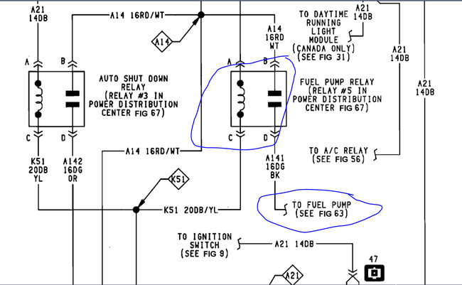

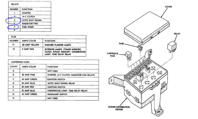

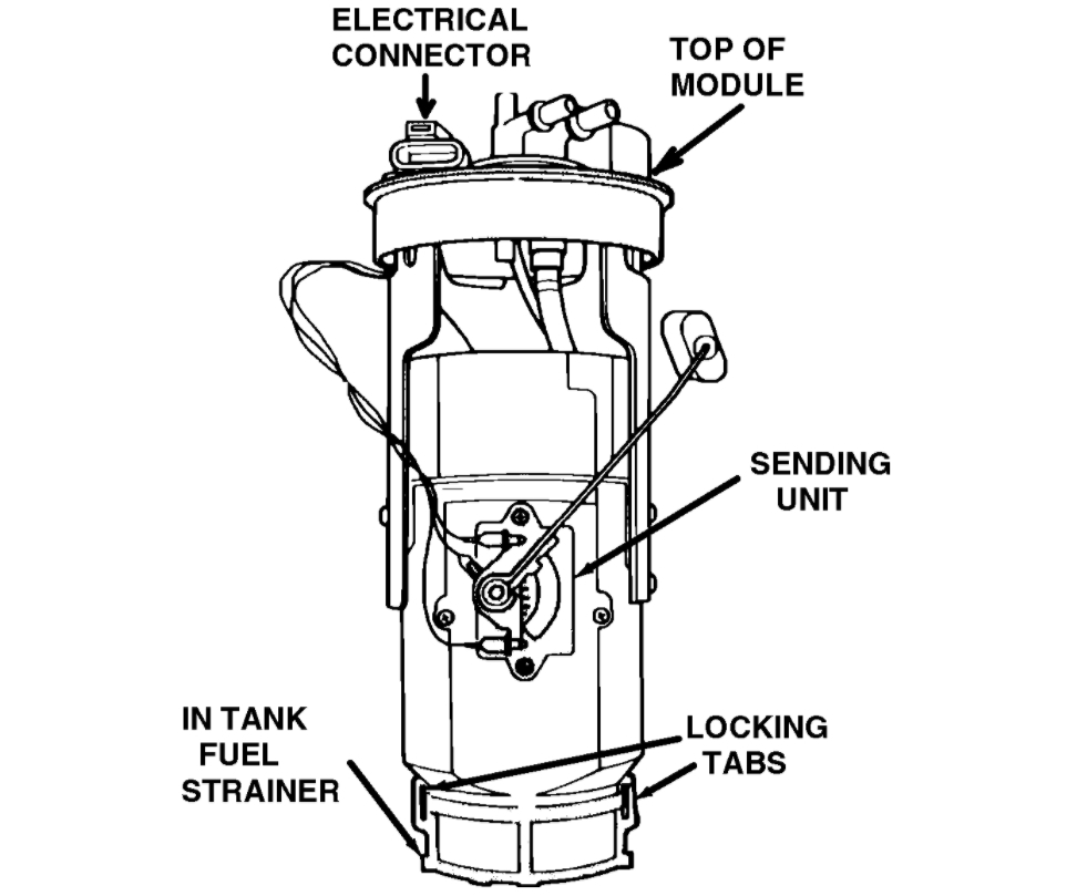

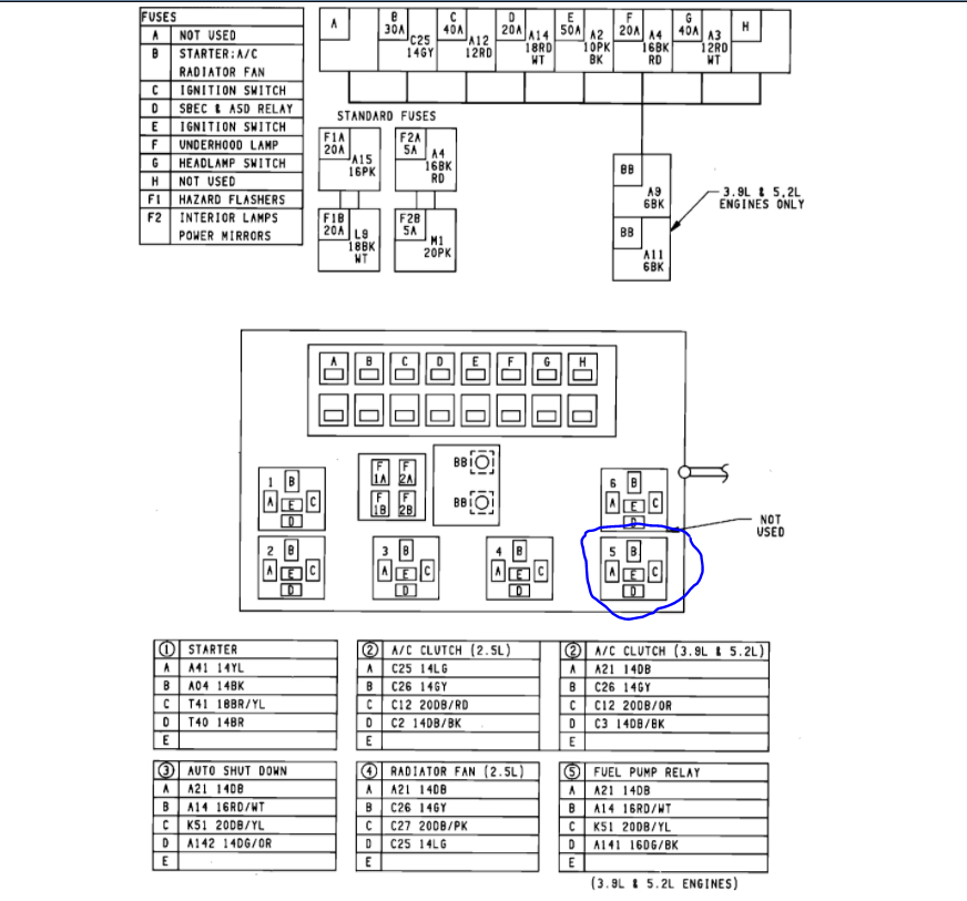

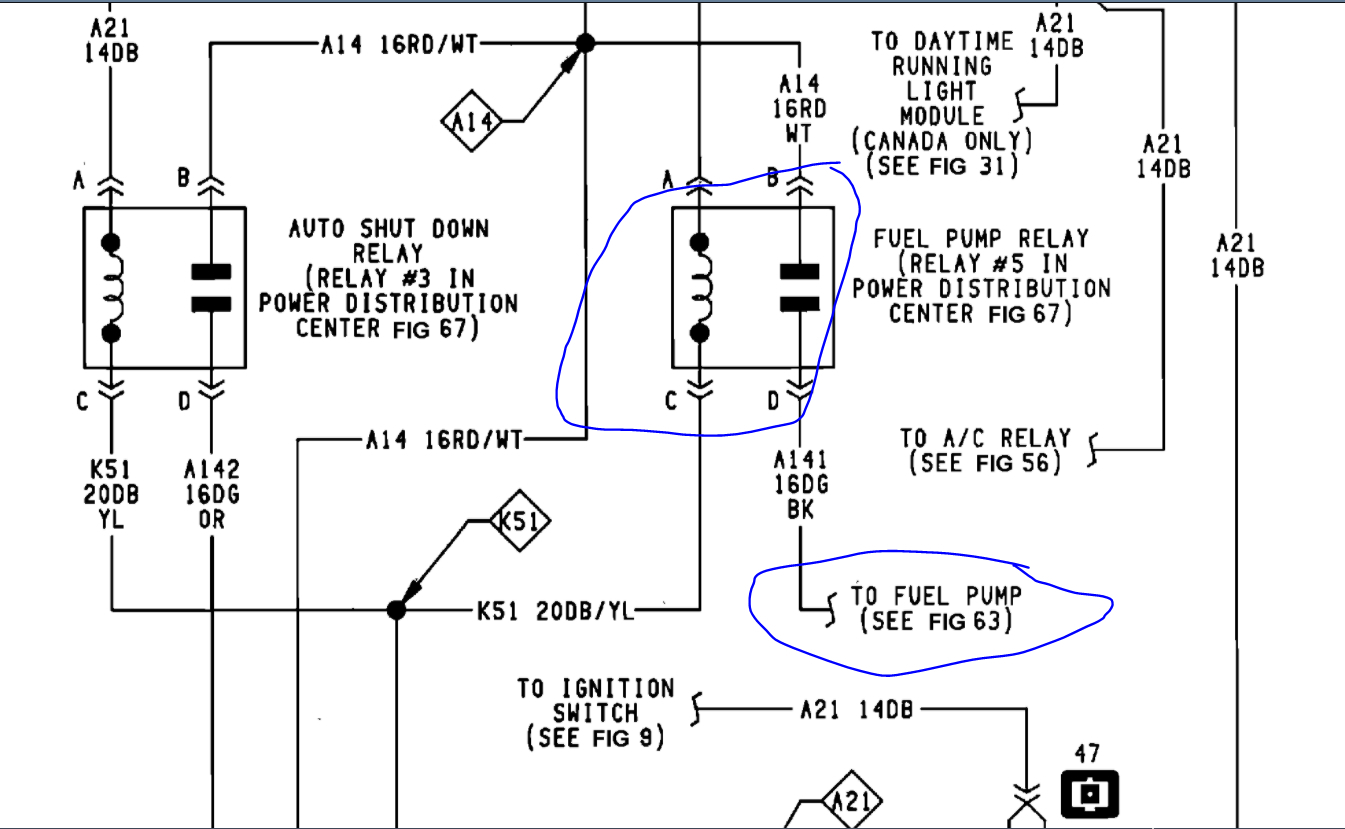

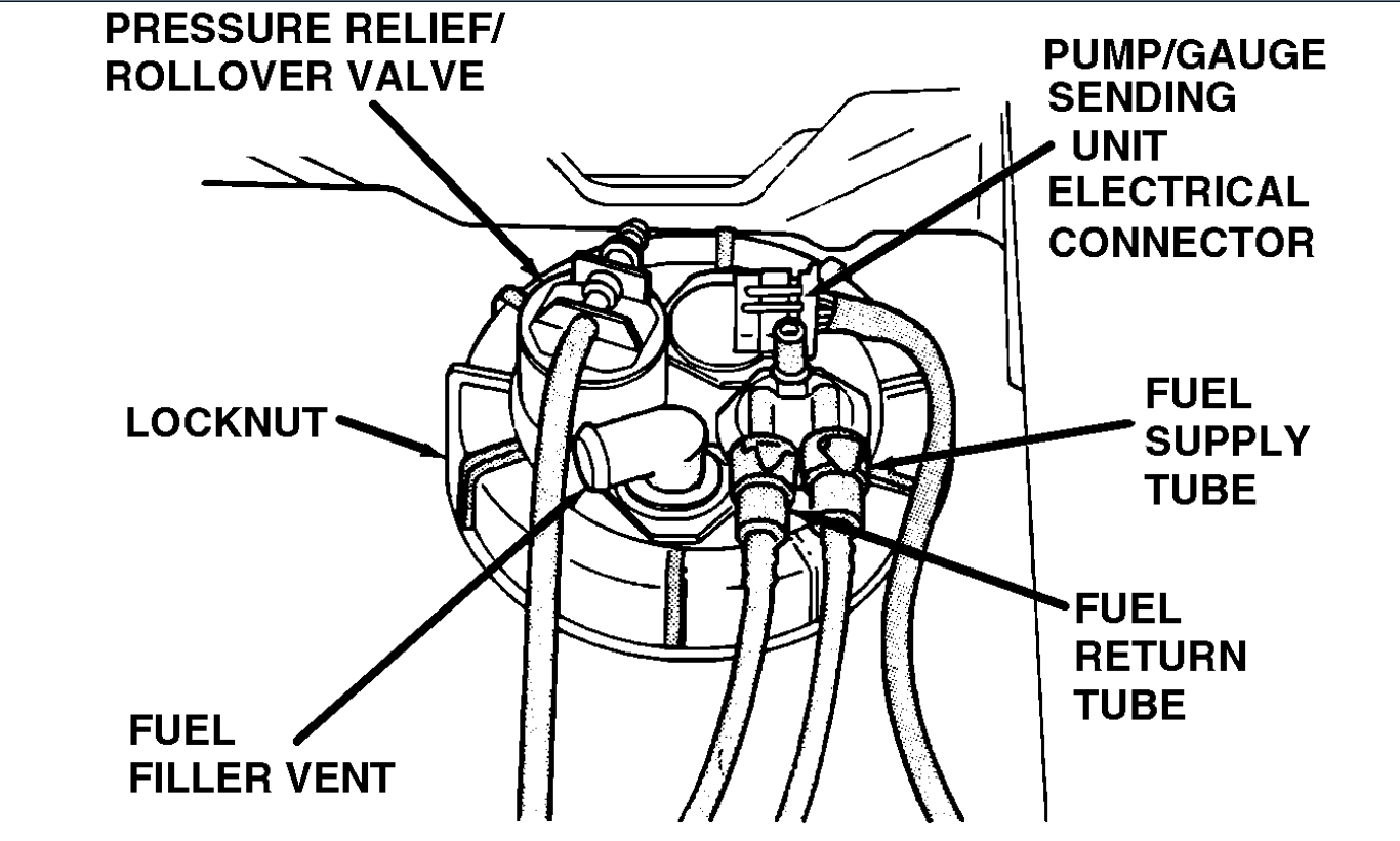

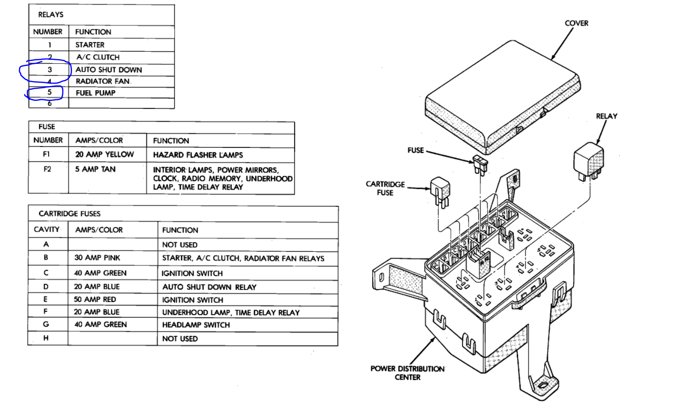

I've had to use my truck a couple of times and both times when I turn on the key I can not hear the fuel pump pumping. After many times of cranking it over a few seconds each time the pump finally starts pumping, it pumps for quite awhile but when it stops pumping the truck will start. Today when I used it it was hard starting again after I stopped for gas. So it is getting worse. Haven't got the new fuel pressure controller installed yet. Working out side and weather not cooperating. It appears the controller is under several hoses at the back of the passenger side of engine. Is that the location of it? Thanks again, Al James. Pressure gauge not here yet.
Nov 12, 2020 at 2:43 PM
Okay, controller? Do you mean the relay? The ECM is what controls the fuel pump relay based on the input from the ignition system.

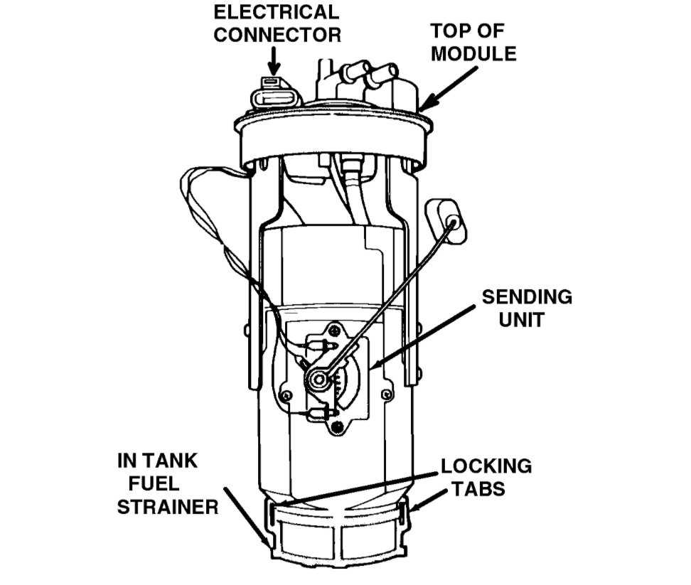

I attached the wiring diagram for you as well as the location of the fuel pump relay.
FUEL PUMP MODULE REMOVAL:
WARNING: The fuel system is under constant pressure, even when the engine is OFF. Always release fuel pressure before servicing any fuel system component.
Fuel Hose Fitting On Fuel Pump Module
1. Release fuel pressure.
2. Drain fuel tank.
3. Remove fuel tank.
4. While holding the fuel pump module down, remove the locknut, (locknut is threaded onto tank). Use a brass drift to loosen the fuel pump locknut. After the locknut has been removed release the fuel pump module and it will spring up from the fuel tank.
5. Remove the fuel pump module from the fuel tank.

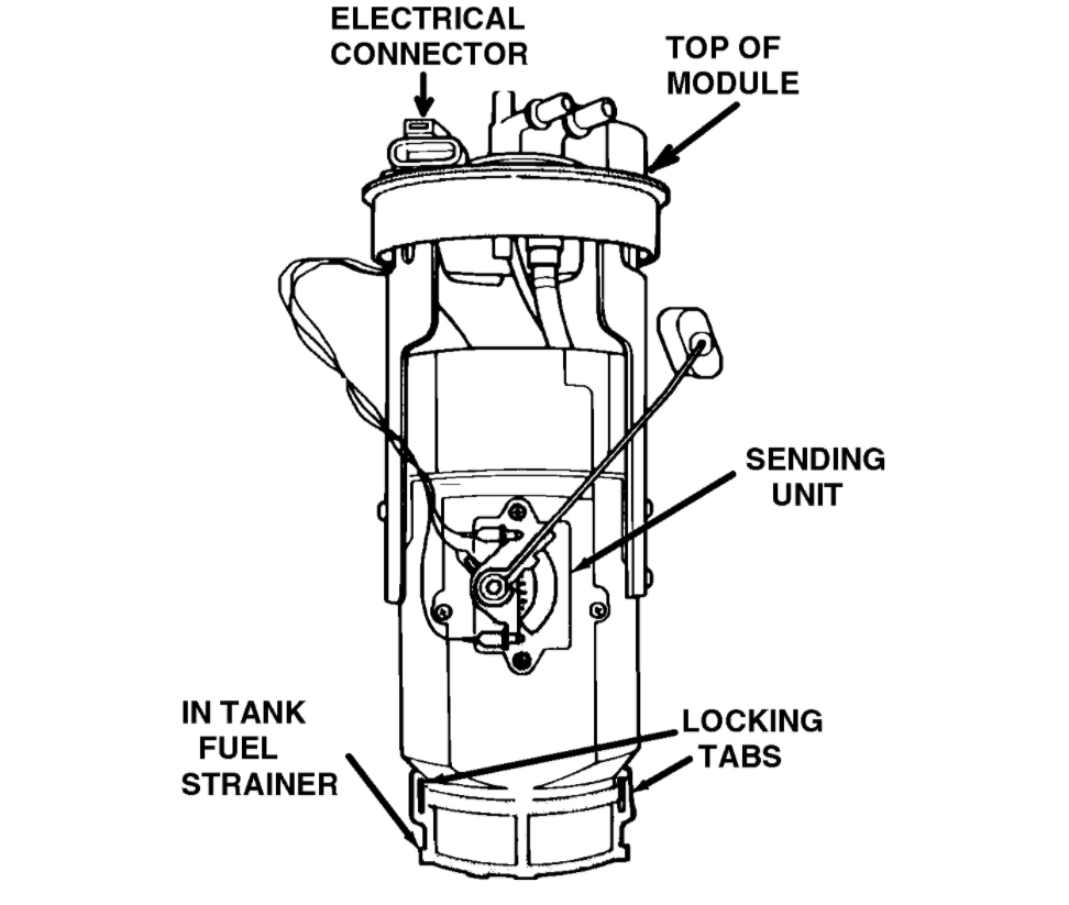

DISASSEMBLY
Fuel Gauge Sending Unit And In-Tank Filter
FUEL GAUGE SENDING UNIT REMOVAL
1. Remove sending unit attaching screws from mounting bracket located on the side of the fuel pump reservoir.
2. Disconnect electrical connections from sending unit, and remove sending unit.
IN-TANK FUEL FILTER REMOVAL
1. Pry back the fuel filter mounting tabs and pull the fuel filter off of the fuel pump module.
NOTE: The fuel pump is not serviceable, if the pump is defective replace the whole fuel pump module.

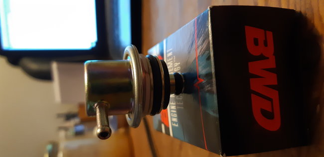

The part I have doesn't have an electrical connection. It is suppose to be the fuel pressure controller. It looks more like a vacuum tube connection. I went on rockauto.com to identify the and FPC and that was the part shown but it looked too big and I couldn't figure how it could control the pressure with out an electrical connection. I thought it was the wrong part so went to parts store and ordered a FPC and they sent the same part as rock auto had. I put a new fuel pump in thinking it was the problem. I'll have more time in morning to review the rest of your reply and reply further. thanks, Al.
Nov 13, 2020 at 4:13 PM
Can you send me a picture of the part?
There is a fuel pressure regulator but that just limits the pressure to the manufacturers specs.
The fuel pressure regulator is a mechanical device not controlled by the Engine Controller. The regulator is a vacuum balanced nonadjustable type mounted on the output end of the fuel rail, and connected to intake manifold vacuum. The fuel return tube is mounted to the pressure regulator. The regulator is calibrated to maintain fuel pressure at 214 kPa (31 psi), with vacuum applied at idle. With vacuum disconnected the fuel pressure will run 55-69 kPa (8-10 psi) higher. The regulator contains a diaphragm, calibrated spring, and a fuel return valve. Fuel pressure operates on one side of the regulator, while spring pressure and intake manifold vacuum operate on the other side. Spring pressure on one side of the diaphragm tries to force the return valve closed. Fuel pressure on the other side of the diaphragm, with assistance from manifold vacuum on the spring side of the diaphragm, act against spring pressure to open the return valve. System fuel pressure is the amount of fuel pressure required to force against spring pressure and unseat the return valve.
Nov 13, 2020 at 8:20 PM
ALJ
  • 36 POSTS

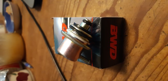

Should have photos. As you can see there is no test port on the side of the part I have, as it appears the regulator in the drawing has a test port on the side. also appears from drawing that the regulator is on the driver side at back of motor. Is that the correct placement? I'll have to check again but thought I saw the part on the back on passenger side.
Nov 16, 2020 at 7:35 AM
According to the picture, it is on the driver's side at the back of the rail.
Double-check again to confirm.
Nov 16, 2020 at 7:42 AM

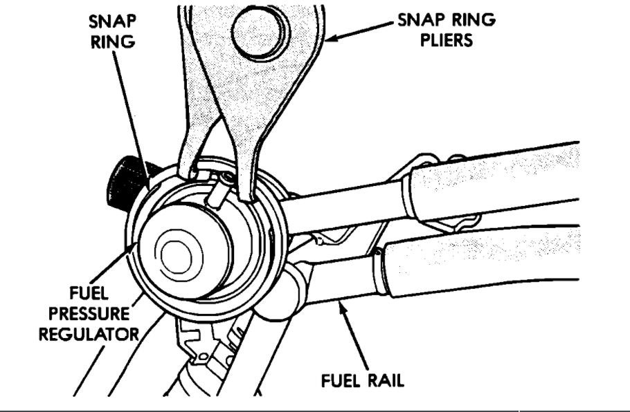

Still dodging rain and snow but did grab a peek at the regulator. However, I don't see any bolts holding it on. Don't see how it comes off. The regulator on the truck has several tubes and the test valve on it and it looks like its one whole unit. Doesn't look like the end piece, like I have, comes off.
Nov 18, 2020 at 5:53 AM
I attached the procedure for replacing it.
There is a snap ring holding it in. I attached a picture for you.
REMOVAL
2. Disconnect negative battery cable, and remove air cleaner assembly.
3. Disconnect vacuum hose from throttle body.
Fuel Pressure Regulator Removal
4. Using snap ring pliers, remove snap ring and pressure regulator.
5. Remove O-rings from regulator.
INSTALLATION
1. Install new O-rings on regulator.
2. Push regulator into fuel rail, with vacuum nipple pointed straight up.
3. Install snap ring.
4. Connect vacuum hose to regulator.
5. Connect negative battery cable, start engine and check for leaks.
6. Install air cleaner assembly.

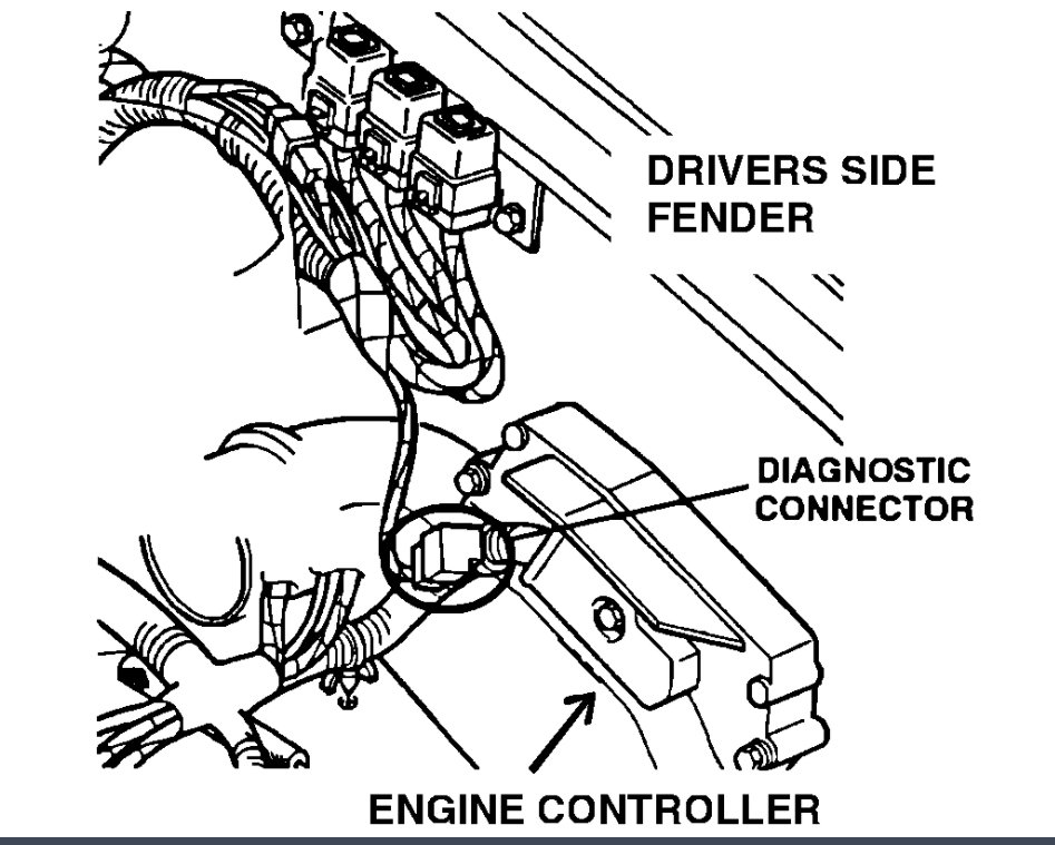

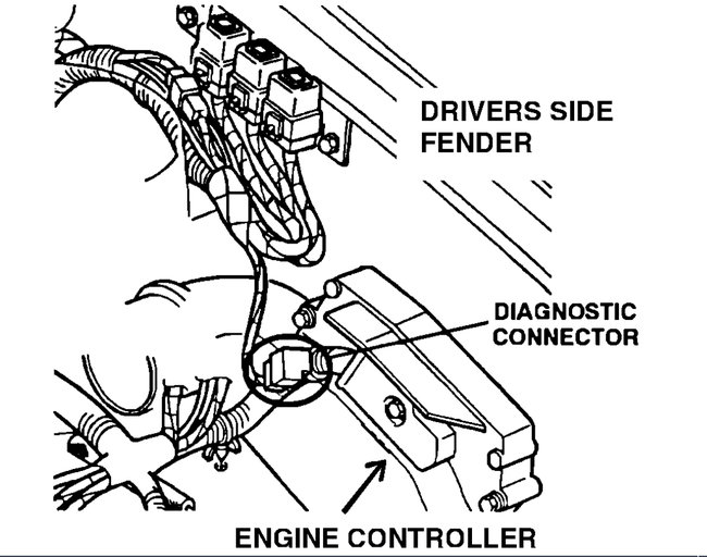

I posted the location and procedure for you for the ECM.
REMOVAL
The engine controller is located in the engine compartment behind the battery and under the left front fender.

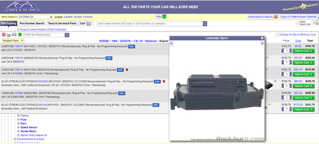

I attached the ECM for you from Rock Auto. They have them in stock and they are plug and play with no programming needed.

Thanks. Yes, I check them out. Nice day here should be able to test with scanner today. Is the plug to connect the scanner the diagnostic connection in the drawing from a previous message?

Well sir, good weather but no go. First there is no box/ECM on the inside of the driver side fender. There is a black box with a lid on it and a large bundle of wires going into it. I took the lid off and there are 4 or 5 small clear plastic topped square look like plug in fuses or switches? Electrical anyway. The plug for the scanner is on the passenger side fire wall. I plugged the scanner in and tried a scan and it kept saying vehicle not responding. Turned key on, same thing. After key was on awhile I heard the pump working away. Tried to start to see if that would change the read out, but start. The picture of the ECM at rock auto is not visible anywhere under my hood. There is a box on passenger side fender but bigger and looks nothing like the picture. Wife's away today on med visit, will send a photo Thursday when see gets back with the cell phone. Thanks again. Al.
Nov 25, 2020 at 5:52 AM
Can you post some pictures of under the hood for me?
Nov 25, 2020 at 5:54 AM

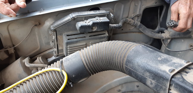

Fancy meeting you here. I was on my wife's cell checking out the location of the ECM and saw a 3 year old YouTube video of installing an ECM in a 1992 Dodge Dakota and it is on the passenger side fender. I recognized the box from my truck. it appears to be bigger than the Rock Auto pic. But ordered one from Rock Auto and see if it matches. Figure I've gotten a couple hundred thousand more Km than they were intended to last and the fact the scanner couldn't get a response from the truck. I'll send pics when I get up. Just as I was turning off the cell phone in order to send this, I saw you had sent your last message above. Thanks, Al.
Nov 25, 2020 at 6:37 PM
You are welcome.
Nov 25, 2020 at 6:43 PM
ALJ
  • 36 POSTS
here is the ECM and plug passenger side.
Nov 26, 2020 at 4:16 AM
That is it, Make sure the numbers on the ECM are the same as the replacement.
Nov 26, 2020 at 7:09 AM
