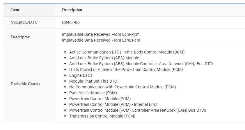

Okay, I found a scan tool that my dad had laying around and it gives me code U0401 Invalid Data Received from ECM/PCM. So could it be the ECM/PCM or could it be a bad relay or some wiring issue?

Okay, this code has a lot of possibilities for your issue. I attached the possible failures below and also a flow chart as well.
This may require someone with the knowledge to track this down especially with the CAN line being an issue.
U0401-86-IMPLAUSIBLE DATA RECEIVED FROM ECM/PCM - SIGNAL INVALID
For a complete wiring diagram, refer to the Wiring Information.

Incorrect data received from the Powertrain Control Module (PCM).
