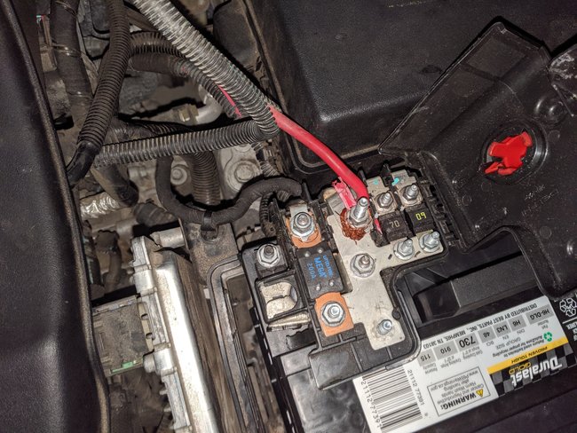

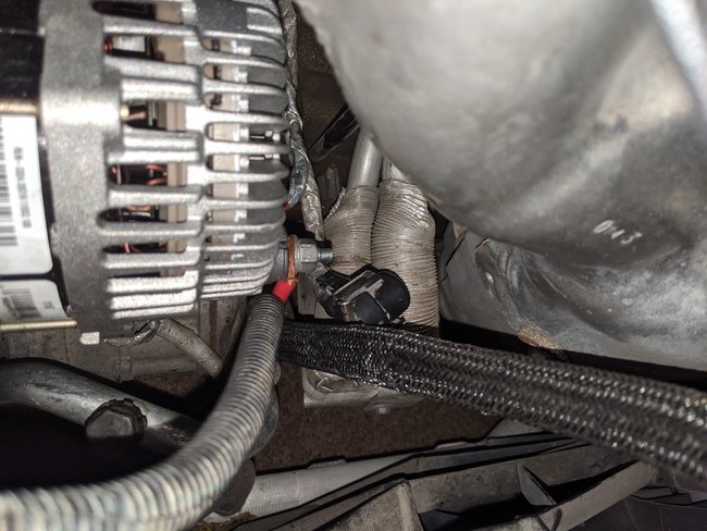

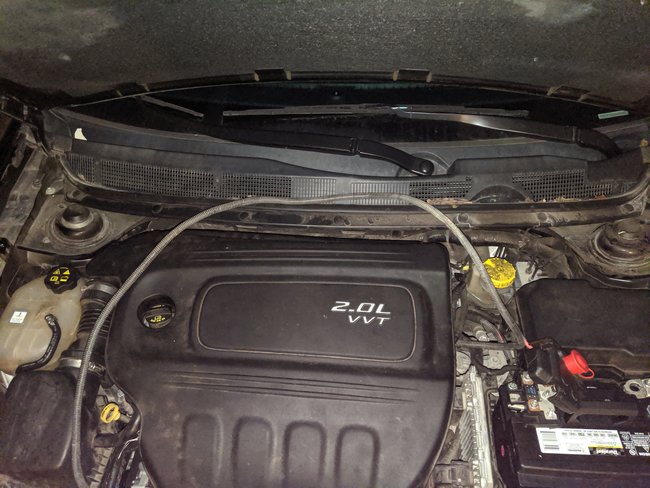

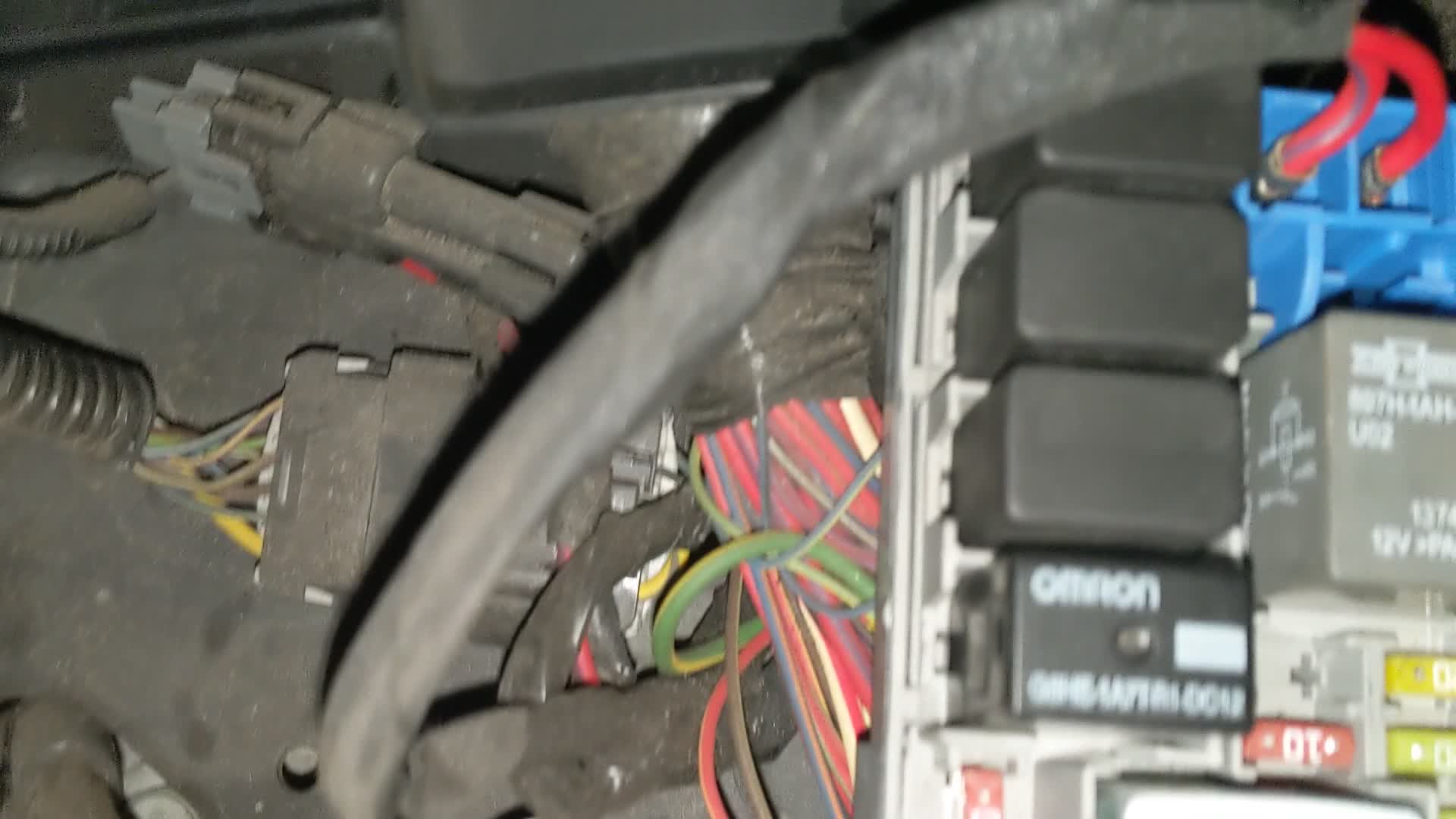

I had problems with my car turning off while driving about a year ago, but then last week it died on me. got my battery and alternator checked. Turned out my alternator was bad. My dad installed the new one and according to him he thinks the wire that goes from the alternator to the battery is bad, so he peeled the wires I guess to bypass the sensor, if it has one, and hooked it up directly to the battery. Then he tells me it's the battery. I got a new one and all the car does is start up immediately shuts off. What could be causing this.
Nov 8, 2019 at 7:37 AM
Good evening,
Can you post some pictures of the wire you are talking about for me to see?
Do you have a voltmeter to do some testing?
Nov 8, 2019 at 8:04 AM
SPIKETORRES
  • 23 POSTS
Yes, here are the pictures. I didn't know I would get a response this fast. I don't have a voltmeter though.
Nov 8, 2019 at 8:13 AM
Wow.
Okay, you will need to get a voltmeter to do some testing. We need to see if the alternator is working.

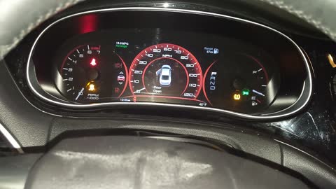

So I can't get access to a voltmeter yet, maybe until tomorrow morning. I do however have this video of what the car does when I try to turn it on. I don't know if this helps at all.

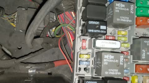

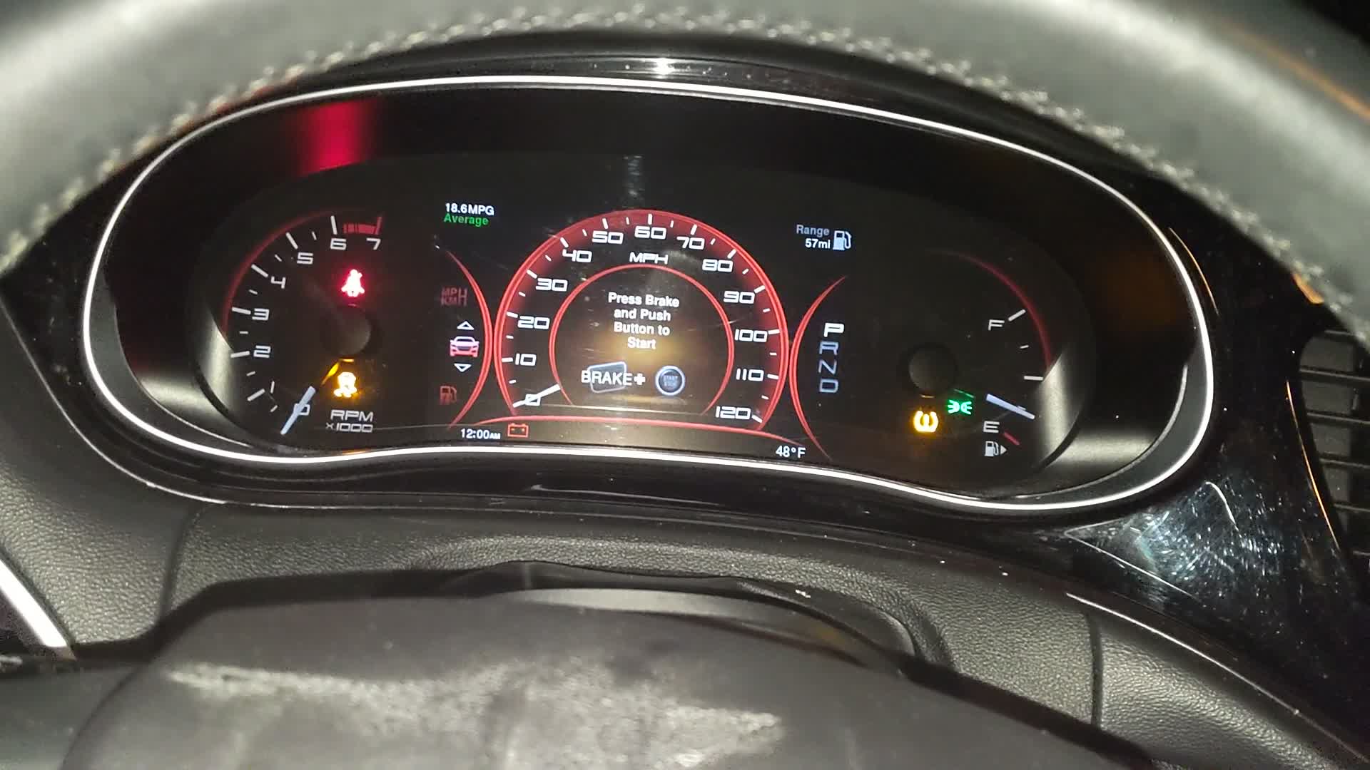

After I turn everything completely off, I hear this kind of clicking noises coming from what seems to be on the relay box behind the battery also followed by one that seems to be coming from under or at least close to the engine.

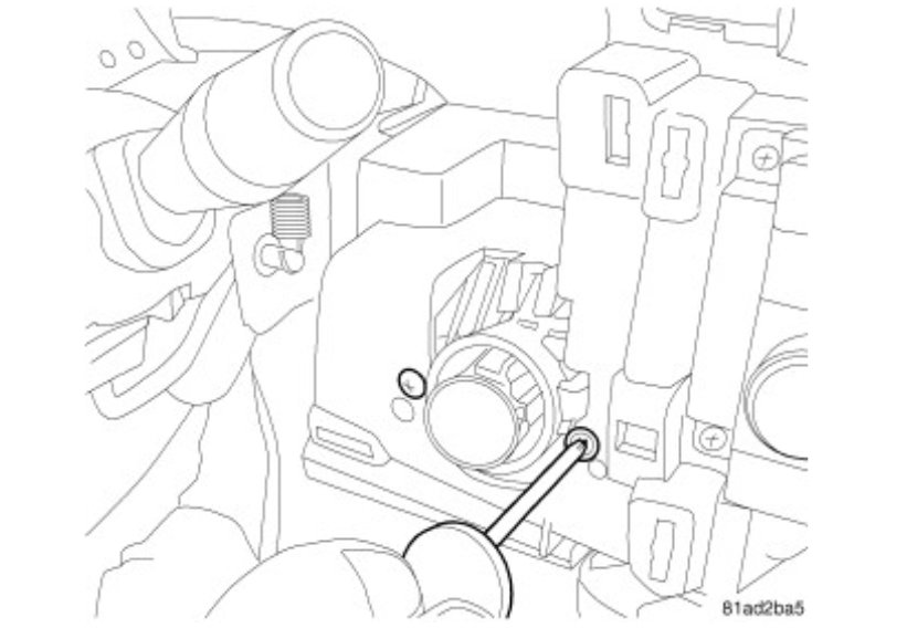

This sounds like an ignition switch. It starts in the start position and shuts off in the run position.
REMOVAL
1. Disconnect the and isolate the negative battery cable.
2. Remove the dash end cap See: Dashboard / Instrument Panel > Removal and Replacement > Instrument Panel End Cap - Removal.
3. Remove the steering column opening cover.
4. Remove the HVAC control head See: Control Assembly, HVAC > Removal and Replacement > A/C And Heater Control - Removal.
5. Remove the instrument cluster bezel See: Dashboard / Instrument Panel > Removal and Replacement > Instrument Cluster Bezel - Removal.
6. Disconnect the wire harness connector from the Ignition Node Module.
7. Remove 4 screws from the I/P holding the Ignition Node Module in place.
8. Remove the Ignition Node Module from the backside of the I/P.
Nov 8, 2019 at 9:04 AM
This could still be related to the ignition switch.

Okay, I have a voltmeter. Also I disconnected that wire I showed you on the first picture I sent you. And connected the original and I managed to turn the car on, but after a while it shut off. I recharged the battery and it turned on again and then shut off again.

Sorry, I have been busy so I hadn't had time to work on the car. Okay, earlier this week I looked at it more closely. My dad unplugged the alternator wire from the alternator but left it connected to the battery on a 200amp fuse which has two terminals. I then unplugged it from the battery so that was eliminated completely. I then hooked up another wire from the alternator to the battery at the opposite terminal at the 200 amp fuse connection and it seemed to be working for about 2 days, the only thing is it wouldn't start up in the morning until about the 3rd push of the ignition button. So we got a new fuse to replace the old one and hooked everything back up like normal and it went back to the starting up and immediately stalled.

When you turn on the key, does the theft or security light go out after 10 seconds?
Nov 15, 2019 at 8:01 AM
SPIKETORRES
  • 23 POSTS
It turns off within about 2-3 seconds.
Nov 15, 2019 at 8:38 AM
Again, the lights? Please tell me about the lights?
Nov 15, 2019 at 9:04 AM
SPIKETORRES
  • 23 POSTS
Everything comes on on the dash like normally. no check engine light or anything just the battery light stays on again. but I've been checking it and it stays at around 12.6v.
Nov 15, 2019 at 9:21 AM
Okay, let me be more specific.
I am asking you if the theft light or security light comes on and goes off. If it stays on, it is a security issue for the engine cutting off.
If it is not then we need to look somewhere else like the ignition switch.
Nov 15, 2019 at 9:27 AM
SPIKETORRES
  • 23 POSTS
Yes, the red security light comes on and then goes away when the engine shuts off.
Nov 15, 2019 at 9:44 AM
Okay, when you turn the key to on, not running, does the light stay on or does it go off after 10 seconds?
Nov 15, 2019 at 9:52 AM
SPIKETORRES
  • 23 POSTS
Okay. The security light comes on and goes away within 2-3 seconds.
Also when I do that without turning on the car, it gives me a message on the radio screen to enter anti theft code, but only when I push the "start" button on the car without starting the engine.
