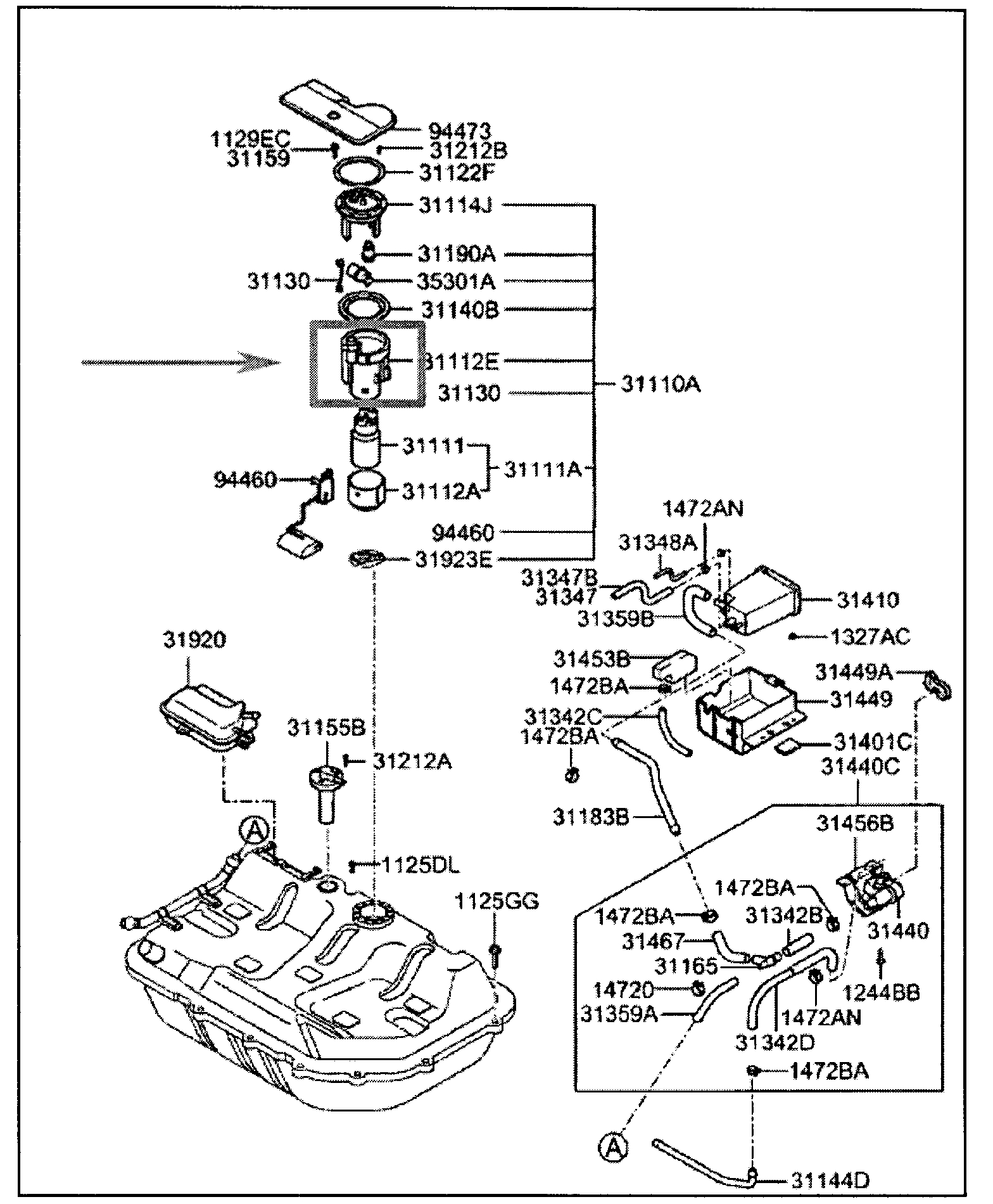

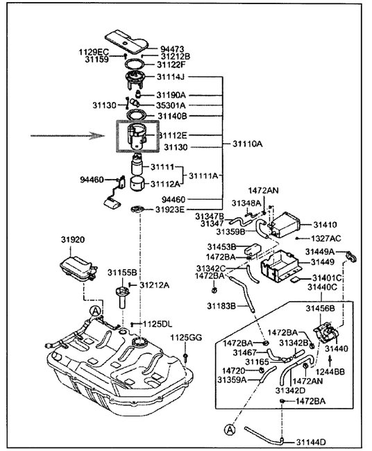

The 2003-2005 Accent Shop Manuals contain incorrect information for the fuel filter location.
For the 2003-2005MY the fuel filter is incorporated into the fuel pump assembly within the fuel tank.
- Part Number: 31112-25700 (Filter-Fuel Injection Pump).
FUEL PRESSURE TEST

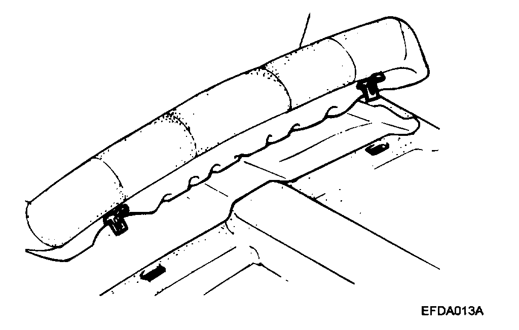

1. Press the two taps under the rear seat and raise the seat, then detach the inspection panel of the fuel pump.

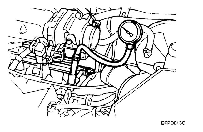

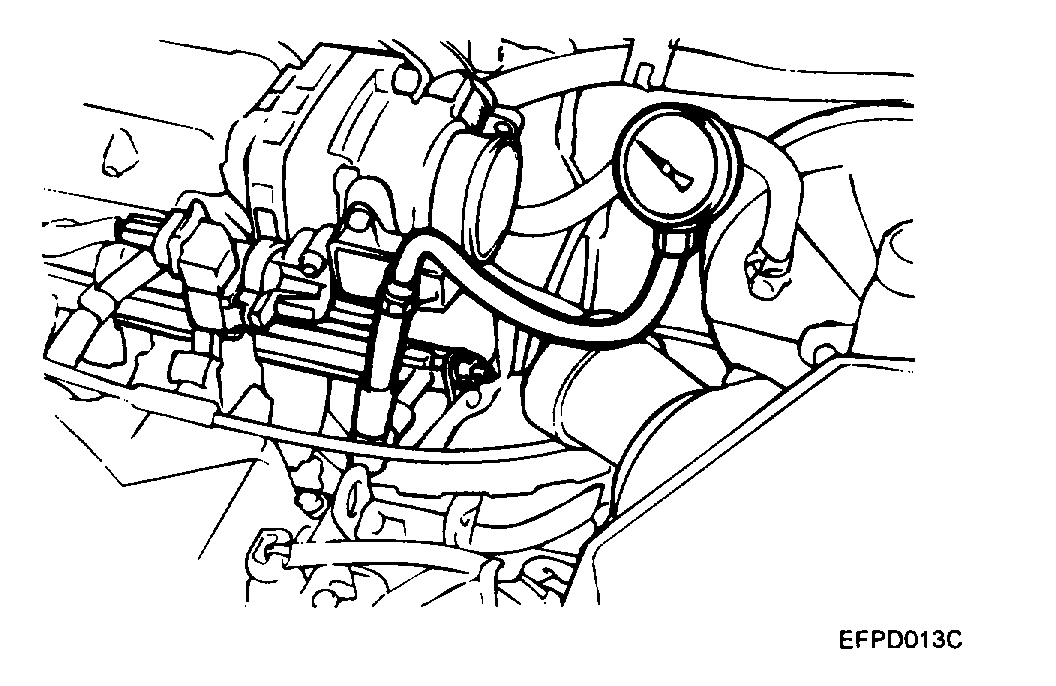

4. Using the fuel pressure gauge adapter (09353-24000, 09353-24100, 09353-38000), install the fuel-pressure gauge to the fuel rail. Tighten the bolt to the specified torque.
Tightening Torque
Fuel pressure gauge to fuel filter: 25 - 35 Nm (250 - 350 kg.cm, 18 - 26 lb.ft)
5. Connect the battery's negative (-) terminal.
6. Apply battery voltage to the terminal for the pump drive and activate the fuel pump. Then, with fuel pressure applied, check that there is no fuel leak from the pressure gauge or connections.
7. Start the engine and let it idle.
8. Measure the fuel pressure.

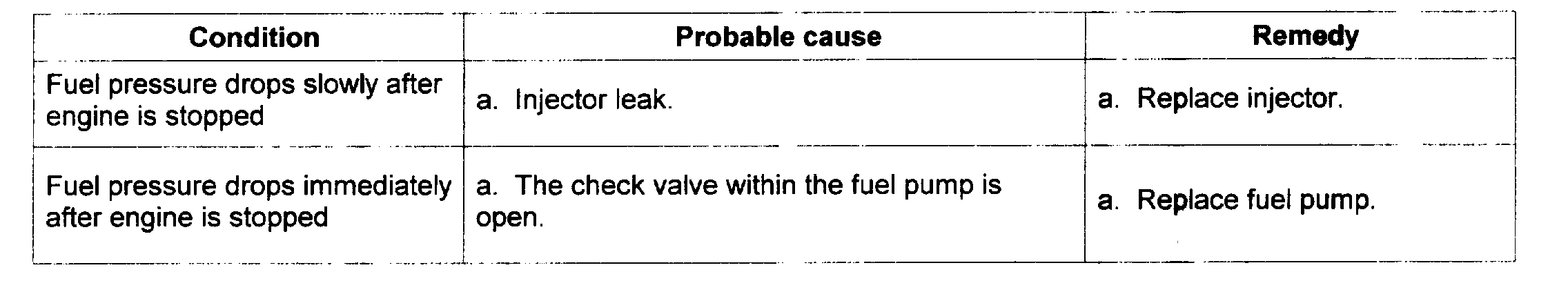

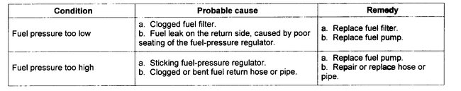

Standard value: 350 kPa (3.5 kg/sq.cm, 49.8 psi)

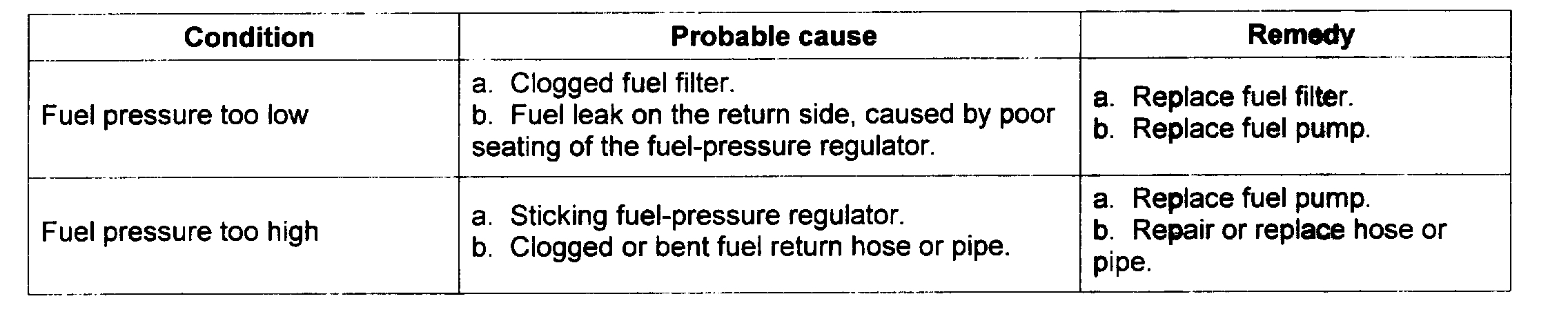

9. If the result of the measurements made in steps (7) and (8) are not within the standard value, use the table to determine the probable cause, and make the necessary repairs.
10. Stop the engine and check for a change in the fuel pressure gauge reading, which should hold for approximately 5 minutes. If the gauge indication drops, observe the rate of drop. Determine and remove the causes according to the given table.
