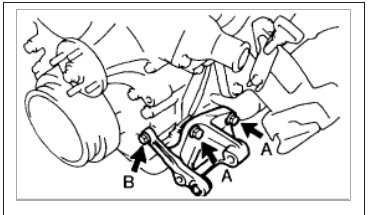

Yes, that is the first place I would look. when these sensors go out they do not set a code most of the time. Here is a guide on what you are in for when changing the sensor out:

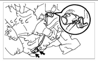

Here is the location of the crank sensor for your car (below).
