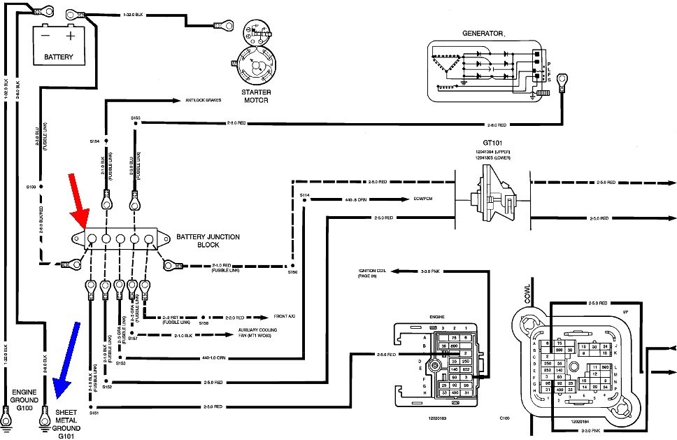

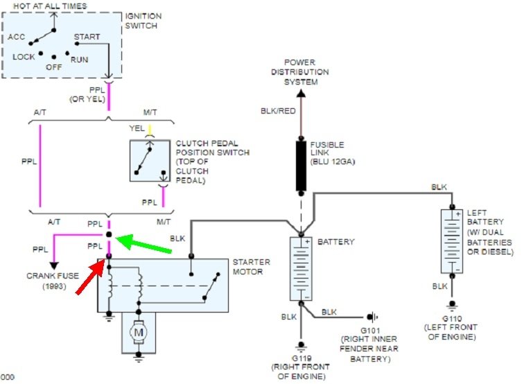

I was going to post a drawing pointing out the starter relay location, and I see they didn't use one on your truck. Normally that was only left off on small import cars with tiny starter motors. That eliminates the medium-current circuit, then that heavy job is left to the tiny contacts in the ignition and neutral safety switches. That is a lot to ask of them, so they both become good suspects.
The story is the same if you're hearing the solenoid engage, but if it isn't, we need to diagnose the ignition switch circuit. To see if that low-current circuit is working, place the test light's clip anywhere on ground. That can be the battery's negative bolt, or anywhere on the engine. Place the probe on the smaller terminal on the solenoid, then have your helper turn the ignition switch to "crank". When they do, that is when the test light should turn on full brightness. If it does, that circuit is working. If it doesn't light up, we'll have to narrow the cause down with a few more tests.
While it's not shown in this diagram, GM usually had two smaller terminals on the solenoid, and those wires can't be switched around. At this point, rather than trying to figure out which terminal is which, just check for 12 volts on both of them when the ignition switch is in "crank". We'll figure out the next step once I know what you've found up to this point.
Don't overlook the new ignition switch if it's the type bolted to the top / side of the steering column. Those have slotted bolt holes because those are the adjustment. If it is misadjusted, you may not be able to turn the key far enough to engage the starter circuit.

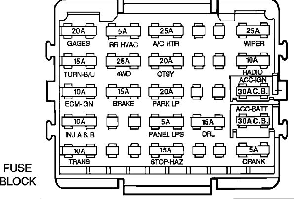

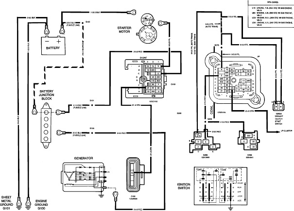

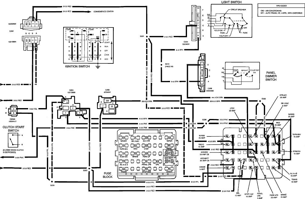

This is actually a real common problem on all car and light truck brands, but I'm not sure if it applies back to '92 models. Look at the positive battery cable and you'll see a second, smaller wire there. Follow that one to see if it is bolted to the under-hood fuse box. If it is, that connection often works loose. Check that it is clean and tight.

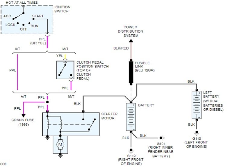

Next, follow the smaller wire from the negative battery cable to where it bolts to the body sheet metal. Be sure that is tight and not rusty.
I found these diagrams for Power Distribution. Instead of the fuse box, check the connection on the "Battery Junction Block", by my nifty red arrow, and the ground connection by the blue arrow. Also check all those other connections on the Junction Block.
The third diagram is just a cropped and expanded fuse box layout from the second diagram. Use that for future reference, if you need it.

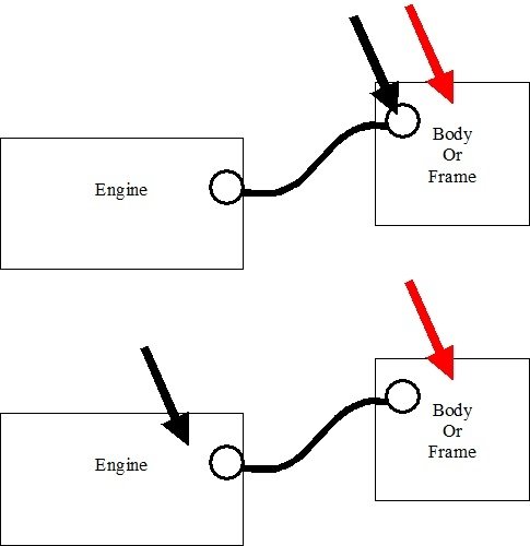

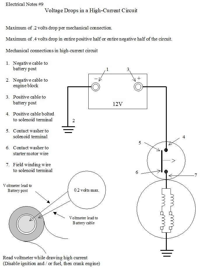

Don't waste your time checking grounds with an ohm meter. That presents the same type of misguided results as with the large battery cables. A fraction of an ohm can cause a problem, but if you hold the meter's probes together on the meter's lowest range, you'll see there's a good three to five ohms of resistance just in the meter's leads themselves. That eliminates any accuracy in readings this low.
The better test is to perform a voltage drop test across the connection under test. You can also include the entire wire in the test by where you place the meter's probes. I threw together this little drawing to show this. In the top drawing, one meter probe is on a paint-free point on the body, and the other one is on the terminal bolted to it, (not the bolt head). Current has to be trying to flow through that connection, so lights, fan motors, or something in that circuit has to be turned on. While the resistance might be too small to measure directly, this will show how much voltage is dropped across that resistance. Ideally you want to see 0.00 volts, but it's not uncommon to see some. Whatever you find here, subtract that from the battery's 12.6 volts, and that's how much you're left with to run the circuit. When this undesirable resistance is causing the circuit to be dead, expect this voltage to be real high, even as high as 12.6 volts if there is no other alternate path for current to flow.
If you find close to 0.00 volts, the next step is to test every point in that circuit the same way. In this case that means leaving the black probe where it is, and moving the red one to the terminal on the engine. Now it's the resistance of the wire that's being tested. There might be a negative sign on the meter's reading, but that can be ignored. We're only interested in the value, not the polarity.
The next step is to leave the red probe on that terminal and move the black one to a paint and rust-free point on the engine block. That will test that one terminal.
The faster and more efficient way to do this is as shown in the lower drawing, with one probe on the body and one on the engine block. That encompasses the total of the voltage drops across everything in that wire, its terminals, the bolts, and the rust between them. There isn't exactly an industry-standard for what is acceptable because it depends on what the circuit is for. In high-current circuits like for the starter, 0.4 volts is the maximum for the entire cable, and 0.2 volts for any one connection in that cable. For extremely small-current circuits such as for computer sensors, as little as 0.001 volt has meaning and confusion to the computer.
By testing the entire circuit as in the lower drawing, you can test all of it with just one quick voltage test. If it looks okay, you can move on. It's only when this reading is high is when you found the area, and now those individual tests will narrow it down to the exact spot.
For the most part, if the circuit is dead or sluggish due to a high-resistance spot in the wire in the lower drawing, the resulting voltage drop you measure is going to be high and obvious. If that entire wire and its connections are not the cause of a problem, you're going to find the voltage drop is real small. Less is better and none is perfect.

Here's the Notes Page I made for use in the classroom. There has to be a bad connection at one of the seven places pointed out. Points 5 and 6 are hidden inside the solenoid where we can't get at them. A failure here is common on the little silver Nippendenso starters, but these contacts cause very little trouble on most other starters.
One of the problems with side-post batteries is we can't get at points 1 and 3 to take those two readings, and those are the two most common places for the problem to occur. Other readings will help us find those bad connections.
You have another great clue in the interior lights are working. Watch what happens to them when you try to crank the engine. If there is a bad connection at either battery terminal, those lights are going to go out during the attempted cranking.

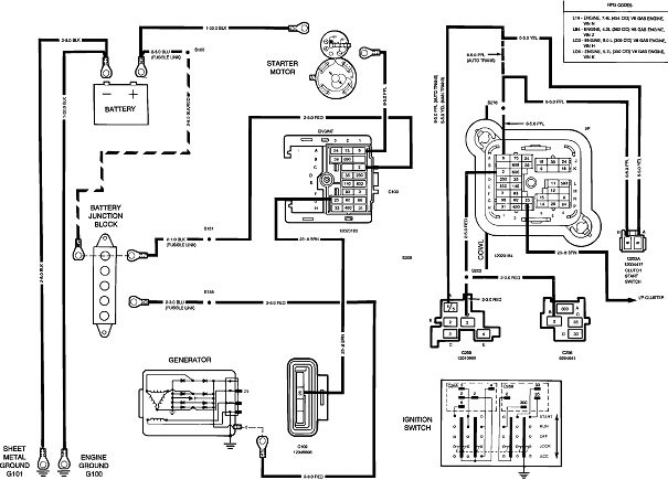

This sounds like a neutral safety switch problem, but it looks like there isn't one on your truck. Look under the dash where the clutch pedal would be and see if you can find the jumper harness for the clutch switch. Use those terminals as a test point. You should see 12 volts there when the ignition switch is in the "crank" position. If it's missing, the ignition switch becomes the best suspect.
Jan 25, 2020 at 7:59 AM
JORDANR
  • 18 POSTS
There is a park/neutral switch that attaches to the lower end of the steering column near the firewall. I actually purchased this thinking it was the issue previously. Though without being able to see the top of it due to location I wasn't sure how it came off the column. I find it odd how I can move the ignition to crank in park and neutral but no other gears. Which to my limited knowledge would indicate the switch is working, no? Unless it's one of the contacts in the switch. Just so I'm clear when you say ignition switch you mean where you put your key to start the vehicle? I'm sure that's what you meant but wanted to be certain. I actually thought it was that as well at one point but ruled it out because I changed it back in October when my key was to worn out to turn it. But you never know, maybe something is loose on it causing intermittent issues. Just seems real odd to me that when the truck sits for a while it starts with no issues until you shut it off again. Then it doesn't work. Thanks.
Jan 25, 2020 at 9:05 AM
CARADIODOC
  • 34,414 POSTS
I can't find the neutral safety switch on either the diagram I just posted, or the original manufacturer's diagram I posted at first. My preference would be to go right to the ignition switch and find the purple wire for the starter solenoid voltage, but that can be hard to get to. That's why I sent you to the jumper wire. That connector is there for the clutch switch on vehicles with manual transmissions. Since you have an automatic, they didn't build a different wiring harness. There is no clutch switch, so they just plugged in a jumper wire. That makes for a convenient test point.

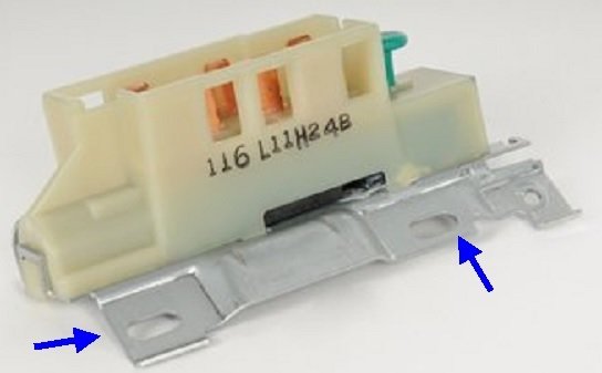

Your ignition switch is down on the side or top of the steering column, below the dash. It is mounted with two screws, and the mounting holes in the switch are elongated to allow for adjustment. It is not uncommon for that switch to work loose and shift out of adjustment. That would become evident by the 0 volts on the purple wire when the switch is in the "crank" position.
A second cause is burned or overheated terminals on the switch and its connector. There is no separate starter relay in this system. That also surprised me. That is fairly common on small import cars. It doesn't take as much current to run the starter solenoid, but on your truck, the solenoid could take as much as 20 amps. That's a lot to ask of the little switch contacts and of the connector terminals in that circuit. This would also show up as that missing 12 volts on the purple wire.
In other GM starter circuits, the neutral safety switch always came right after the ignition switch. From there current went to a starter relay. It was that relay that handled the 20 amps for the starter solenoid, so the two switches didn't have to handle that high current.
The issue remains, . . . we have to see how far the 12 volts is making it from the ignition switch to the solenoid. The voltage readings will tell us where the break is in the circuit. Find that jumper wire or find the purple wire on the neutral safety switch. Probe that wire with the test light and see if you have 12 volts in the "crank" position. If you don't, work your way back to the ignition switch and check there on the purple wire.

Thanks. So I couldn't find the purple wire that was like a jumper. I then decided to take off the steering wheel and check the ignition cylinder. When I had the 3-4 torx screws out and everything was loose the truck started fine. I shut it off and started no problem about 10 times. I started thinking maybe something worked loose so I slowly put it back together.
I put the top torx screw in first, truck started fine. I then put the second screw in just below the ignition cylinder. Wouldn't start.
So from what I can see is the cylinder rotates a series of gears to put current to the solenoid provided the shifter is in park. Because I still have the turn signal part on I can't slide the cover off the column to get a better look.
I started thinking about dropping the column so j could take off the shell that covers the parts and wires so I can get a better look at all the moving parts and find where the rotating of the gears and the moving parts go to an electric signal. My Haynes manual doesn't tell me how the cylinder with no contacts, and the moving arms and gears with no contacts, than sends that movement to an electrical signal. My Haynes book also doesn't tell me how to drop my column.
About mid way down the column there's a fairly large bracket. There's two bolts on each side that bolt to the column itself. Then that same bracket has two more bolts on each side that bolt to a metal piece above the column to hold it in place. My guess would be if I take out those 8 bolts the column should lower and hopefully giving me access to be able to take off the shroud to better see where everything is going.

I'm starting to feel pretty confident the ignition switch is out-of-adjustment, especially now that you've added these observations. It's on the side or top of the steering column, under the dash. The blue arrows are pointing to the slotted mounting holes. Loosen the two 5/16" bolts, then slide the switch up a little closer to the steering wheel.
