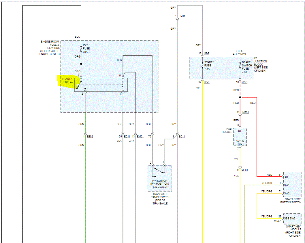

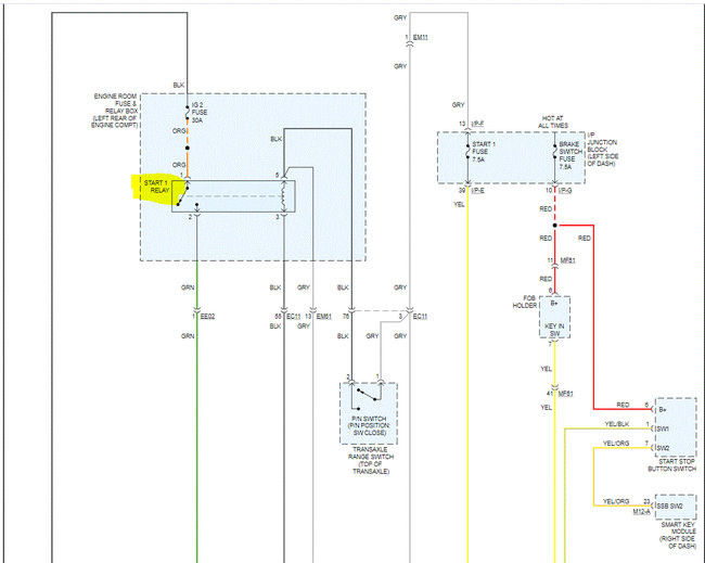

The brake switch isn't a likely cause unless you noticed the brake lights aren't working. I believe I understand what you are experiencing. In this case, the first thing I suggest is to check is the start 1 relay. It may be failing.
If you look below, I attached the wiring schematic for the starting system (smart key/push button). I highlighted the relay I'm referring to. It won't be a fuse or anything like that because it would never work if it was blown.

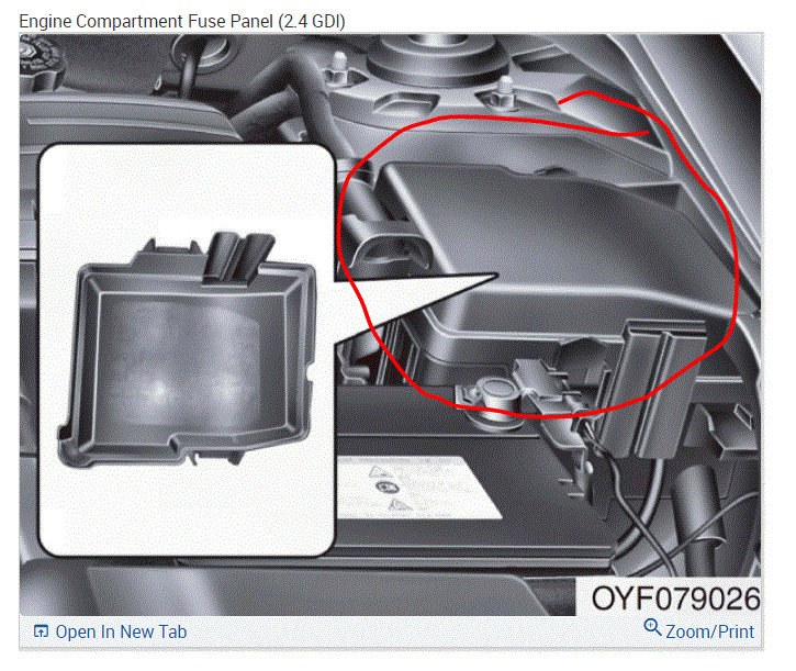

The relay is in the underhood fuse/relay box. If you look at pics 3 and 4 below, it shows the location and I highlighted the relay.
Try this: Switch that relay with a different one in the box having the same part number and see if the problem still occurs. Or, here is a link that shows how to test a relay. My concern is it doesn't happen all the time, so testing it may not provide an accurate result.

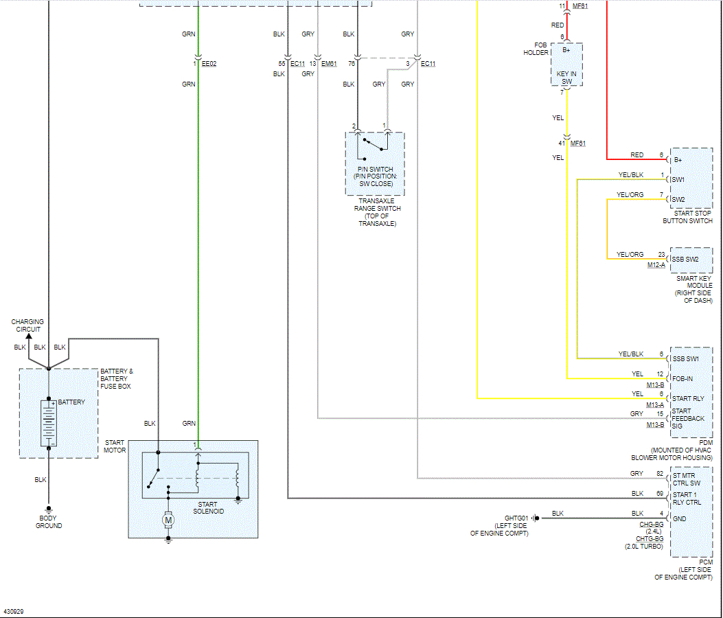

If this all checks good, you may simply have a faulty solenoid on the starter causing this. The idea that it clicks (bumps) indicates the circuit is complete. So, we are losing power at some point. My guess is either a bad connection, a faulty starter relay, or the solenoid on the starter itself.
