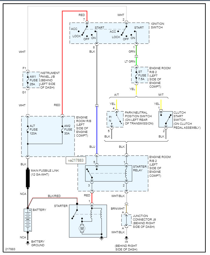

So car been setting for 2 years off and on. Alternator started the problem replaced it about a 2 years ago while replacing that pulley tension bolt stopped so parked the car about 8 months later Strong armed belt on car started right up. Drove around town for a few months no issues so decided drive it to work 30 miles away go to start cast won’t start had to jump off so figured replace the battery New battery killed the entire car no start no radio no nothing just dummy lights flash so check fuses replace all of them to be safe still nothing replace starter still nothing no noise no clicking not even trying to turn over towed home and here we are today with time to google and revisit. Bypass starter relay by using a wire in relay 30&87 car starts after few figuring it out attempts. Idols 30 mins put relay in car dies instantly. So is it my relay or not bought universal relay didn’t work can’t find car relay without manufacturers help please

I am not sure why the engine shuts off when you install the relay again, but I suspect this is related to the ignition switch.
So, when you remove the relay and jump the terminals, I assume you are turning the ignition switch to the on position which causes it to start running?
So, the way we need to test this because it is likely not the relay is to remove the relay and check power at each terminal of 1 and 5. Then we need to check the ground on terminal 2.
The confusing thing at this point is why when the relay is installed after the vehicle is started, why it stalls the vehicle because once the engine is started the relay should be disengaged. Otherwise, it will keep the starter engaged.
Let's start with this and go from there.

I am sorry. Unfortunately, there is no way to know people's comfort level with this stuff, so we just provide the details and then answer any questions. However, I totally understand that the most likely causes are the ignition switch and the park neutral switch.
However, getting these voltage readings would help confirm this because I am not sure why this is causing a stall when it is reinstalled. That could just be a normal thing as I am not sure I ever tried to remove one and see what happens after I reinstall it.
Please understand that based on these facts, I suspect the ignition and park switch make the most sense.
Let me know if you have questions on this and we can go from there. Thanks

I am going to try the ignition switch because I have no power to accessories.
