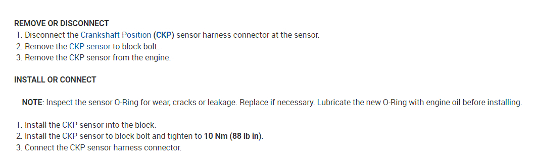

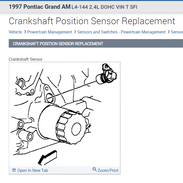

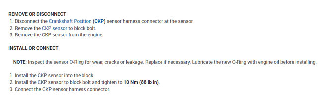

My car listed above GT starts and runs fine, but after a short trip, it won't restart. It acts like it's out of gas but after a while, it will start fine again. But when you shut it off, the process repeats itself. I was thinking fuel pump, but this makes no sense.
Apr 18, 2021 at 11:26 AM
  • 110,248 POSTS
The idea that it starts again after it sits leads me to believe it is related to the crankshaft position sensor. When they start to go bad, heat has an adverse effect on them.
First, take a look through this link and let me know if it seems to mirror what you experience:
What will happen is if the sensor is bad, you will lose spark to the spark plugs and it won't run. If you want, check for spark when it will not start. Here is a link that shows how that is done:
If there is no spark, the sensor is my first suspect. If you determine it is bad, here is a link that shows in general how one is replaced:
If you look at the two pics below, they are the directions specific to your vehicle for replacement. The sensor will be located next to the oil filter.
