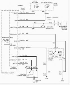

Engine fires for 3 to 10 seconds, checked all fuses, switches, relays & fuel pressure. Believe it may have to do with factory anti theft. Fault code says anti theft crank problem. This is the only code. Need info on how to disable alarm or wiring diagream for alarm. Car also has factory remote start

Hi, thanks for the donation. I found this wiring diagram for passlock. Don't know if diagram is readable. If I enlarge, I have to posts to or three different pictures, if you need it? Another thought, if it refuses to start and the security lite is on or flashing, don't turn the key off, leave it on, see if the security lite will go out, then try to start, may take10 minutes or so for the lite to go out.
