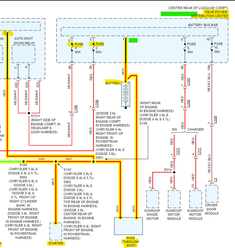

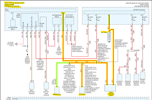

I’ve had some charging problems with this car in the past. One evening I turned my card off to save gas few minutes later I turn it on battery light came on, went to o Reilly tested my battery had it replaced, battery light was still on, had my alternator checked said bad alternator (mind you my car still started) found a guy to help put an alternator on but before he started taking the old one off he disconnected the positive cable from my fuse box underneath my hood ( don’t know why) then he began to take off my old alternator as he was doing that once he started taking of the positive cable at the back of the alternator there were a few sparks flying (mind you my car started before) after we got the new alternator put on, my car started but immediately shut itself off it felt equivalent to running out of gas, then all my warning lights came on then it went dark on my dash so I turned the car off. But all my regular dash lights come on when I unlock and lock my car, but it just won’t start now, I mean I do have a bad starter, but it would always start right up. Can anyone help me figure out what’s wrong?

Hello, that is absolutely the incorrect way to disconnect a power source on a vehicle, I agree with you, I have no idea why he would not unhook the negative first and leave it unhooked. Then disconnect the Alternator positive post. Have you done through all the fuses in the vehicle? Did he leave both positive and negative cables hooked up to the battery while replacing the Alternator? I will look up the wiring diagrams for your vehicle and see which circuits could have been affected. But I wouldn't go to him again, and really if there is damage to any modules, he is responsible.
I remember this vehicle's charging issues from last month.

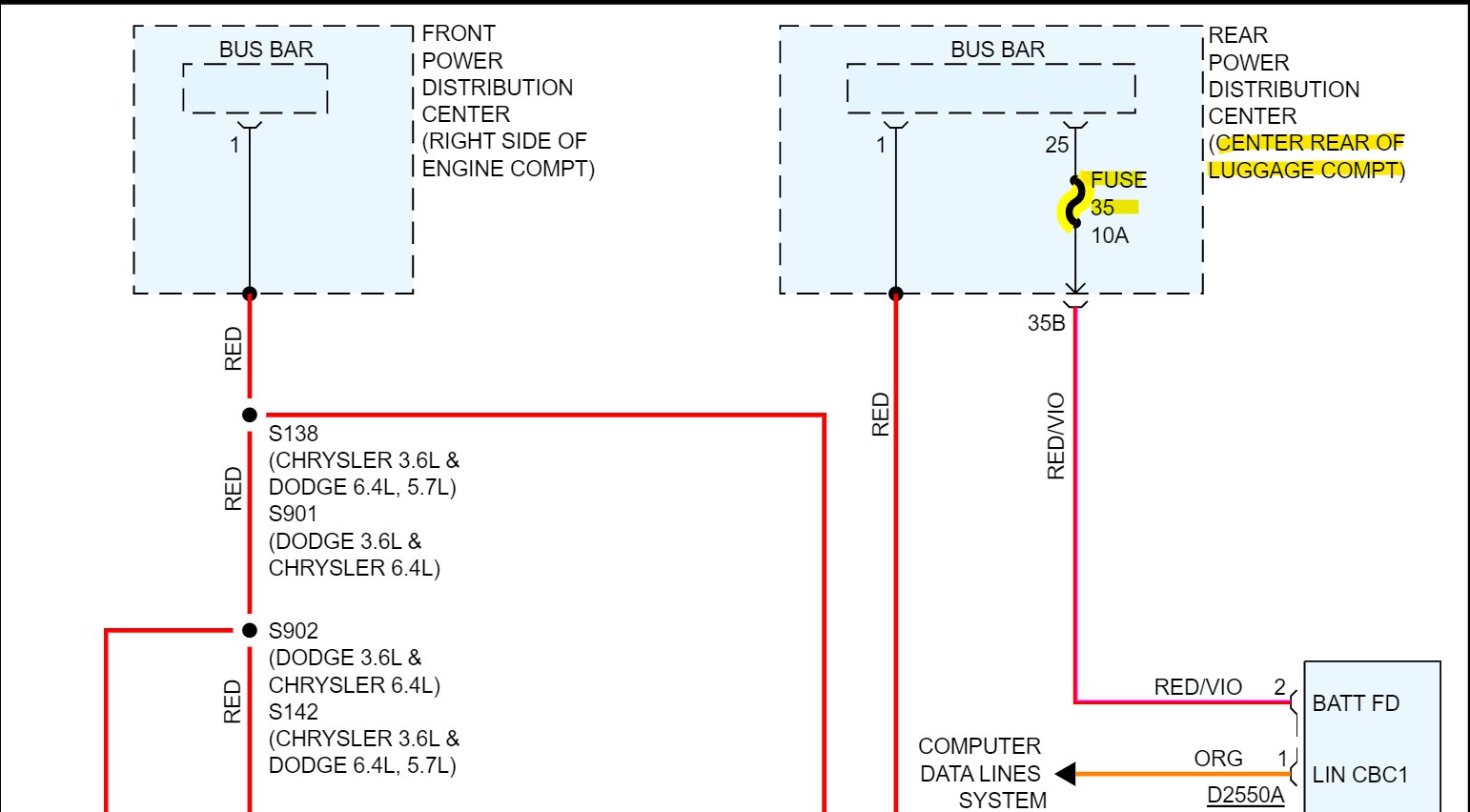

There is a fuse (Fuse 35 10amp) in the rear fuse panel that goes to the Intelligent Battery Sensor (current sensor) which communicates on a Lin Bus network to other modules. These sensors are extremely fragile. And most of them have a bolt on them that is a onetime use, but doesn't need to be disconnected because it's not the hold down bolt for the battery post,
But if you saw sparks flying while this guy was changing the Alternator, that's not good. Now you have starting issues. Does the Check Engine Light come on if you turn the key to just the on (run) position? engine not running.

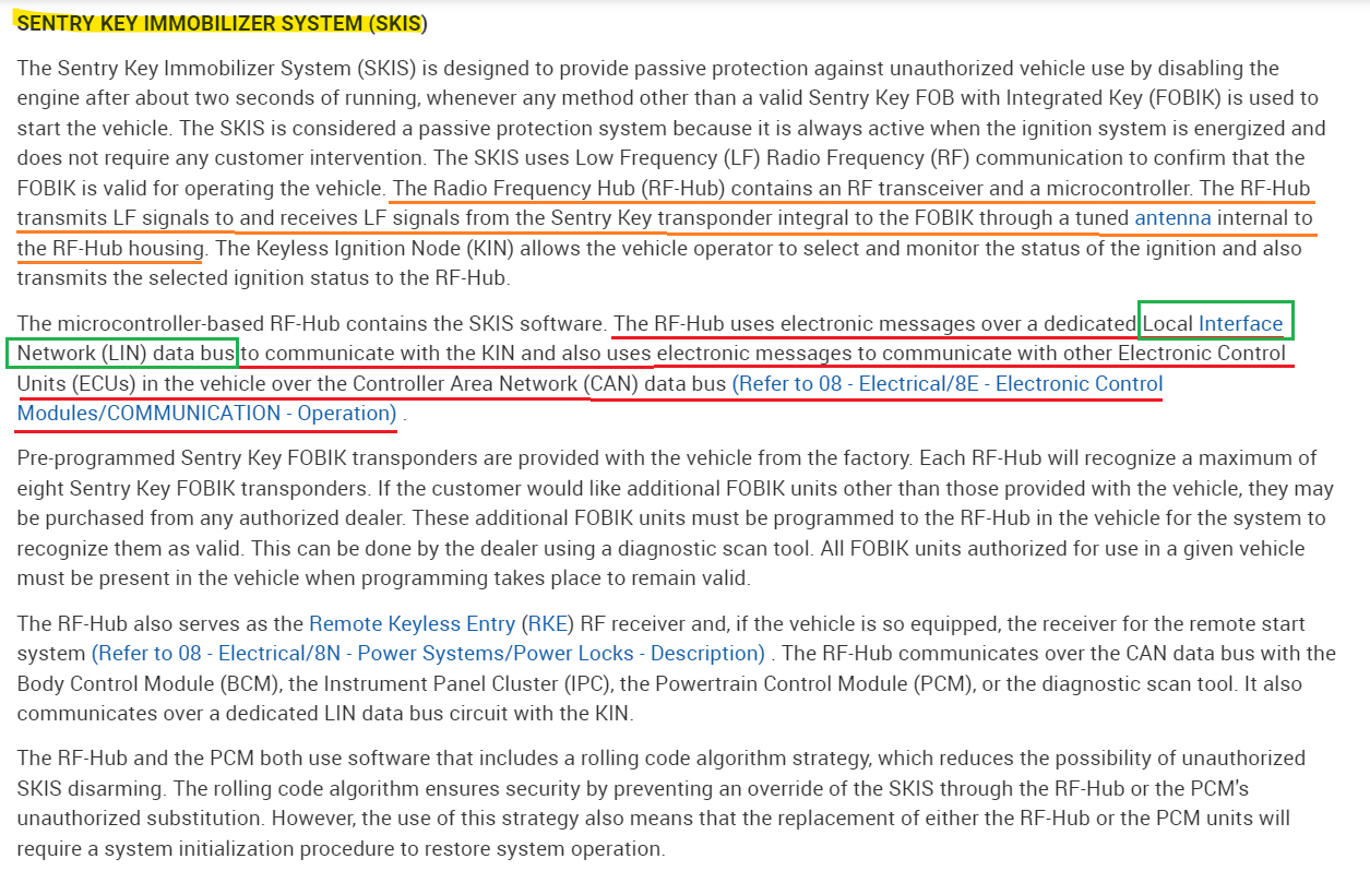

It sounds like something is going on with the security system. A start and then 2 second stall might be the security system not allowing access.

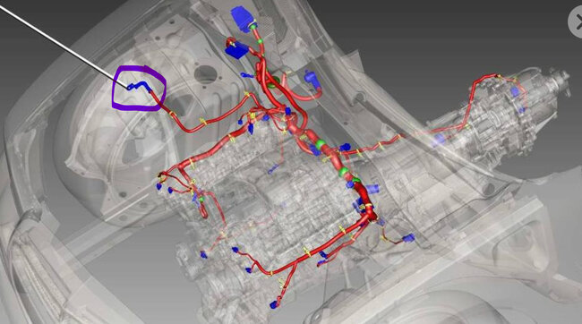

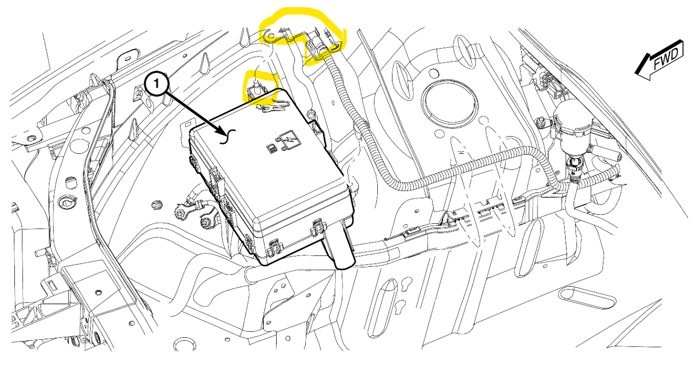

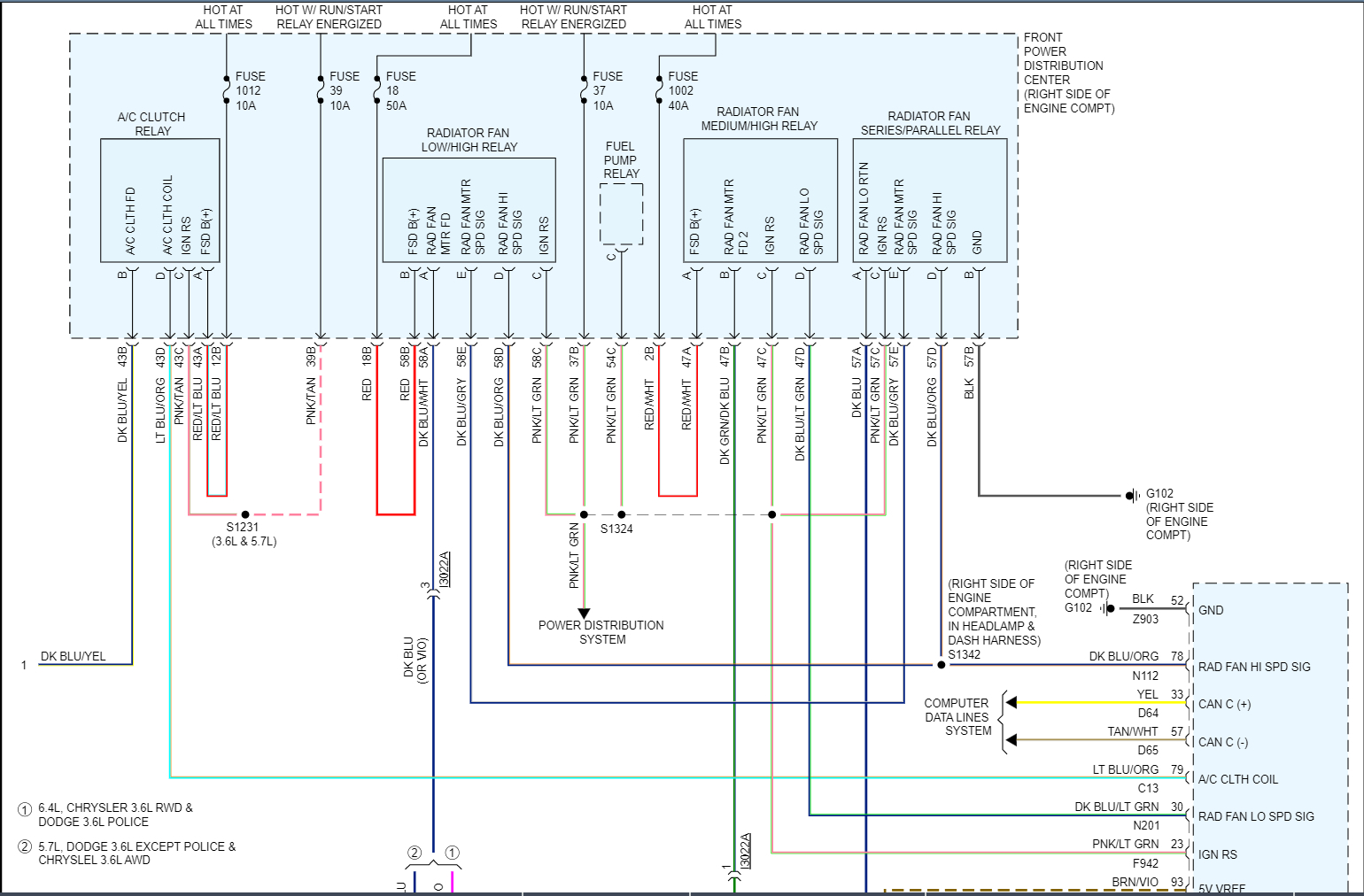

Which connector did he unplug from the fuse panel? Was it just a main thick battery cable bolted on, or was it a plug in connector type?

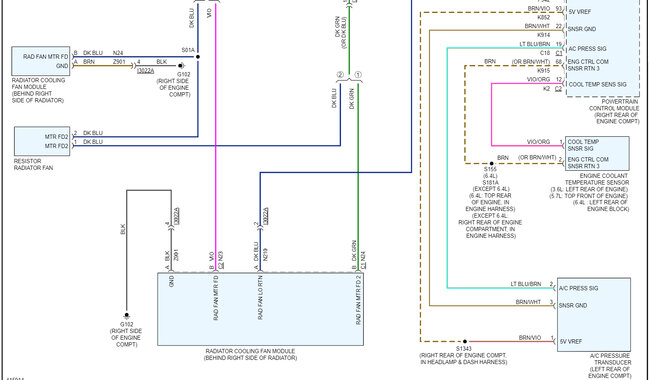

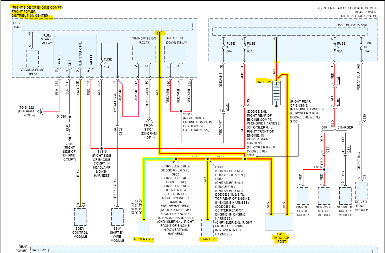

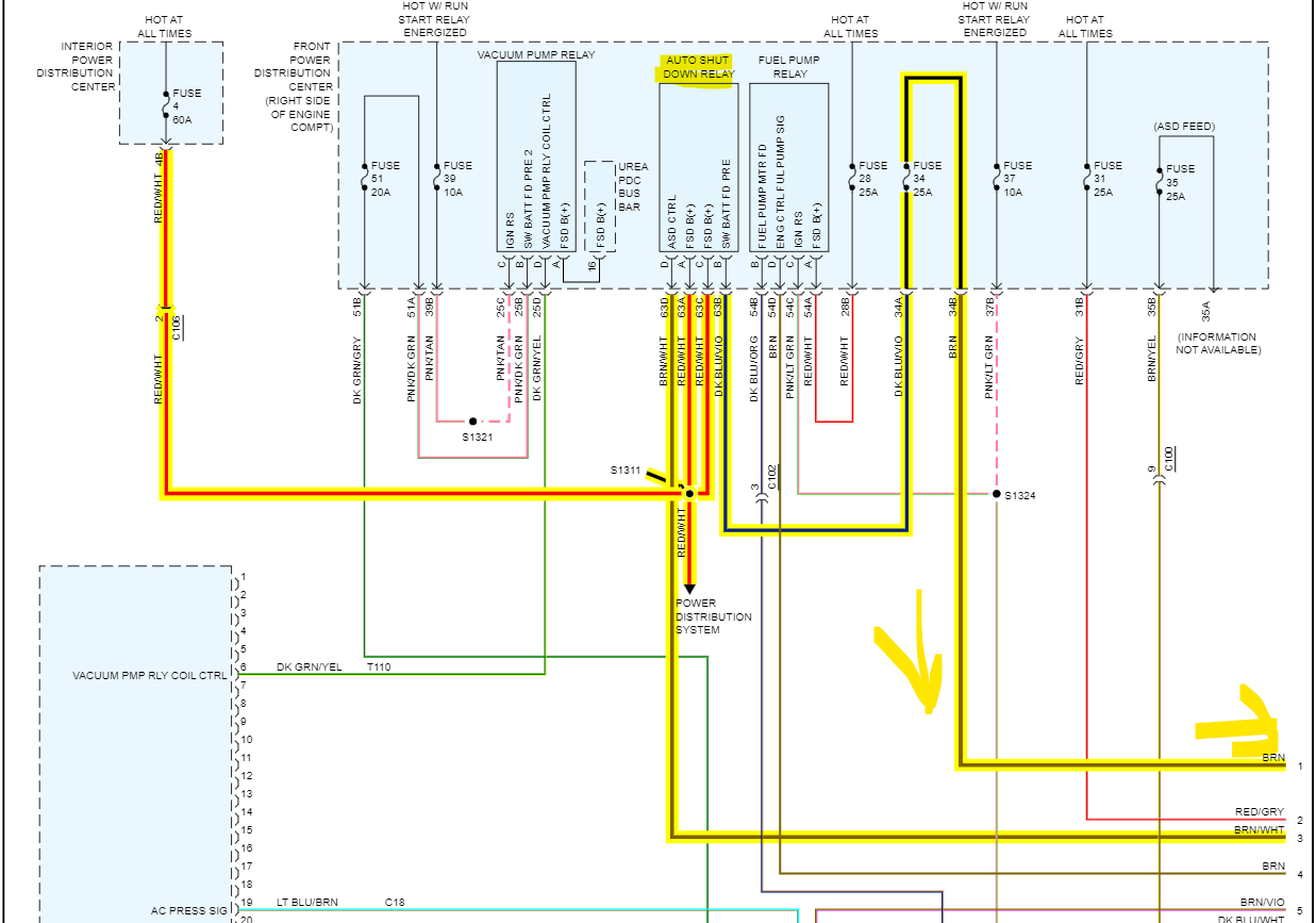

Was this the cable circled in the 2nd diagram?

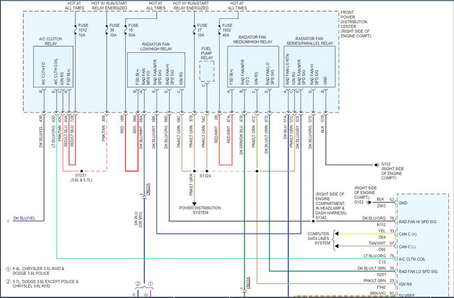

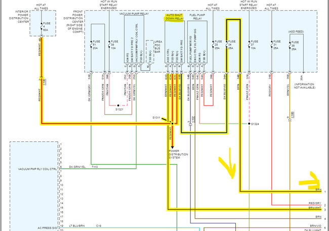

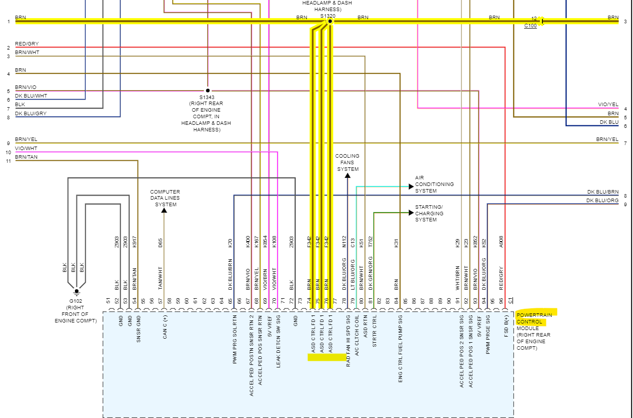

Ok I found the Front Power Distribution panel with the main Battery positive cable running to it. The only issue here is that this is not the only place this positive cable is hooked up to, you'll notice on the 4th wiring diagram that positive battery cable runs to the rear power bus bar as well. So, he shorted out the main battery cable, not knowing it runs to another power distribution center in the rear of the vehicle. So, we need to figure out what is shutting down the PCM.
The 5th diagram is the Security System operation and I'm thinking about that Battery current sensor, and if it is possibly damaged due to the electrical arcing. The battery current sensor communicates on a Lin Bus network which is also the network that the Keyless Ignition system node communicates on to other important modules, BCM, PCM, IPC, and if the battery sensor happens to be pulling that network down, essentially shorting it to Ground because it's on the negative battery post. It would prevent a lot of things from functioning properly. This is just a hypothesis, since I'm not at the vehicle. But seeing if the vehicle is losing its Fuel Injector pulse after start up, would point to an issue like that. With the PCM shutting down the injectors.

Do they know about the power distribution center in the rear of the vehicle? Because with the front one unbolted like the mechanic did, the other power supply was still hooked up in the rear. They need to verify the power back there. Because those fuses feed the ASD Relay, and the Auto ShutDown Relay powers a section of the PCM, the fuel injectors, they might not have even looked in the rear of the vehicle yet, it's not a normal place for a fuse panel.

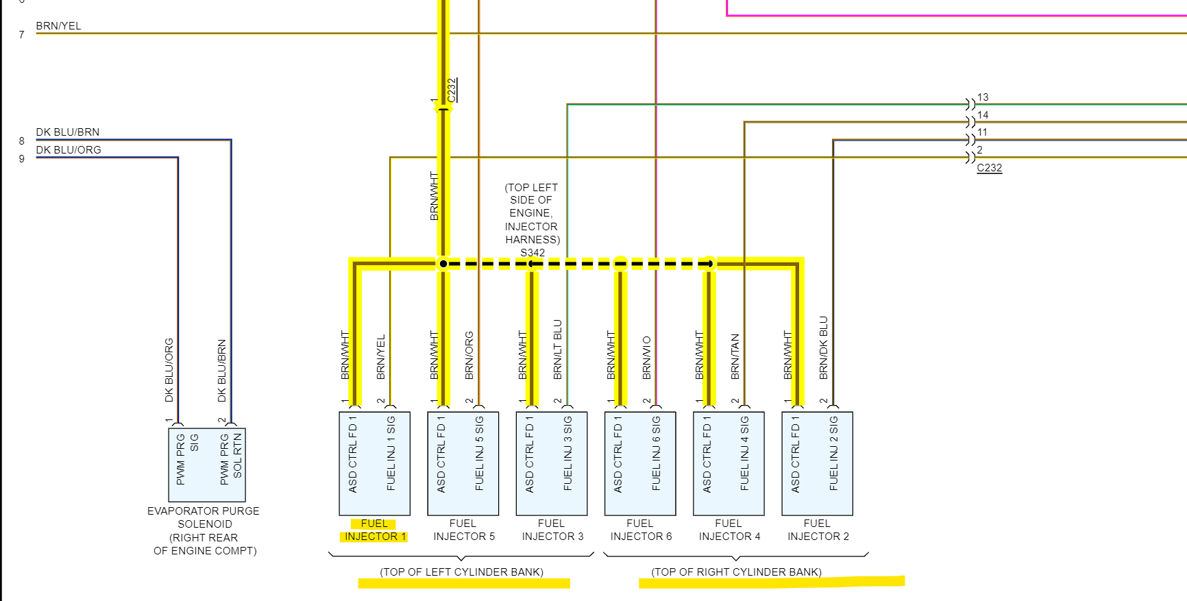

Ask them if they have power to the Fuel Injectors when the stall out occurs, or if they are losing Fuel Injector control at that time too.
It's still doing the start for 2 seconds then stall out, correct.

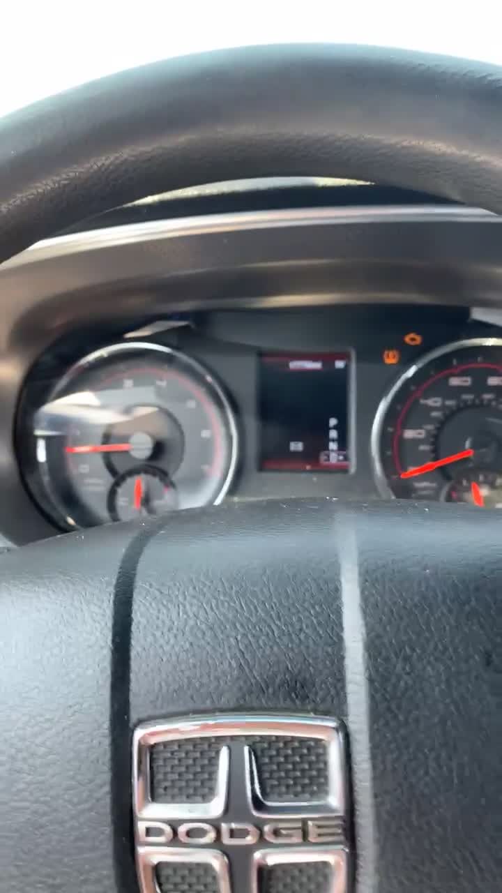

That engine almost sounds like it doesn't have any compression. Can you open the hood and do that again? Did the Napa place check for Ignition spark or fuel injector pulse? What testing did they do? And I'm not sure, but do you see any Check Engine light while cranking?
Also, I do not see the Tachometer moving while cranking.

And this is how my dash looks and I’m not sure what tests they’ve ran they keep saying they haven’t found anything yet but believe it is a connection issue.

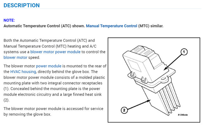

Someone suggested blower motor resistor relay.
May 18, 2023 at 12:46 AM
AL514
  • 5,692 POSTS

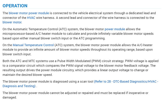

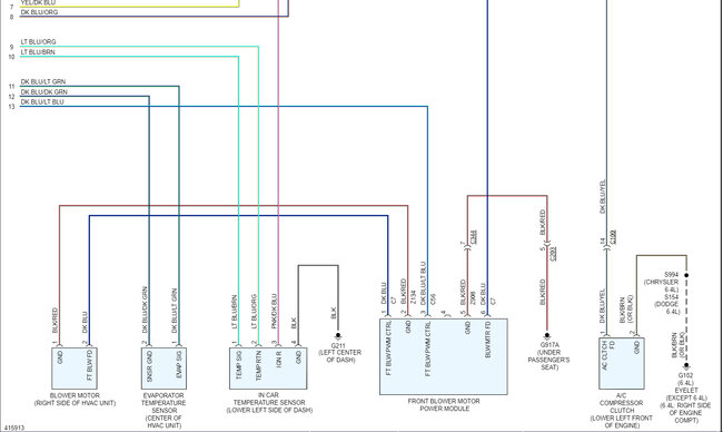

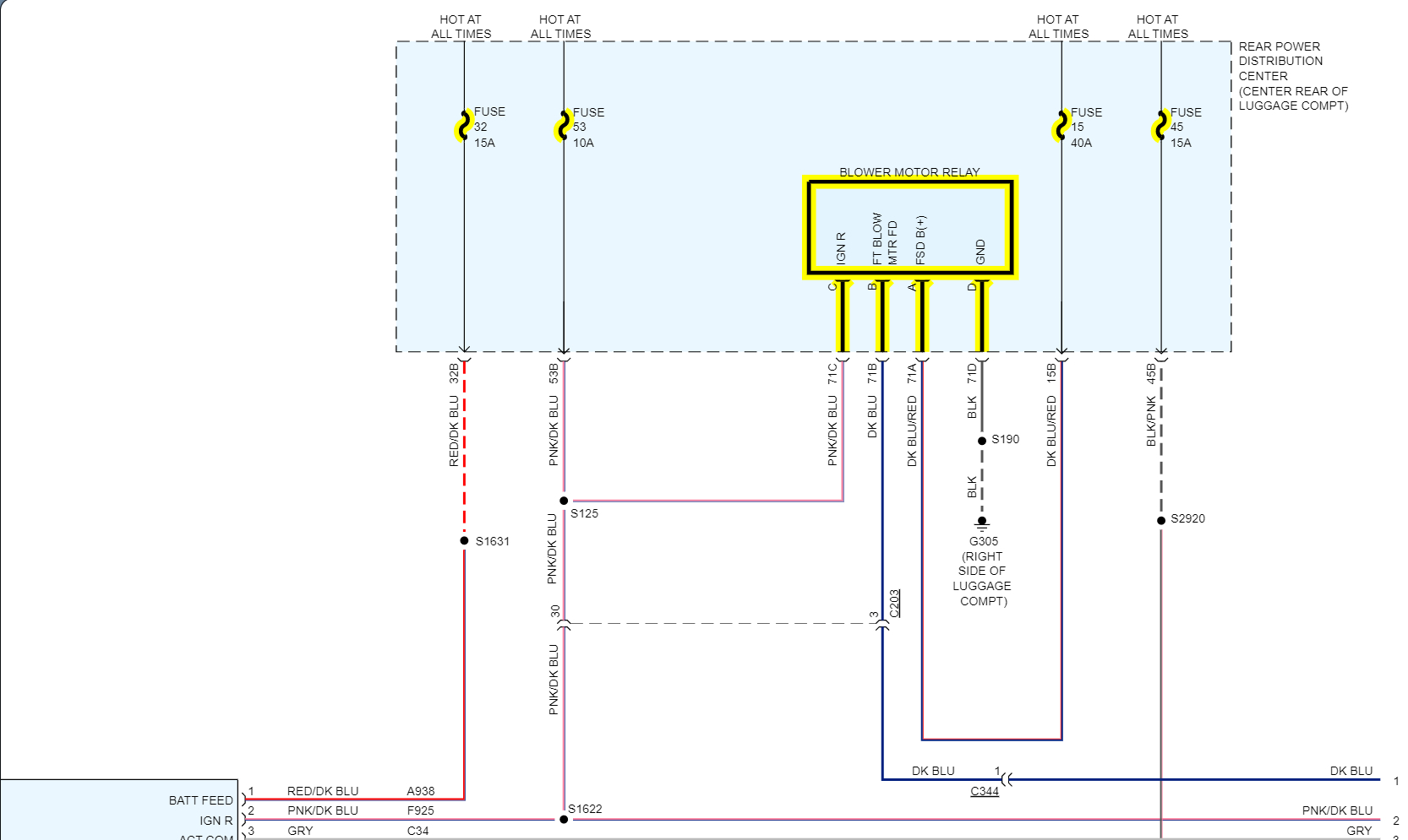

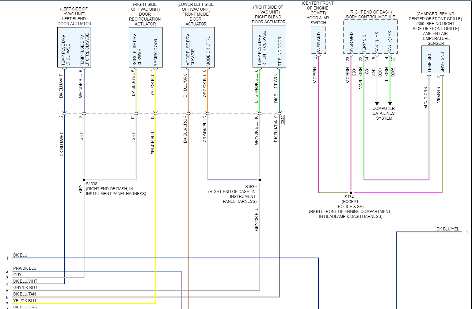

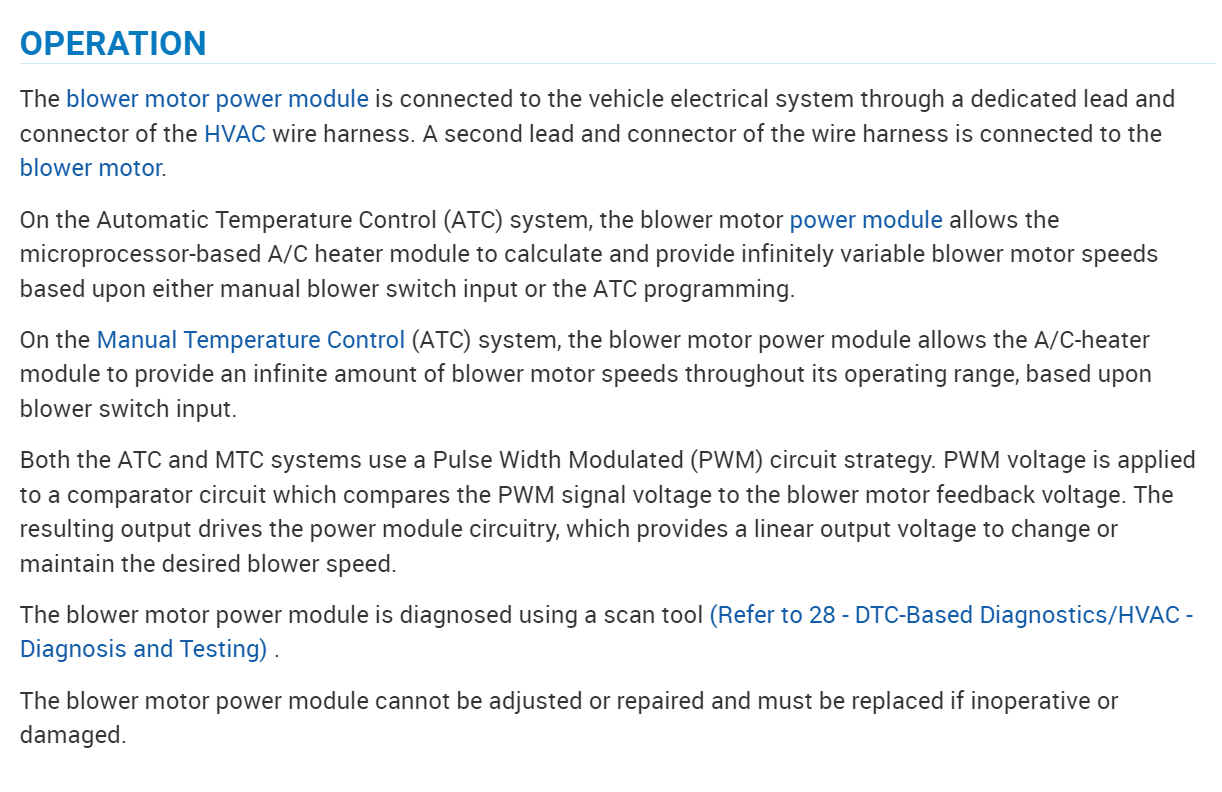

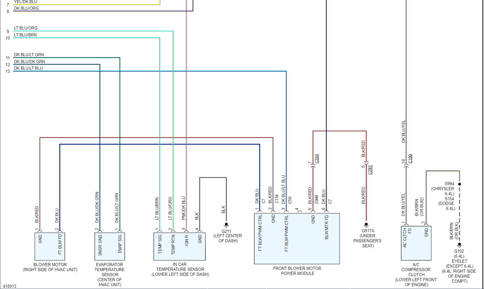

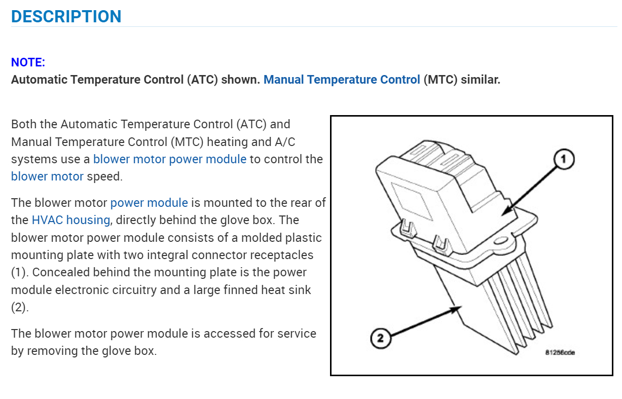

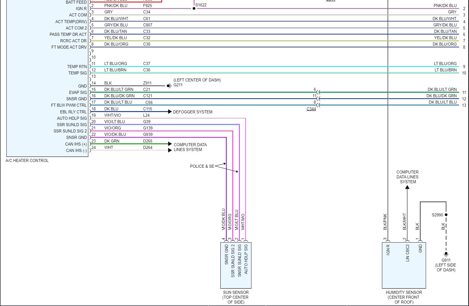

Do you mean the A/C compressor comes on? I would check for power at the blower motor before replacing anything. This vehicle has a Blower motor power module, and there are 2 wires that run to the blower from the power module, the power module is not a resistor, and doesn't function like the older conventional blower motor resistors, It is a pulse width modulated controller, meaning it pulses the power to the blower to control it for different speeds, so depending on the duty cycle, that will determine the speed. With it not working there is probably a code stored in the HVAC control module that will lead you to the issue, instead of just replacing parts, if there's a shorted circuit somewhere and you replace the blower power module it might fry the new module and not fix the real issue. Because of how all this started I would be cautious about shorted circuits and/or more burned fuses. There are also input sensors to the HVAC control module that might prevent it from operating correctly. There is an in-car temp sensor, humidity sensor, sun sensor ambient temp sensor, evap temperature sensor, etc. So, scanning the heater controls would help, there should be codes set. Really doing a full system scan would be a good idea to see if any other modules are setting codes.
Diagrams 3,4 and 5,6 and 7,8 are the HVAC system, you can see how complicated it is
The blower motor power module is 137 dollars alone, so it's not something you want to guess with.

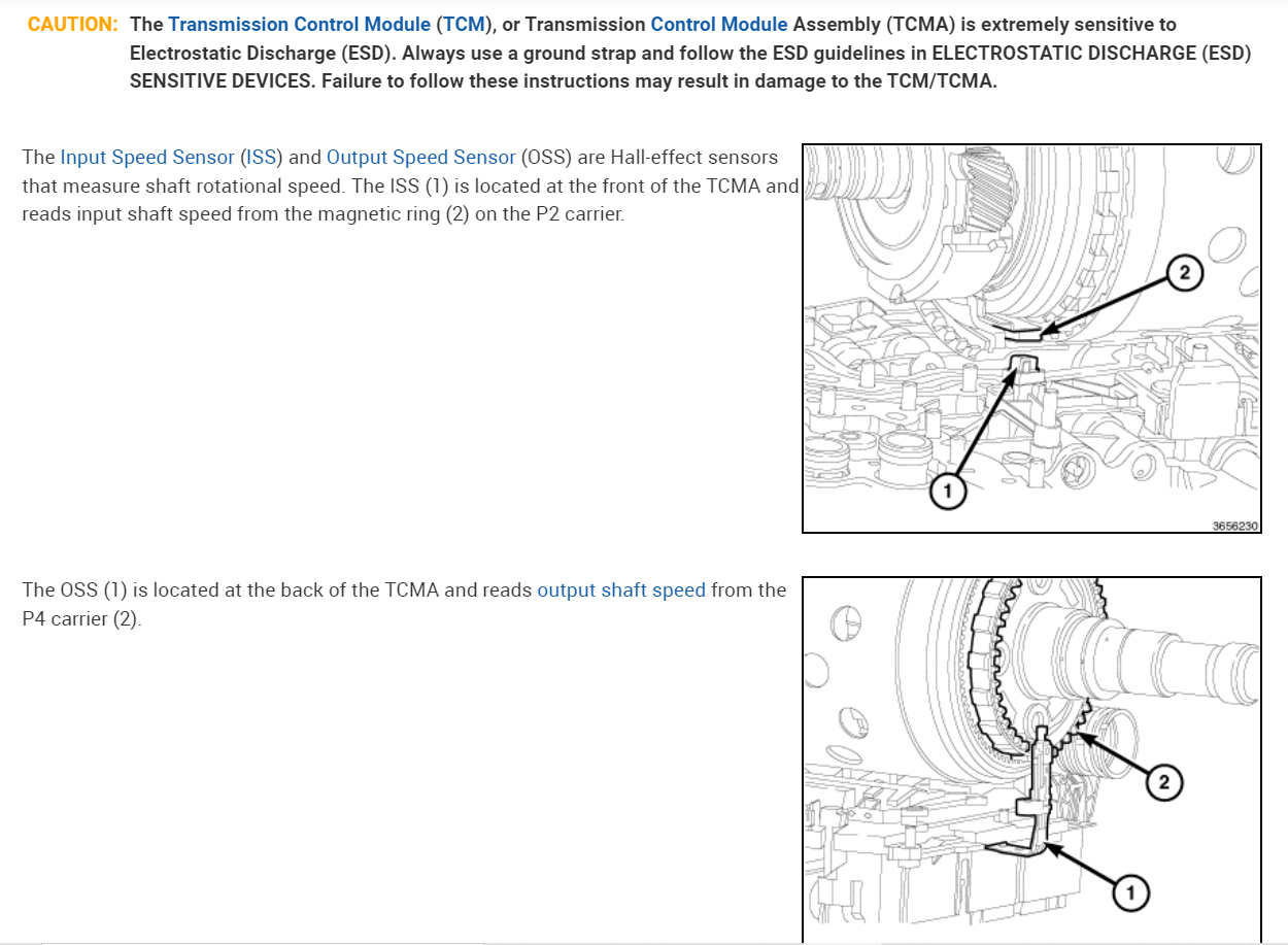

I believe I got it figured out, but I’ve been having trouble with my car switching gears my 3 gear will get stuck and a certain RPM sometimes I have to change it manually, but I just left the shop my good friend put it on his machine, and it said something about a speed sensor. any idea on that?

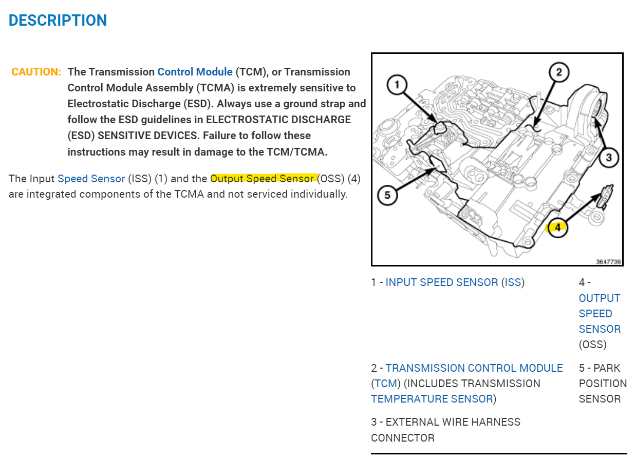

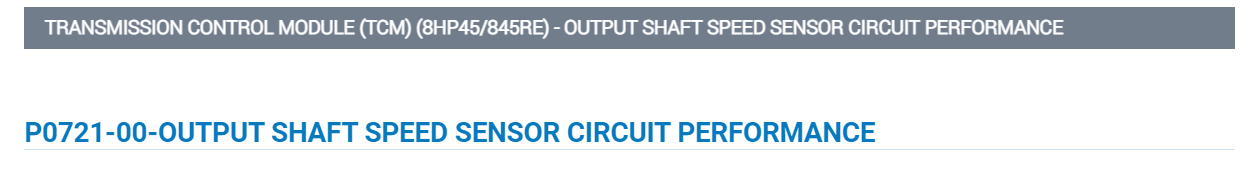

What was the issue with the HVAC system? The output speed sensor reads the output shaft speed, and there is a warning on the TCM (transmission control module) being extremely sensitive to electrostatic discharge, which is exactly what happened when the Alternator was changed without disconnecting the electrical connectors. That incident caused a lot of problems, the speed sensors are hall effect sensors, so they are susceptible to voltage spikes.

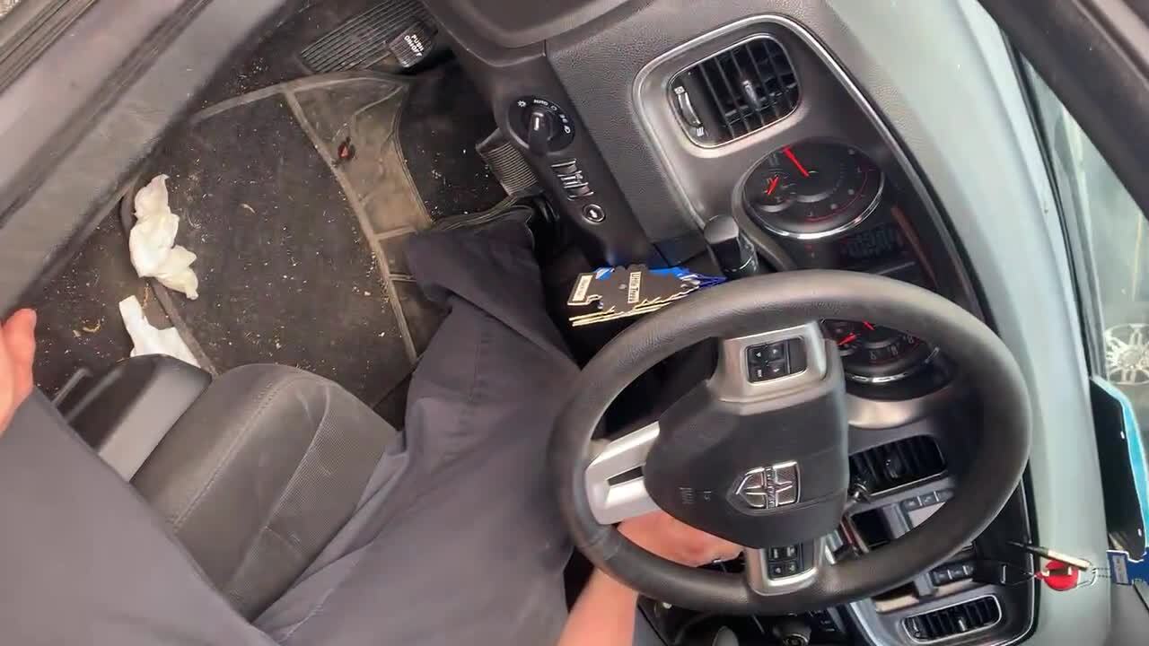

No don't just change parts, if your friend has a scan tool, have him monitor the speed sensors while driving to see if they are outputting the correct data. Do a full system scan, every module for codes.

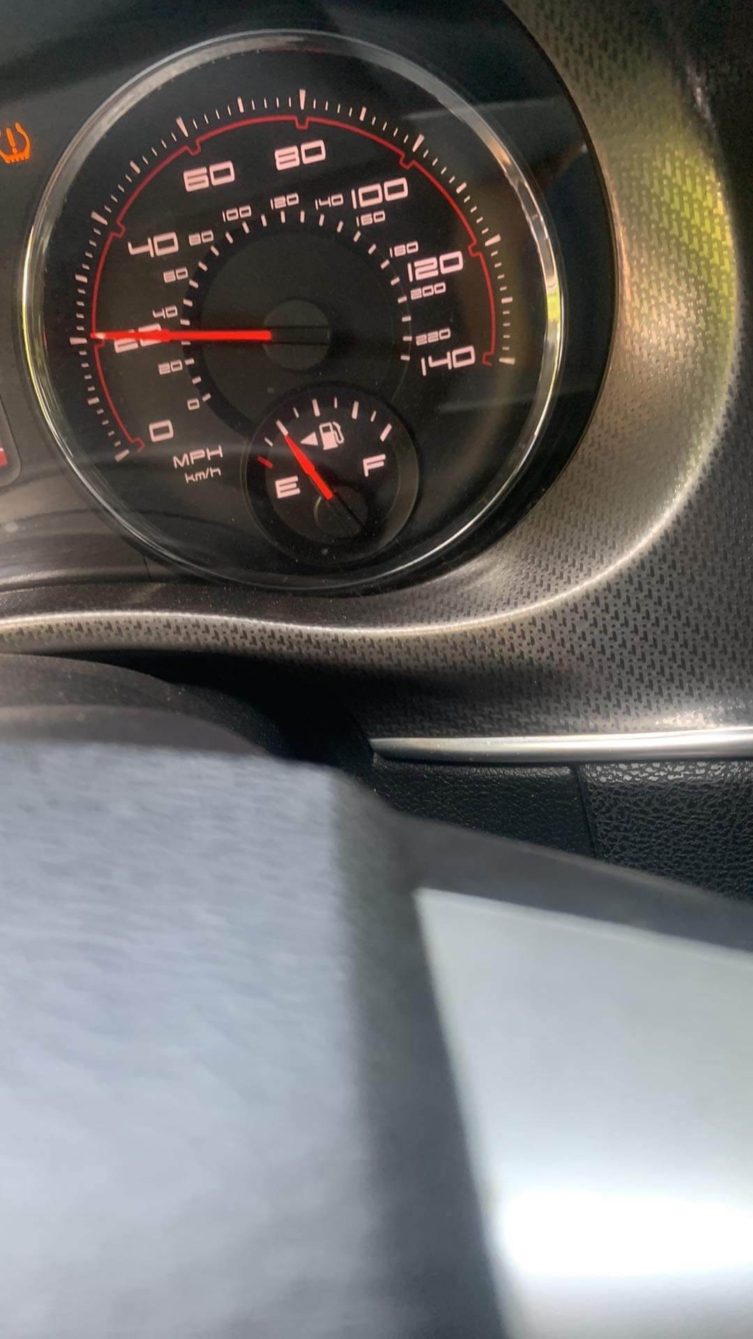

Here’s what it’s doing you can hear the noise as I’m taking off and the stress it only happens like this when gas is below half.

I can see the Check engine light is on, what codes are stored in the ECM? I can't hear anything in the video, I would need to be in the car to hear it, but the ECM is setting a code, I'm sure that will give you direction, write down the code number, and I'll look up the criteria for you.
Just stop by AutoZone or another parts store and they will scan the car for free, just get the code number, don't let them sell you any parts yet.

My car is stuck in limp mode and got off the phone with a guy in a transmission shop. He said my conductor plate that’s why my speed sensor isn’t responding. But nobody works on transmissions anymore, but I have lost some transmission fluid, but he said the cost and labor of that plus new fluid is about $1,000 but most shops are recommending me to Dodge.
May 22, 2023 at 1:16 AM
AL514
  • 5,692 POSTS
Conductor plate? Thats a new one. What codes are set in the PCM? Are you getting an "Output Shaft Speed sensor", Input shaft speed sensor, wheel speed sensor, vehicle speed sensor, code? I don't see how a transmission guy can tell you what's wrong without even scanning or looking at the vehicle. There is more than one speed sensor in the vehicle, service info states your vehicle gets its vehicle speed reading through the BCM on the CANbus network from either the PCM, ABS/ESP module. So, it depends on what actual code is being set to diagnose the system. Limp mode is a safety mode.

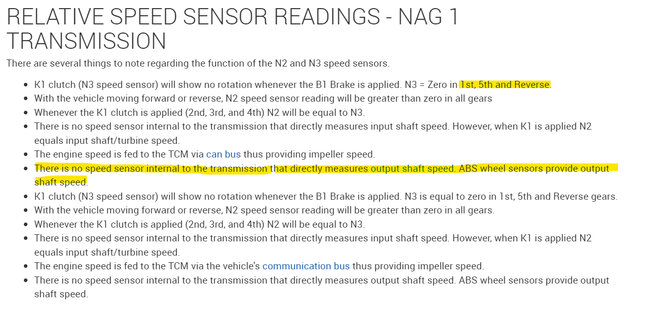

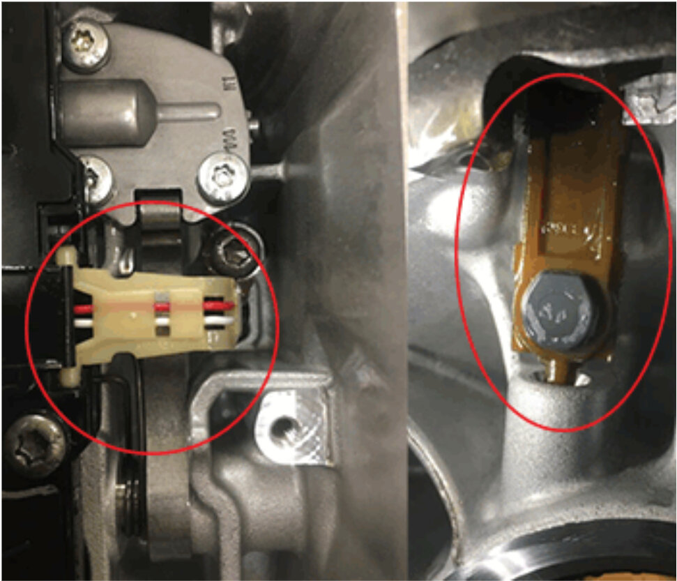

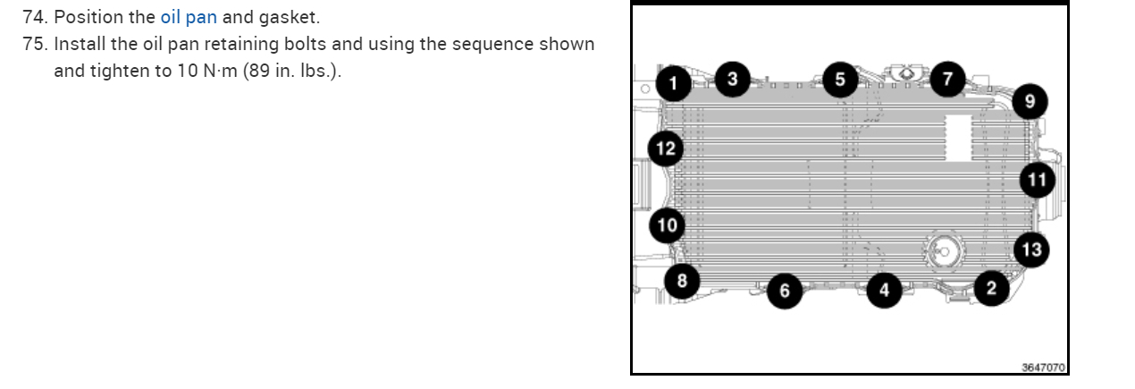

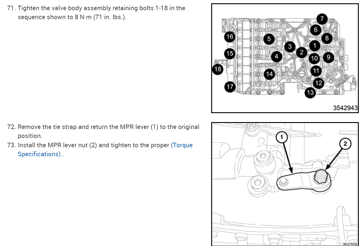

Is it the 8HP45, 845RE or the NAG1? The first two Automatic Transmissions have 8 gears plus Reverse, the NAG1 has 5 plus Reverse. There are quite a few different setups with each transmission as well. There's a lot of information here, do you know if it's the 5 gear or 8?

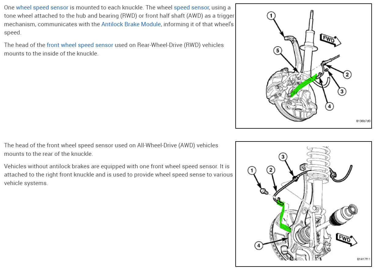

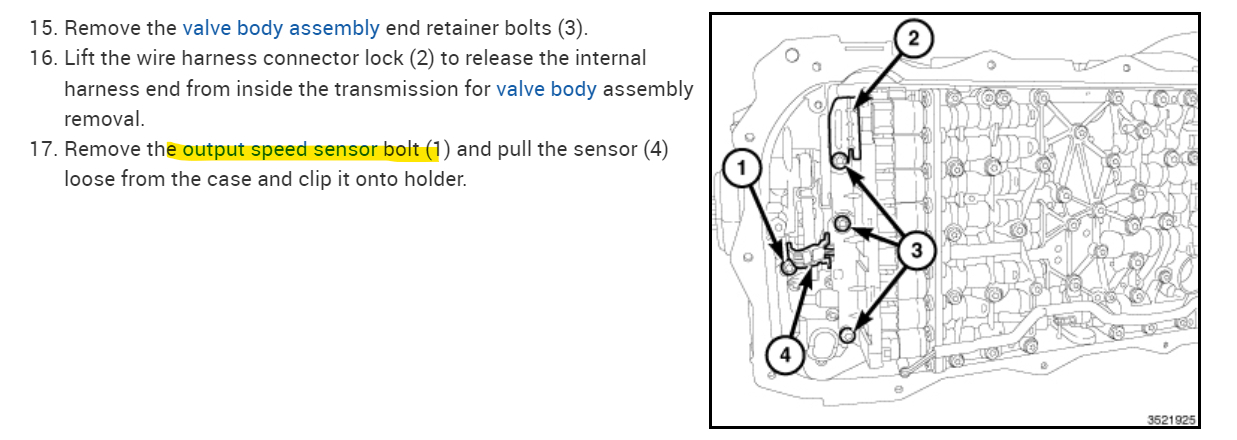

Is there one bulk connector on the transmission? Maybe we can check the harness for any issues, On the 8-speed transmission the Output shaft speed sensor looks to be bolted into the valve body, all information transmitted to the transmission and back to the TCM is done mostly by a CANbus network. We can verify the Transmission Relay and fuse that power up the TCM, but this still depends on which transmission we're dealing with. The 5 speed has a smaller connector

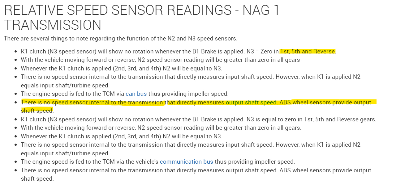

With the NAG1 Tranny it states that there is no speed sensor internal to the transmission that directly measures output shaft speed, the ABS wheel sensors provide the output shaft speed.
So, did that code come from the ABS/EBCM module or was it from the TCM?
Is it possible we're dealing with a bad wheel speed sensor?
This is the OSS for the 8 speed transmission, it appears to be under the valve body, but its not clear if the sensor can be replaced without removing the valve body.

It’s a 5-speed transmission, so it may just be the ABS wheel speed sensor.

Okay, this is a really complex transmission. If there is a speed sensor fault, the code should also be stored in the ABS module, if it is, that at least will give us some direction here. For a 2wd, there are wheel speed sensors for each tire, one in each hub, sometimes the trigger wheel for the sensor is built into the wheel bearing. You can start by checking that the wiring to each sensor is not damaged. Service info doesn't say what type of sensors these are, there are some different codes for them though, and a flow chart for testing, but it would help if there was a code for a specific wheel. There is most likely some reference current or voltage monitored for it to be able to set these different circuit faults.
Is the ABS light on? Because it looks like the only other output shaft speed sensor is for the other transmission type. We really need more information on the code that was set. Without it, it's just assuming. If you can get the code number from your friend, we can then see what the code setting criteria is for it.
