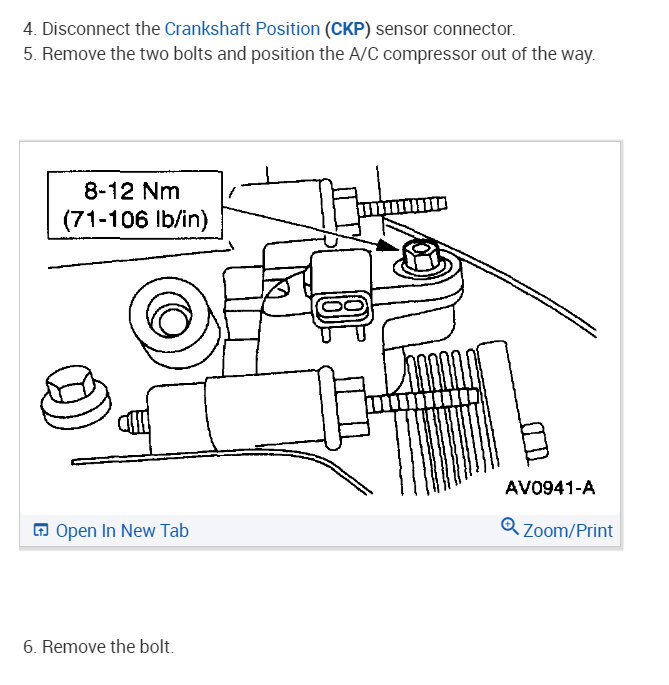

I got off work, mind you I drove to work hours before. When i got in all the lights and automatic seat adjustments worked. But when I went to start the car, it didn't start. It turns over and cranks. Had someone called out there to attempt a jump start and nothing worked. My possible diagnosis is a bad fuel pump or relay, bad gas. Or a spark issue. When attempting to start you can slightly smell gas in the engine bay. Any help is much appreciated. I have a 7-hour trip to make in less than 2 weeks.

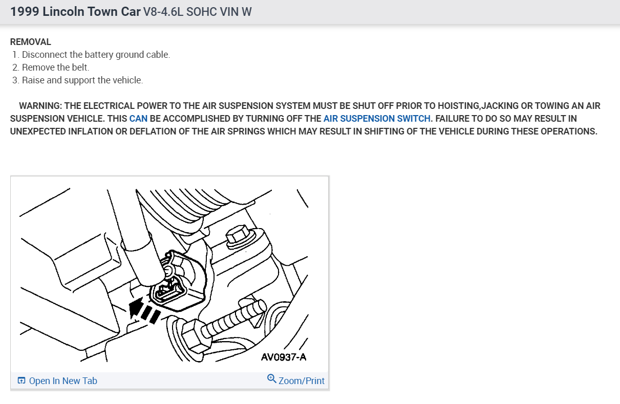

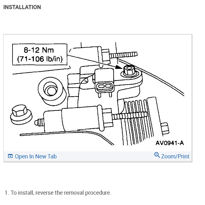

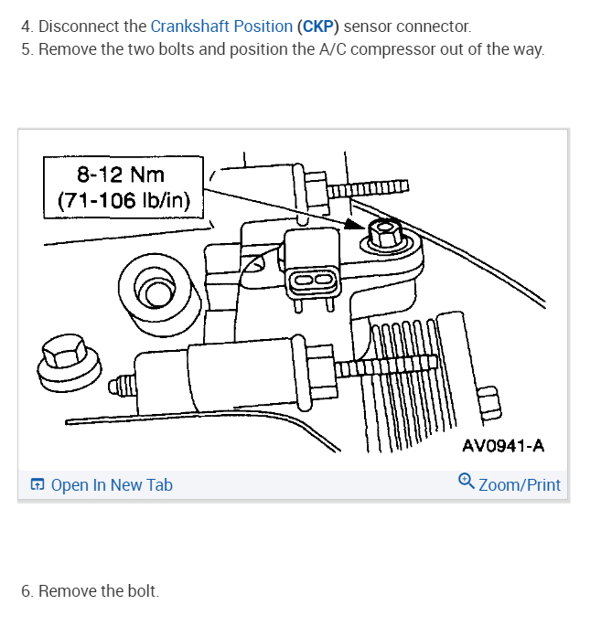

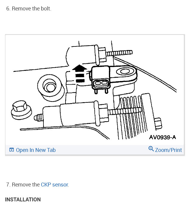

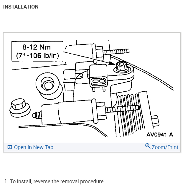

It sounds like the engine has no spark, I would check out this video and confirm and change out the crankshaft angle sensor.
https://youtu.be/baq_aEWNQ0Y?si=sDe-4Bi-jfUSkoPg
Here is the location of the crankshaft angle sensor. Check out the images (below). Please let us know what happens.
