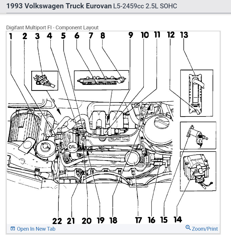

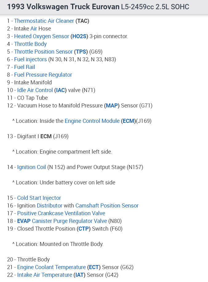

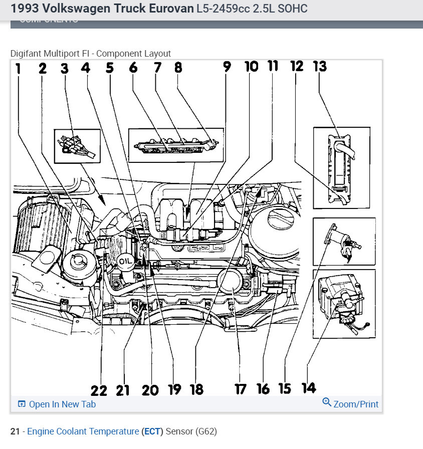

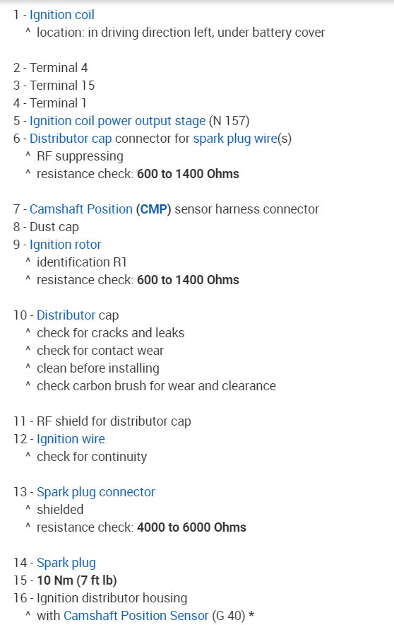

FYI, per my wiring diagram: There is a sensor (Camshaft Position, {CMP} Sensor) which provides input to/from/to the ECM and the Ignition Coil Power Output Stage that provides power to the Ignition Coil. (The Ignition Coil Power Output Stage "I think" is the base of the coil assembly, which I believe is where the failure is in the coils) The CMP also has input to the Distributor Rotor.
Dec 26, 2018 at 7:38 PM
  • 55,412 POSTS

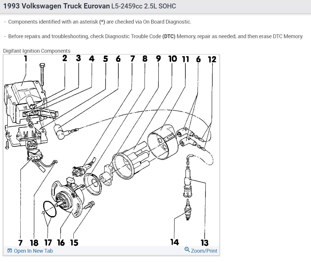

Yes, it sounds like the hall effect sensor inside the distributor is going out which they had trouble with. here is the location of the sensor and how the ignition system works on this car below.

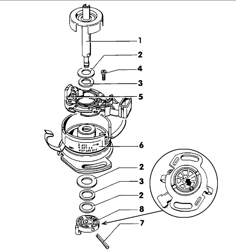

I'm not sure that the compatibility chart correctly identified this part to my vehicle. It would put this pickup at 180 degrees out of rotation for a five cylinder engine. I can see, that if you have an "even number" of cylinders that the way the distributor cam is designed that could work. But with an odd number of cylinders that doesn't seem possible. Can you verify or confirm? However the new pickup looks like the same "pickup" as shown in the parts breakdown in your image and in my manual. I put the new pickup in and it would not start, although it did fire in a cylinder or two. So I put the old one in and it started and ran well until is stalled and wouldn't restart until the engine cooled for several hours.
Jan 4, 2019 at 6:41 PM
  • 55,412 POSTS
It sounds like you have a distributor for a four cylinder? Can you upload a picture of the reluctor inside the distributor?

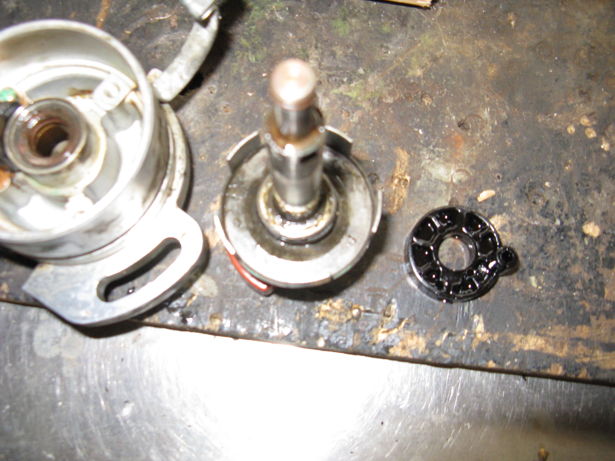

Well, I got the truck to run with the new ignition pickup. However, I had to shift the distributor housing about 20 deg.” counter clockwise”. The problem now is, I have no way to secure the distributor housing to the block. The adjustment slots in the housing no longer line up to the taps in the block for the locking bolts. So the timing can change or the distributor could just fall out. It only needs to slide out about a quarter inch to disengage with the cam.
Jan 6, 2019 at 5:14 AM
KENTON.STROOP
  • 14 POSTS

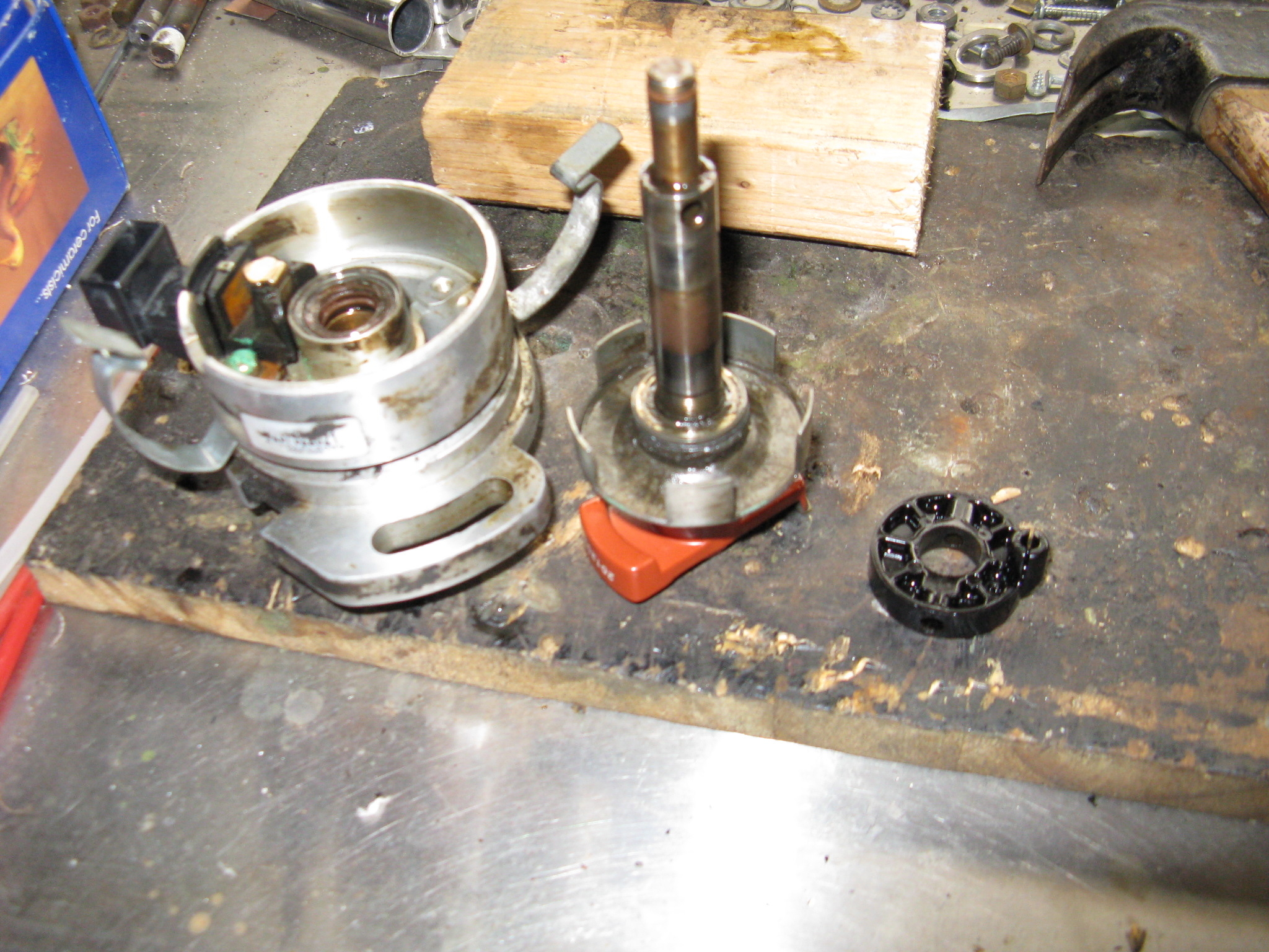

So, I started the truck and let it idle for thirty minutes without incident (idle rpm increase excessively with temperature) . And, I could not accelerate the engine with out it stalling. The advance doesn't work correctly. I tried minor adjustments without effect.
Pictures show the original Hall Effect Sensor/CMP, with reluctor at center.
Jan 7, 2019 at 12:57 AM
  • 55,412 POSTS
Yep, that is a five cylinder. does the new unit have four cut outs in the reluctor? I have seen the engine coolant temperature sensor cause issue like you are describing as well. Can you unplug it to see if the symptoms change?

The new sensor didn't come with a new reluctor, I'm using the original shown in the photo.
