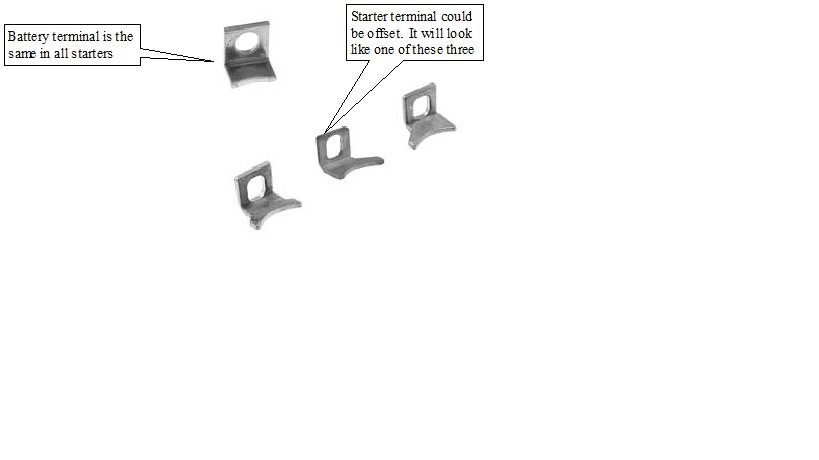

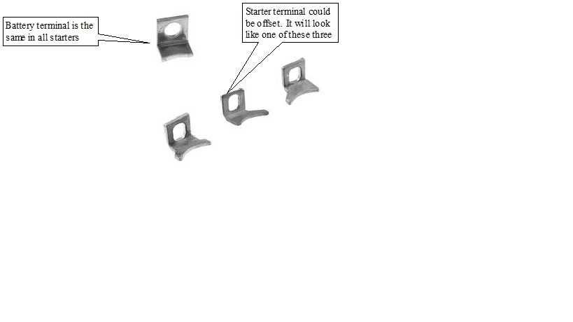

When you buy the repair kit, you'll get all four contacts shown in the photo. You'll use the one in the top left and one of the other three. When you buy these individually from a rebuilder, you'll have to take the solenoid cover off first to see which of those three is used. There is no way to tell without looking. There's two slightly different repair kits offered, and they're listed by model year, but you can't go by that. All of these starters interchange between at least 1989 and 2006, so if your starter has been replaced once already, it could be from any of those years.
The difference in the repair kits is the plunger they come with. The shaft on one is an eighth of an inch longer. I've always been able to reuse the original plunger. It normally gets replaced because of the heavy contact disc on it, but those rarely burn away.
This same starter is used on Toyota's. They use the same contacts, but their plunger has a much longer shaft. I've never found a rebuild kit for those. When you have to replace the plunger, those have to come from the Toyota dealer's parts department. They're very proud of them and charge accordingly.
If you need just the contacts, your best bet is to get them from the rebuilder. They cost about three dollars each. In the unlikely event you need a new plunger, you're better off looking for the rebuild kit. At the rebuilder shops, they cost more than the whole repair kit.
