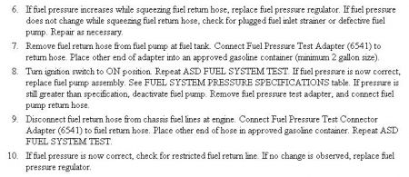

My car started to run rich, hard to start, run rough at highway speed very rich smell at the exhaust and poor fuel economy.
Now the problems are much worse.
I've replaced the injectors and coil pack, no help.
Suggestions?
It has the 3.3 L

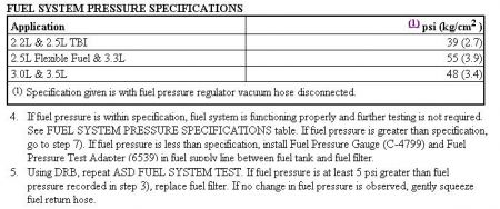

I believe your fuel pressure regulator is faulty. But before you replace that, test your fuel pressure at the rail.

Fuel pressure was checked: 50 psi at idle, 48 psi when reved up.

***I still believe it is your pressure regulator**** Truncated diagnostic procedure...
https://images.2carpros.com/forum/automotive_pictures/55316_94concordefpress1_1.jpg
https://images.2carpros.com/forum/automotive_pictures/55316_94concordefpress2_1.jpg
