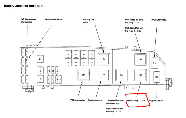

Engine does not start normally I have to push the start relay manually to get it to start.
Mar 6, 2021 at 7:17 AM
  • 110,248 POSTS
If you have to move the relay or push on it for it to work, there is either a corrosion issue, a pin on the relay is bad, or the pins in the relay box are pushed in or loose.

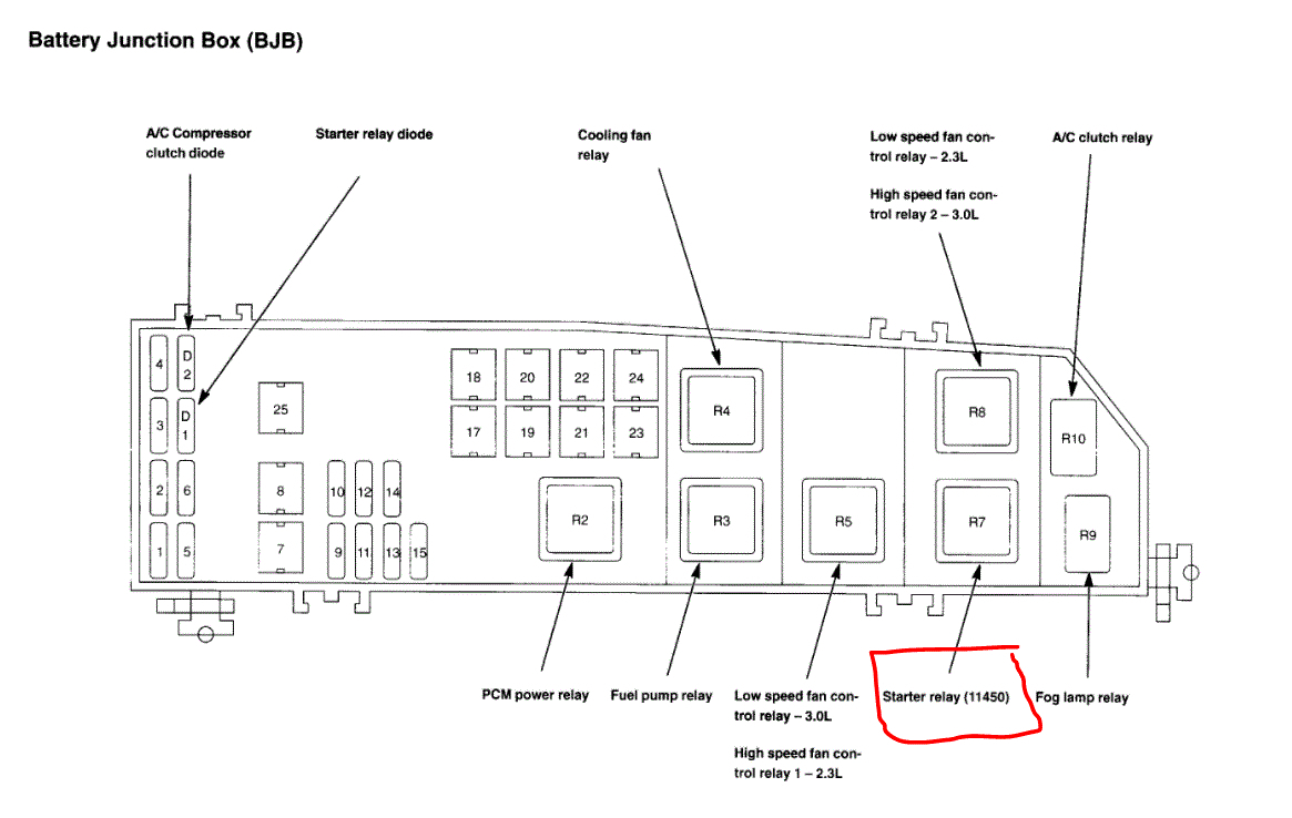

I attached a pic of the relay/fuse box below to confirm it is the starter relay. Remove it and check for issues in the box as well as the pins on the relay. If there is a different relay in the box that has the same part number, switch them to see if it makes a difference.
Here is a link that shows in general how a relay is checked:
