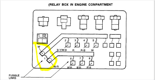

My vehicle is not starting, but I have never had any of this before. Just had a buddy put new plugs in.
It ran fine after (no more stalling at every darn stop).
But when I parked to use a restroom and got in the car
I have lights and all function, my battery isn't doing a thing but power to accessories. Someone sparked wrong terminal trying to jump me.
But I checked all fuses seem fine
However, I'm not even a clue about any relays that could've blown...help they want to impound my home. Please
Aug 14, 2022 at 4:03 AM
  • 110,240 POSTS

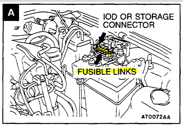

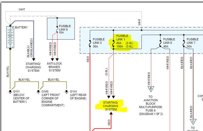

If it was shorted right at the battery, my first suspect is fusible link number 1 in the engine room left side inner fender.
If you look below, pic 1 shows the power to the starter that comes from that fusible link. Pics 2 and 3 will help you locate it.
Check that link. If you have a test light, make sure there is power on both sides.
let me know what you find.
