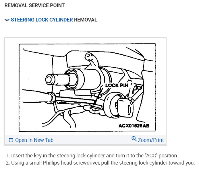

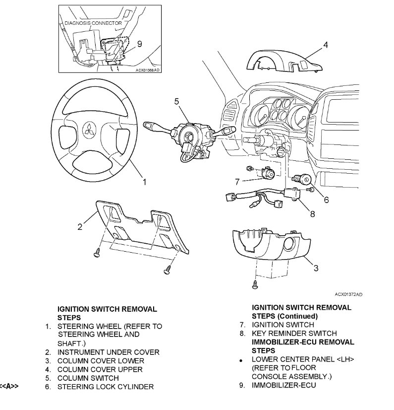

I installed a new battery. The engine cranks but the car won't start. I also observed that even with the new battery, the electrical system seems to be "dead", i.e., lights wont turn on, power windows don't function, etc. The battery is the recommended model for the car, and I'm certain that the terminals are tight.
Oct 26, 2010 at 5:16 PM
  • 75,992 POSTS
It sounds like the ignition switch has gone bad not allowing the rest of the car to power up here is a guide that will help you change it out. Check out the diagrams (Below). Please let us know what you find. We are interested to see what it is.

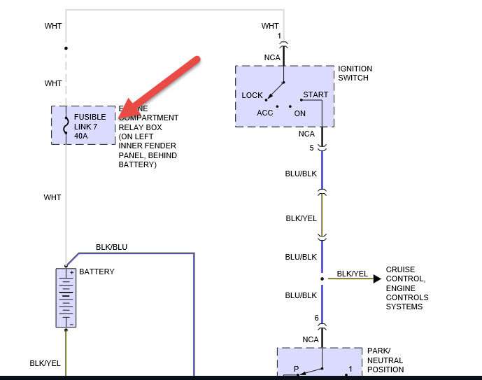

I fit won't crank check battery for condition including load test and check main fuse may have blown
Jan 9, 2019 at 11:13 AM (Merged)
CPERDUE856
They charged the battery and there are no codes popping up
HMAC300
  • 48,601 POSTS
check the fusiblelink in pic it supplies power to ignition switch this may have blown. I have no further comments or suggestions.
