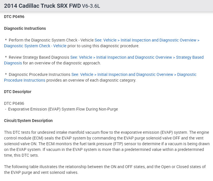

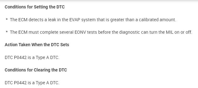

It has 2 codes P0442 and P0496.

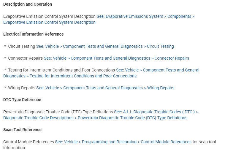

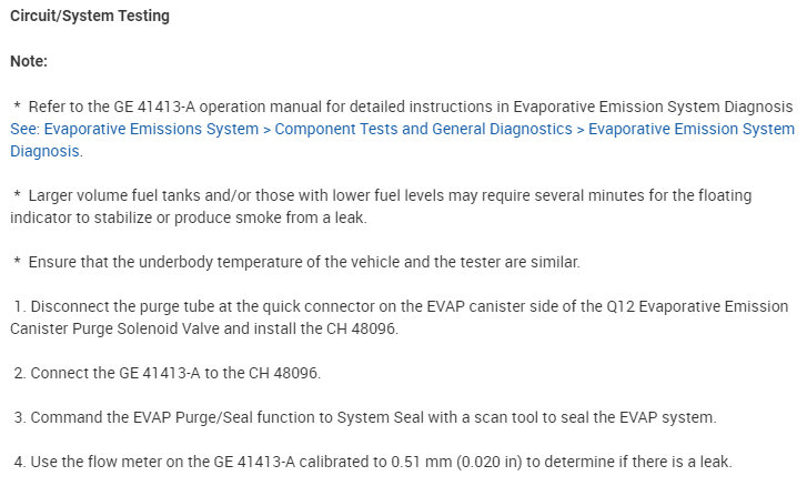

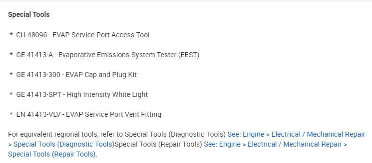

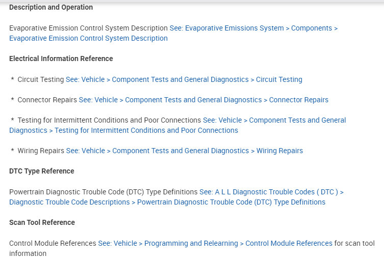

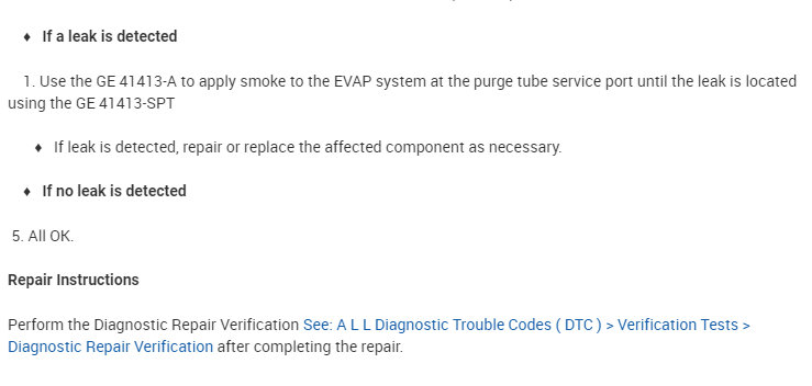

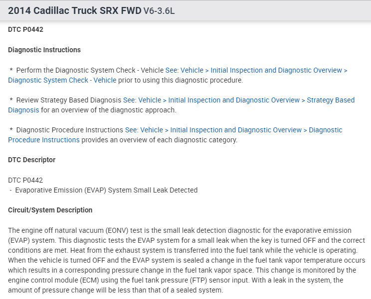

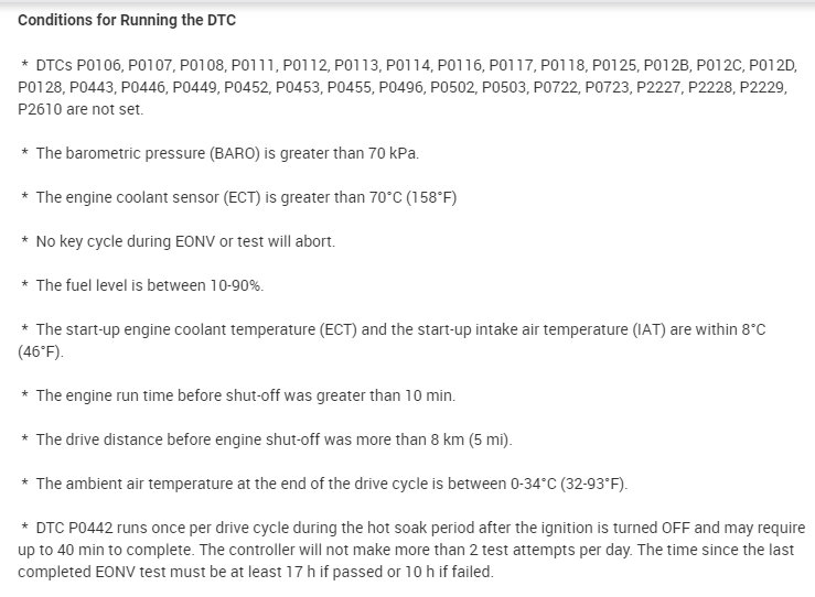

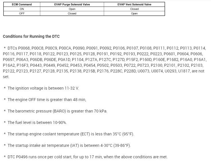

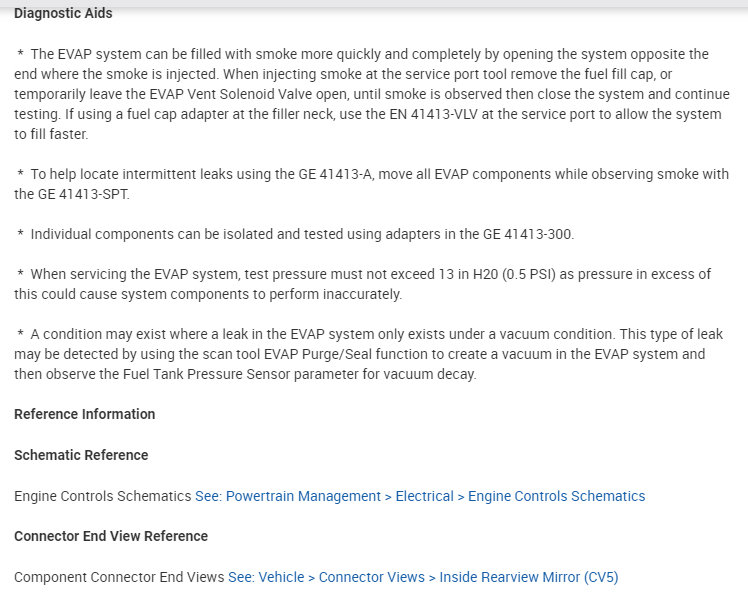

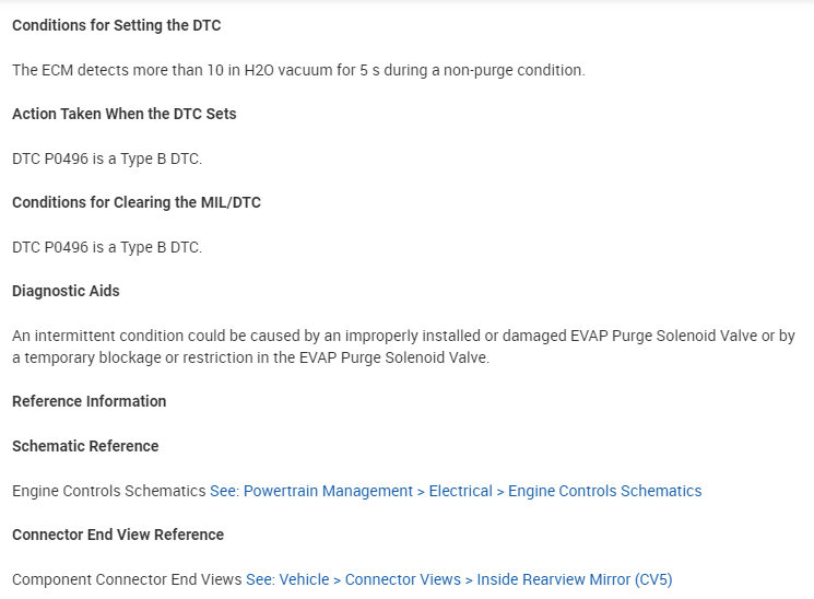

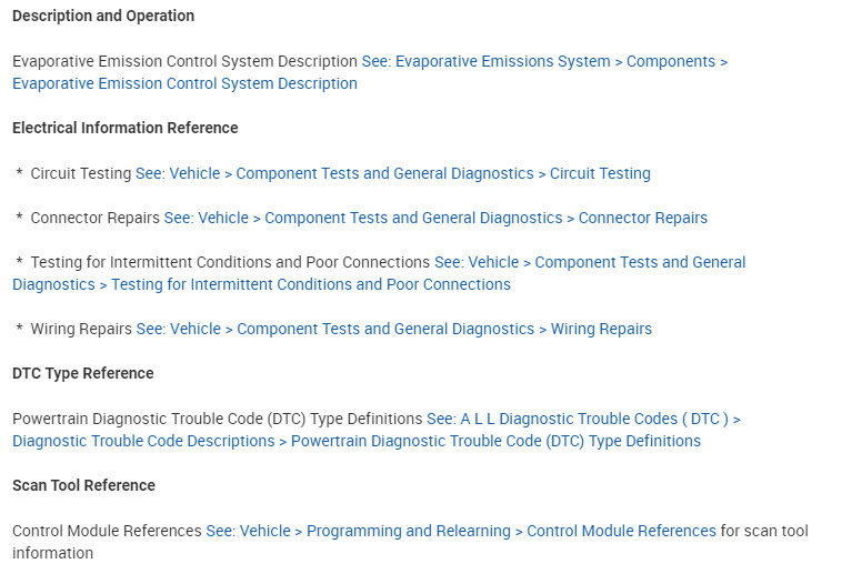

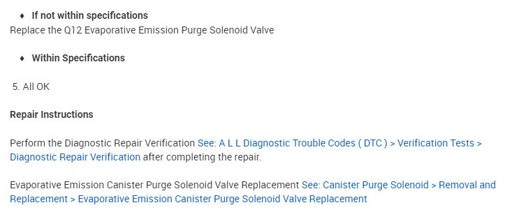

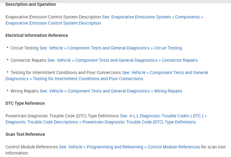

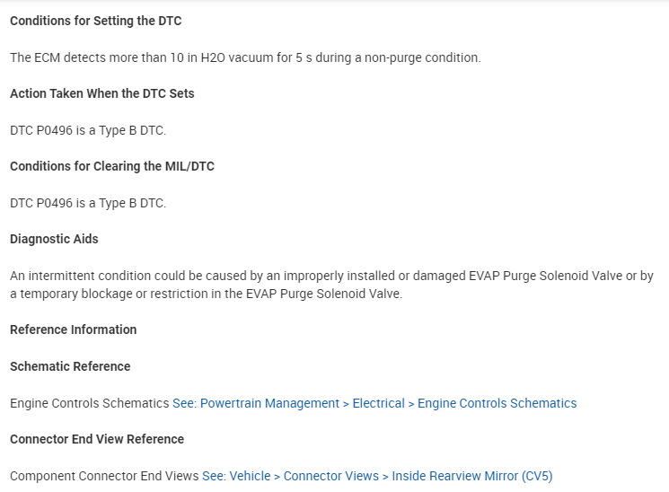

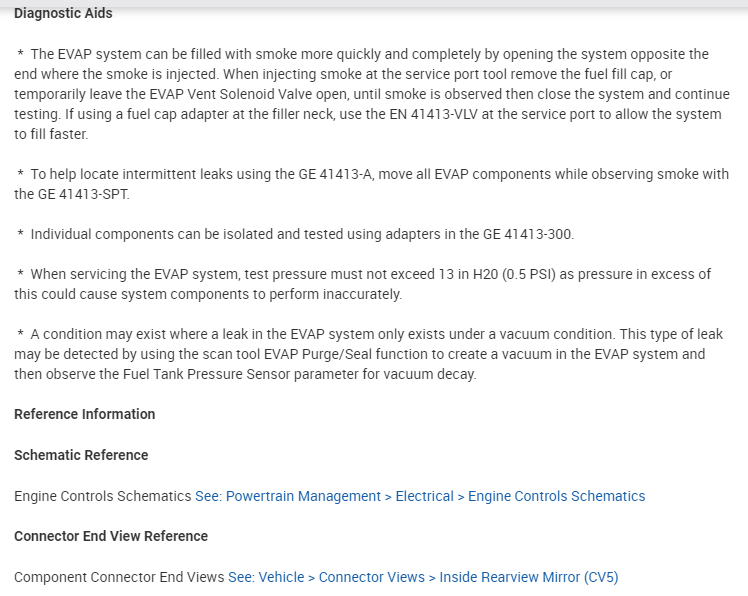

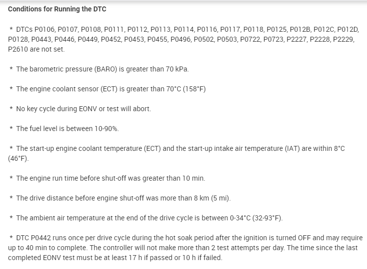

Just to add my two cents those codes are related to the evaporative emissions system.The system is designed to collect/store/and send the gasoline vapors back to the engine to be re-burnt to reduce emissions pollution to the earths atmosphere. It is a closed system so there should be no leaks to escape vapors into the environment. Here is a quick tutorial showing what is involved:
https://www.2carpros.com/articles/evap-system-code-repair

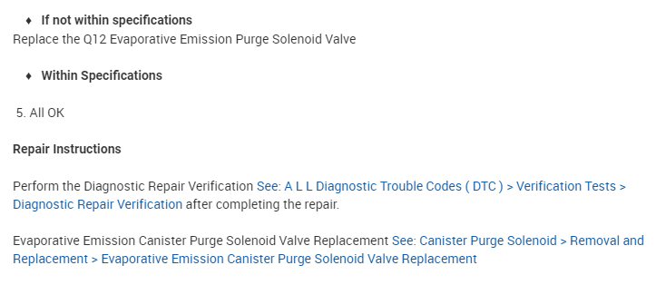

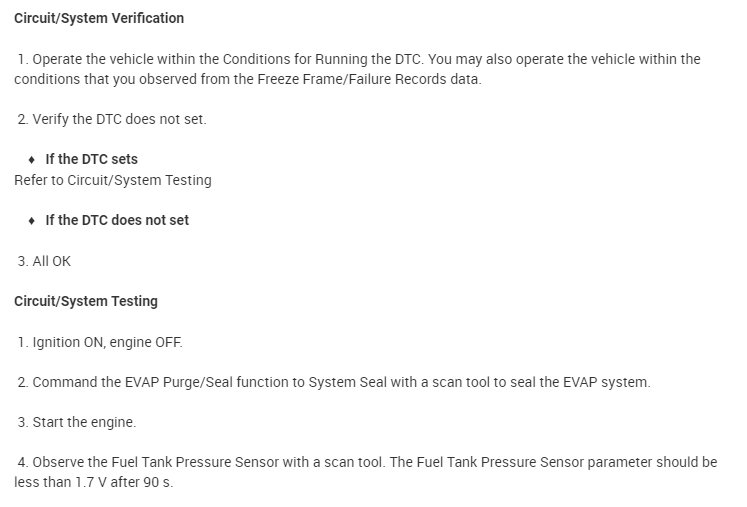

The best way to test is to use an scanner and or smoke machine. I've attached below a step-by-step description of your vehicles 2 codes you've provided and how to test. Hope this helps and thanks for using 2CarPros.
