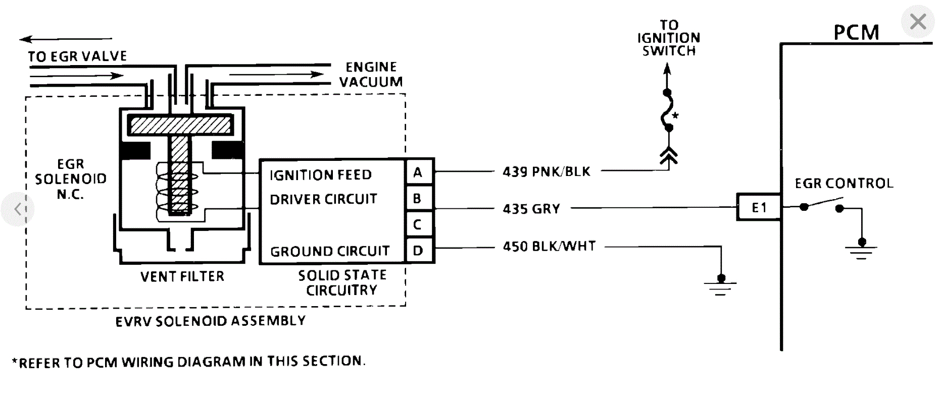

I sprayed it with carburetor cleaner no change in idle. Only code is 32 and I have replaced the EGR three times, and it throws same code 2 months after I replace it every time. Any chance the cat could be clogged, making it throw the 32 code. I can’t really tell if it is clogged because the exhaust fumes smell rich. I have smelled a sulfur smell but don’t know if it is. The other thing I was thinking it was maybe the MAP sensor. I have replaced the coolant temperature sensor and the IAC valve also. They pulled the EGR and said it was black from running lean and they had tested the EGR valve.
Dec 22, 2021 at 2:15 PM
  • 110,248 POSTS

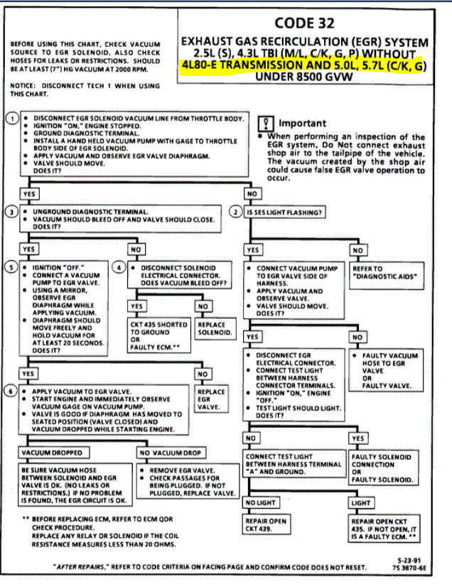

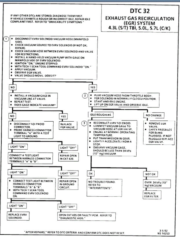

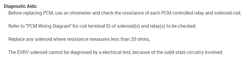

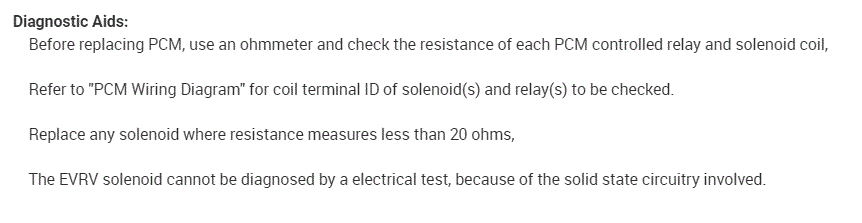

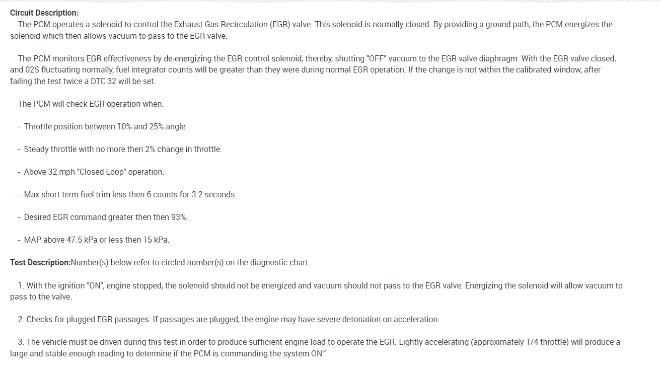

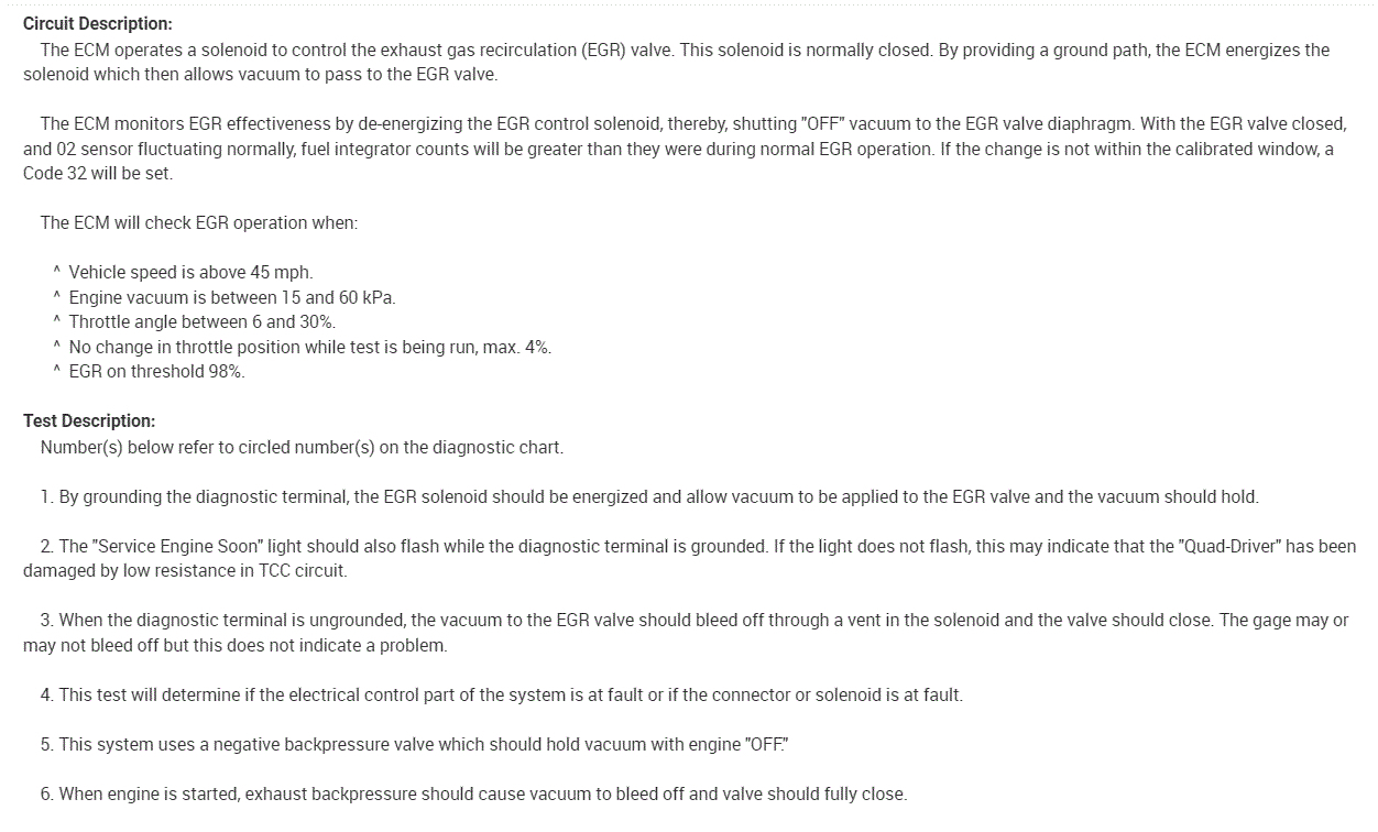

If the catalytic converter is plugged, it will affect the EGR airflow. However, there would be a noticeable power loss. I don't know if that's the case.

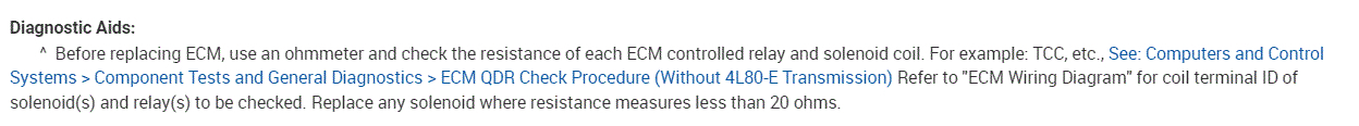

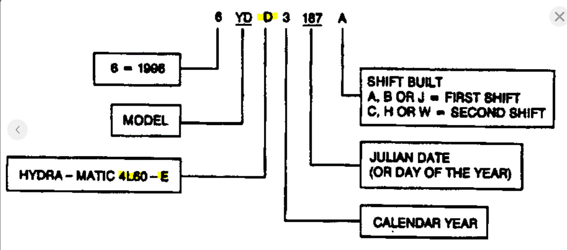

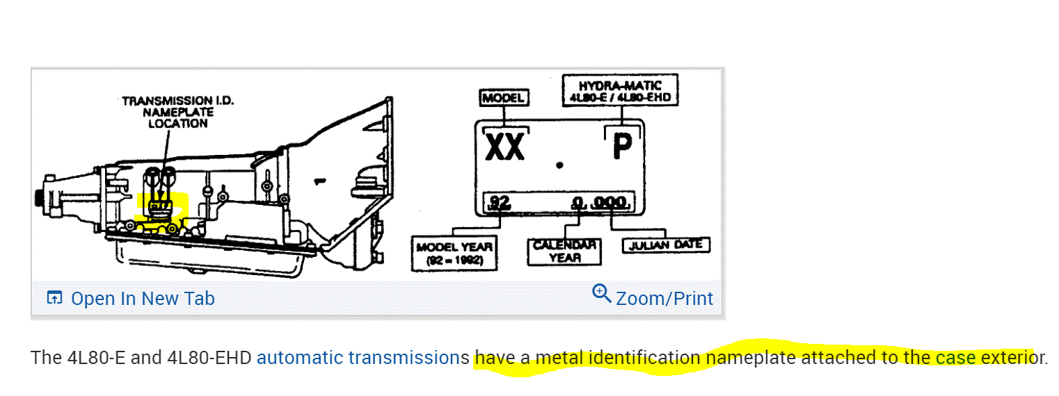

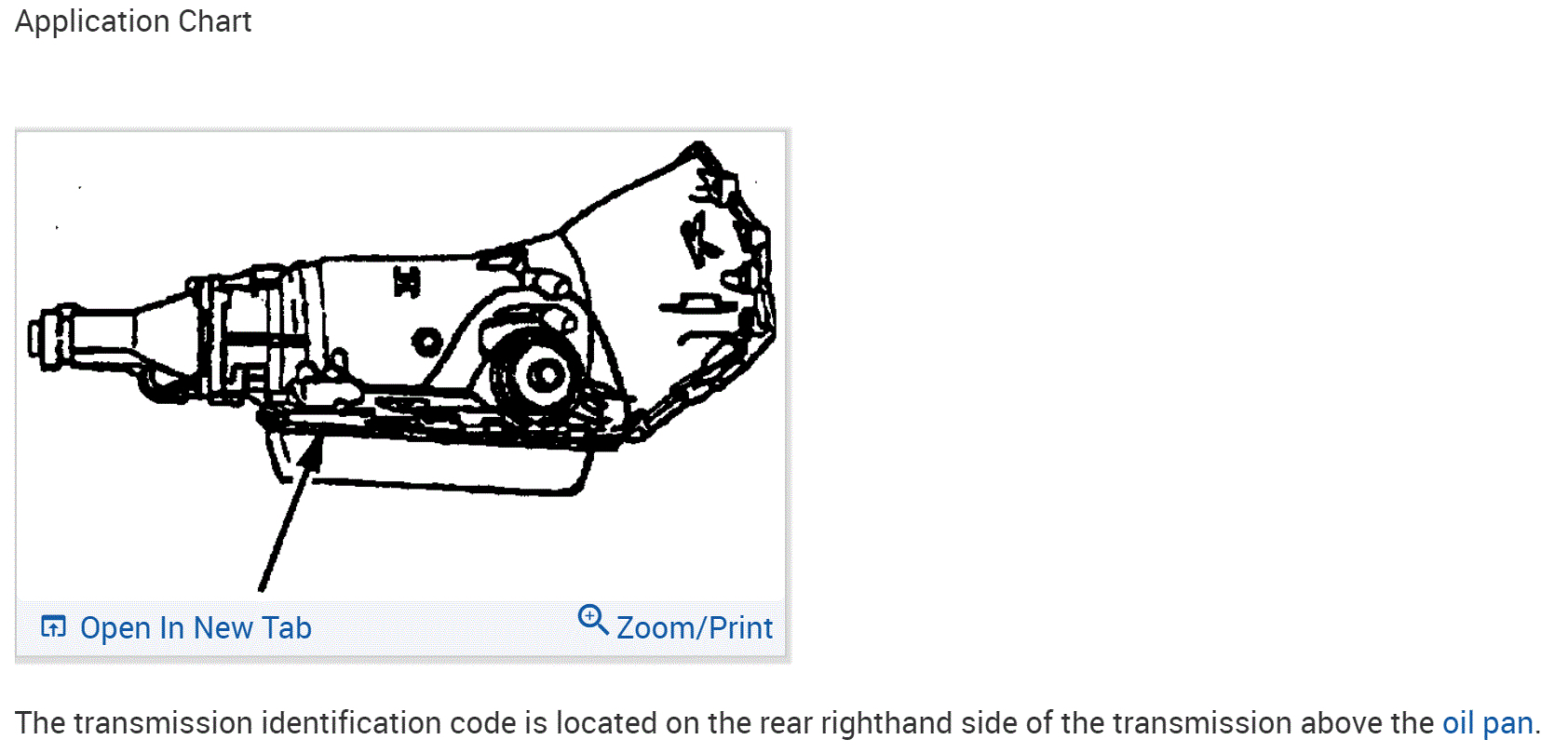

I attached diagnostic flow charts below. There are two different sets of diagnostics based on the transmission type.
IF you look at the last three pics, they explain how to identify the transmission type.
Let me know if you are comfortable doing this. Also, let me know if there is a power loss when driving.
