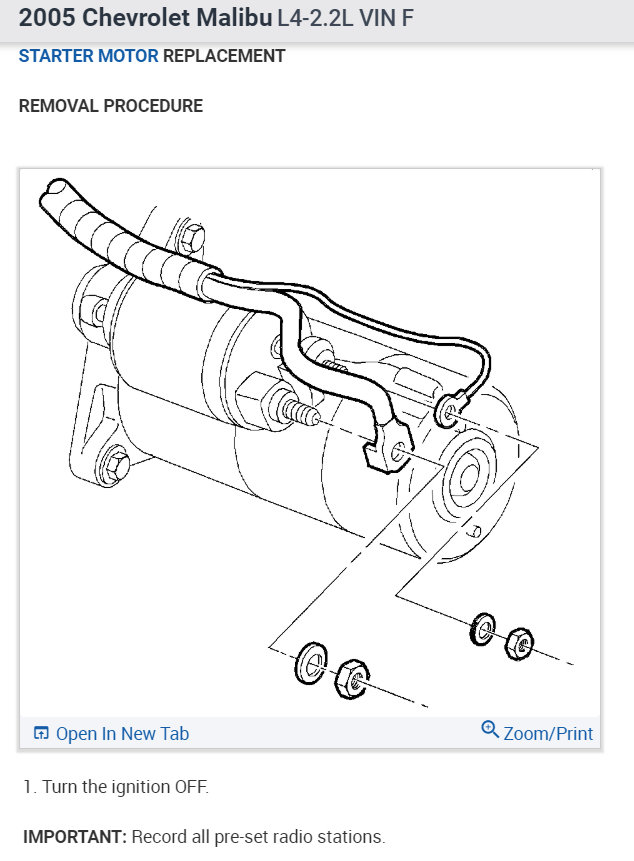

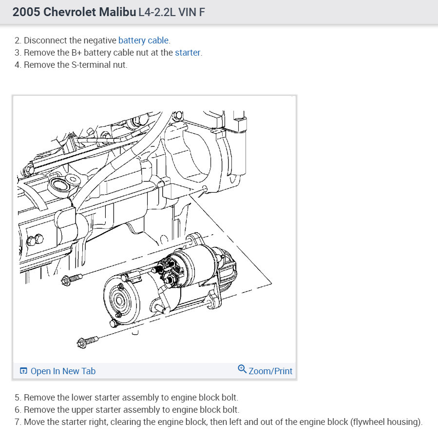

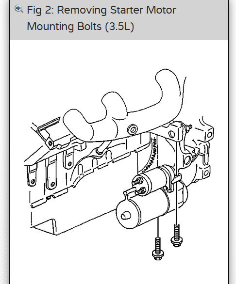

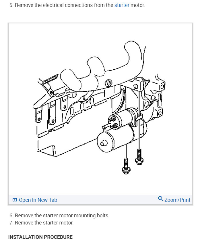

The starter is located at the right front just under the cartridge oil filter housing. I cannot get a box or socket on the top bolt that holds on the starter. How do I get this top bolt out. The head of the bolt is tucked under the filter housing on top of the starter. The bottom bolt can be taken out from under the car with no difficulty.
May 3, 2015 at 10:01 AM
  • 110,240 POSTS

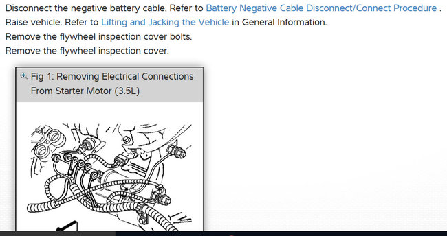

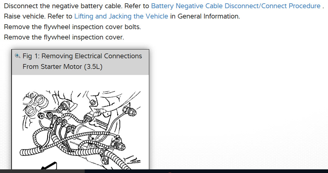

Hi:
You need to use an extension to access the inner bolt from above the starter motor a wrench will not work. Here is a guide that shows how to do it and diagrams below to show you how the starter comes out in your car below.

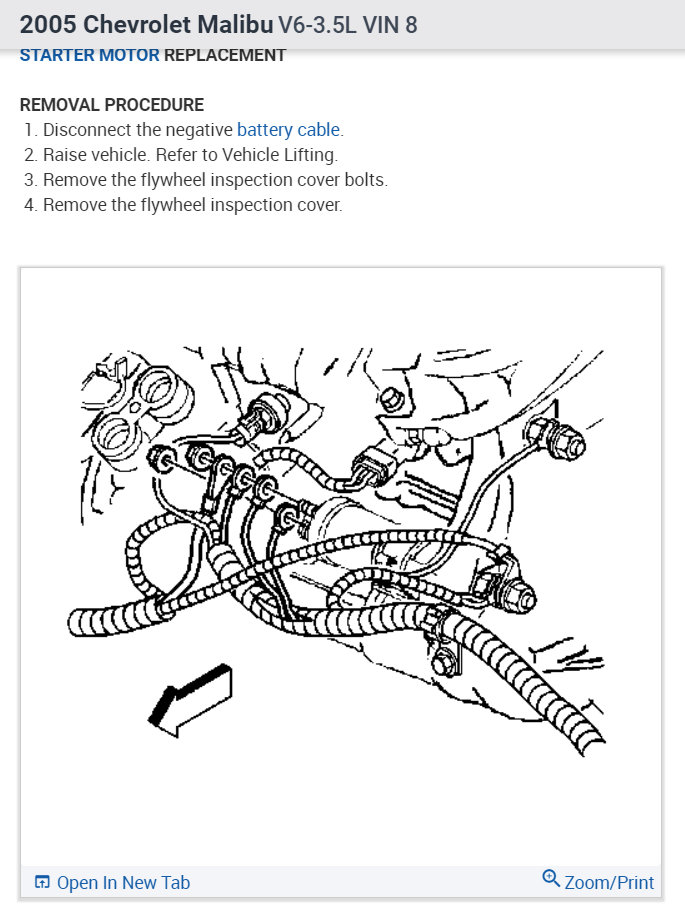

remove electrical after first step then reinstall is pretty much reverse of removal. see pictures.

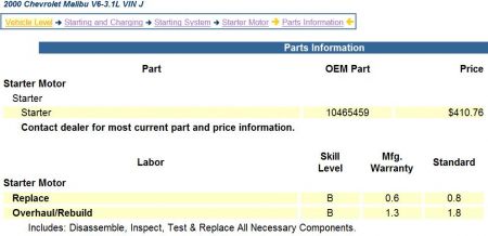

I have my neighbor put in a starter. How much does it cost for a brand new starter i never had any problems with the starter before. And how long does it takes to put one in. What is the labor cost these days?
Jan 22, 2019 at 4:58 AM (Merged)
  • 75,992 POSTS
Heres a screen shot from a manual for parts/labor. You can call around for other labor prices and different starters (Reman vs. New)
https://images.2carpros.com/forum/automotive_pictures/12900_s_25.jpg
Note:Part and labor varies within location. Labor is about $70.00-$130.00 an hour.

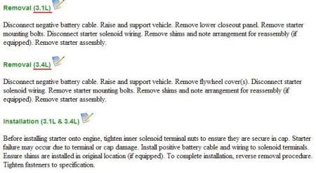

  • 110,240 POSTS
Disconnect the battery, remove the wiring to the starter (front of engine), and there are two bolts that hold it on. Remove them and the starter will come off.
