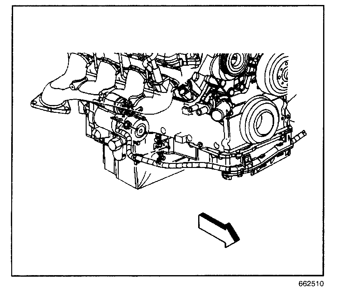

I am trying to remove the starter to get at the cam positioning sensor. I have managed to cross thread one of the starter bolts but I got it out. I cannot see the top of the starter to disconnect the wires. I cannot visualize the starter from the top of the engine. Do you guys have a diagram or picture you can share? There are no videos on YouTube for this.

Did you remove the torque converter cover? I remove the two bolts and pull the starter down and then remove the wiring. My hands are way too big to get up there. Here is a guide to help you step by step with instructions in the diagrams below to show you how on your car.

2002 Chevy Truck C 1500 Truck 2WD V8-5.3L VIN Z Flex Fuel
Starter Motor Replacement -2
Vehicle Starting and Charging Starting System Starter Motor Service and Repair Procedures Starter Motor Replacement -2

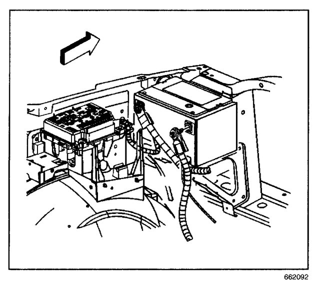

STARTER MOTOR REPLACEMENT -2
REMOVAL PROCEDURE

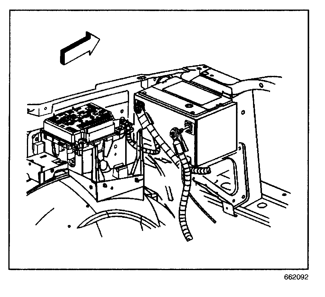

CAUTION: Refer to Battery Disconnect Caution In Service Precautions.
pic 1
1. Disconnect the negative battery cable.

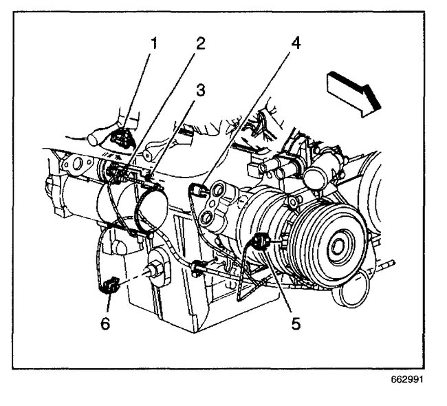

2. Raise and suitably support the vehicle. Refer to Lifting and Jacking the Vehicle.

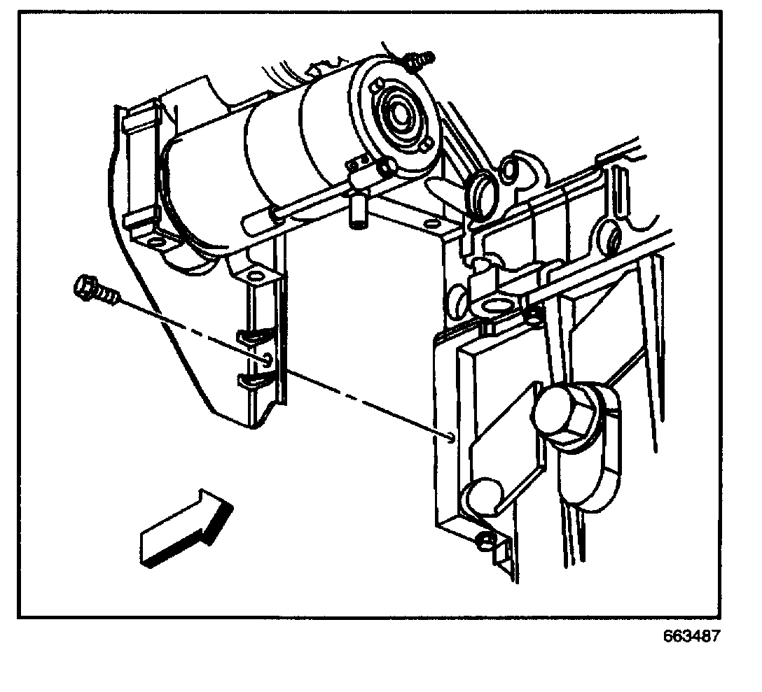

pic 2
3. Remove the right transmission cover bolt.
pic 3

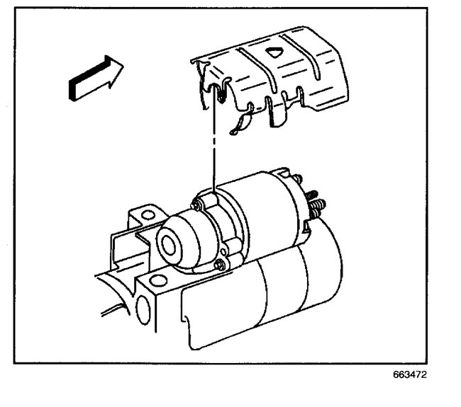

4. Remove the starter bolts.
5. Disconnect the oil level sensor electrical connector.
6. Slide the starter forward until the starter clears the transmission.

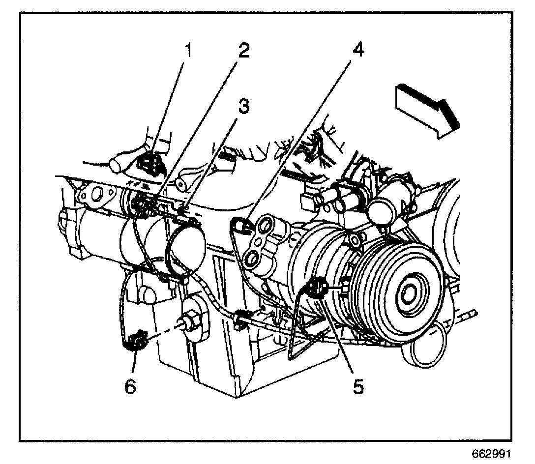

pic 4

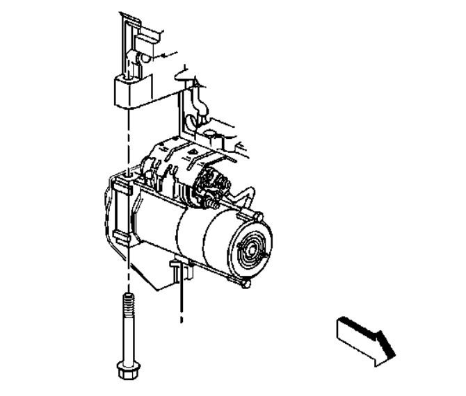

7. Remove the starter solenoid nut (3).
8. Remove the starter lead (2) from the solenoid stud.

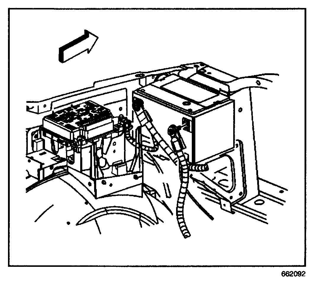

pic 5

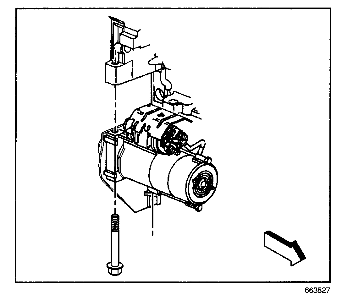

9. Remove the starter lead nut.
10. Remove the positive cable from the starter stud.
11. Place the starter on a workbench.

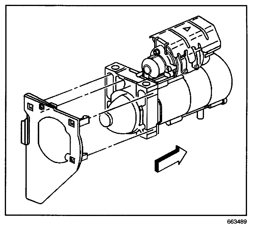

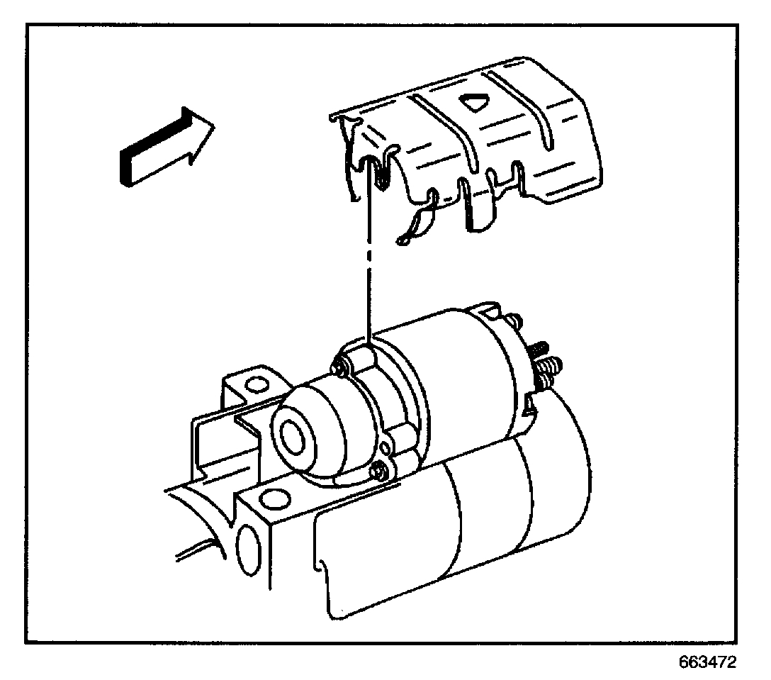

pic 6
12. Unsnap the transmission cover from the starter.
pic 7
13. If necessary, remove the starter shield.
INSTALLATION PROCEDURE
pic 8
1. If necessary, install the starter shield.
pic 9
2. Snap the transmission cover to the starter.
pic 10
3. Install the positive cable to the starter stud.
NOTE: Refer to Fastener Notice in Service Precautions.
4. Install the starter lead nut.
Tighten
Tighten the starter lead nut to 9 N.m (80 lb in).
pic 11
5. Install the starter solenoid lead (2) to the solenoid stud.
6. Install the starter solenoid nut (3).
Tighten
Tighten the starter solenoid nut to 3.4 N.m (30 lb in).
pic 12
7. Snap the transmission cover onto the starter.
8. Slide the starter rearward.
9. Install the starter bolts.
Tighten
Tighten the starter bolts to 50 N.m (37 lb ft).
10. Connect the oil level sensor electrical connector.
pic 13
11. Install the right transmission cover bolt.
Tighten
Tighten the transmission cover bolt to 9 N.m (80 lb in).

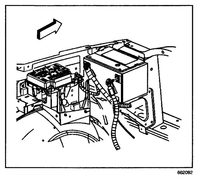

12. Lower the vehicle.
pic 14
13. Connect the negative battery cable.
______________________________________________
