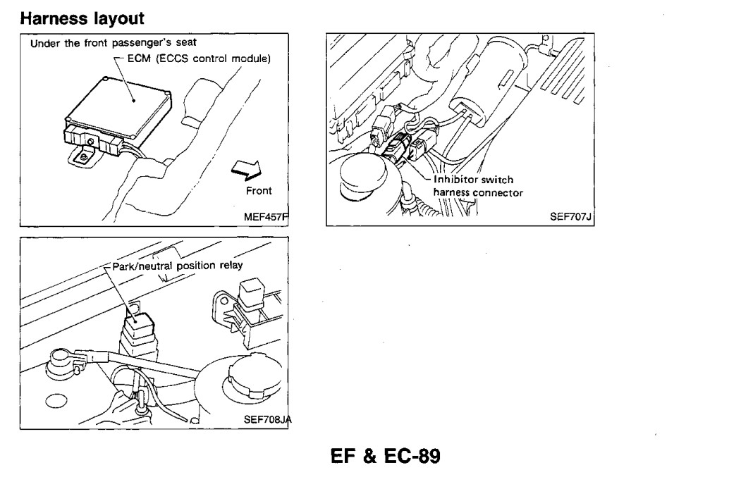

Where is the exact location of the starter relay on the truck listed above XE short bed? Is it labeled inhibitor relay? How to release the stubborn clip for removal and replacement?
Feb 2, 2025 at 6:29 AM
STEVE W.
  • 15,404 POSTS
Yes it is the inhibitor relay located on the left fender apron. That age of plastic you will want to be careful with the clips, they can fail easily. I'm guessing you already tested the switch and the park neutral switch? Or are you removing the relay to test there?

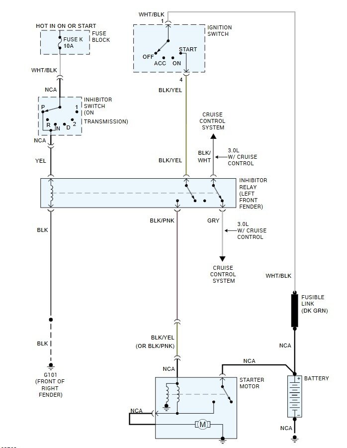

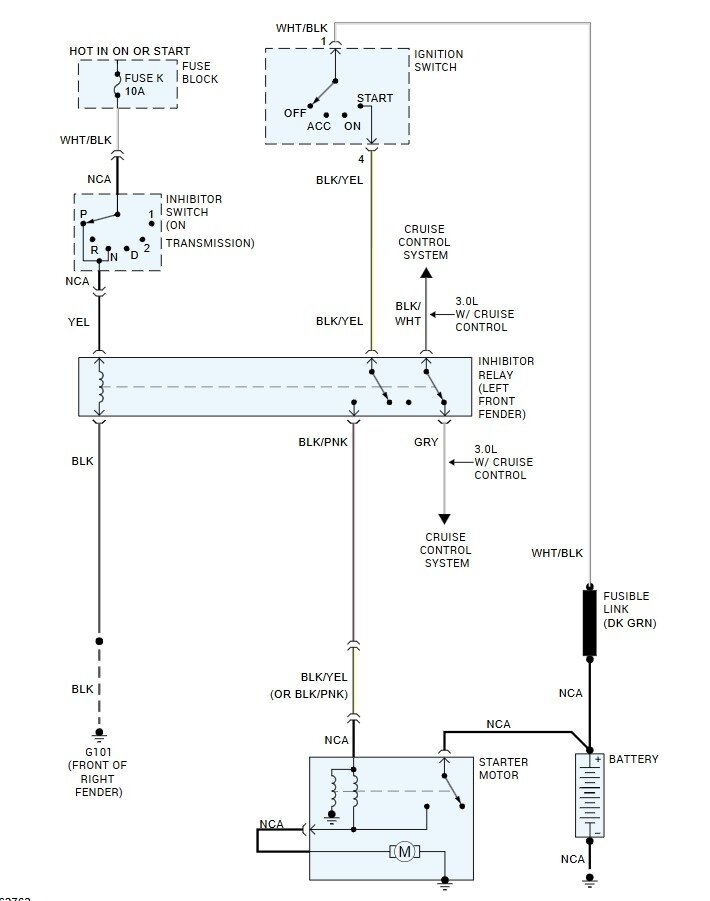

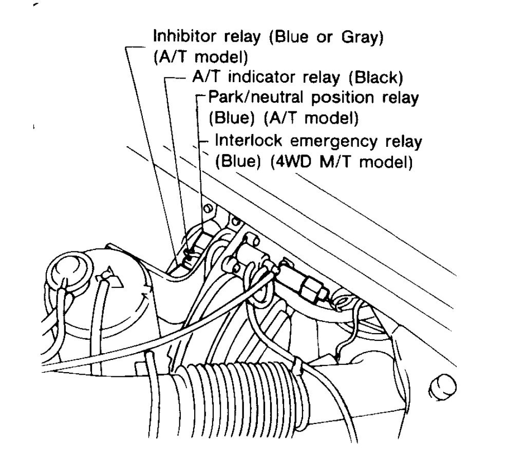

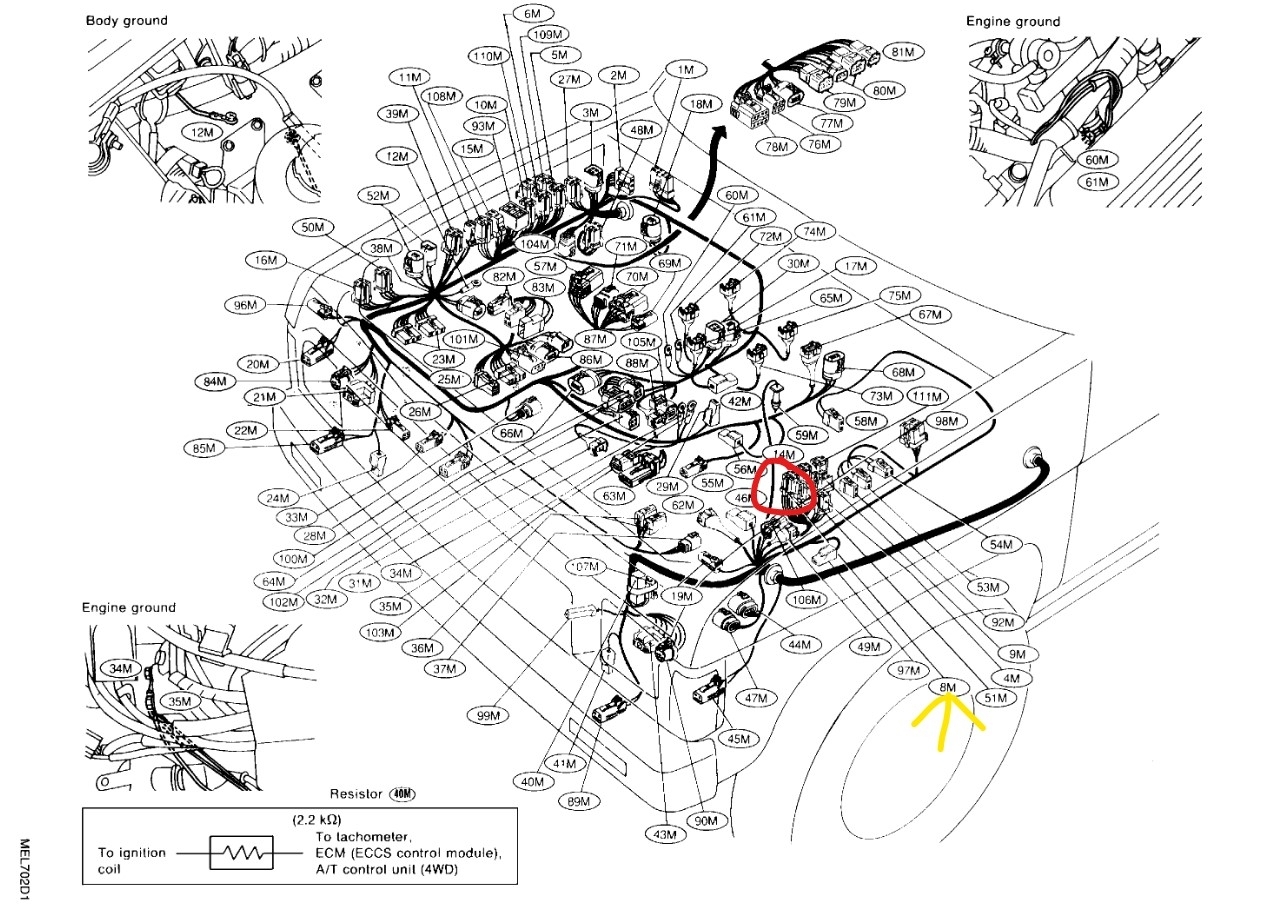

The inhibitor relay should be on the left fender if this is a US truck. There are a bunch of relays on the opposite side, but the starter relay is on the left side tucked into the bracket as shown in image 2.
Feb 4, 2025 at 2:29 AM
  • 55,691 POSTS
It is on the right side. These diagrams are not correct for my truck.

As Ken says, give us the VIN and we can see if there is some different service information on your truck. Service information from Nissan for 1993-1996 shows it the same way as indicated for the US delivered XE and Hardbody trucks. There is a starter interlock relay on the right side but that in on the manual transmission trucks, not an automatic as you indicated.

On further inspection the image 2 provided by Steve W. seems correct after all. Thanks for your help.

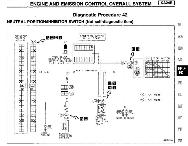

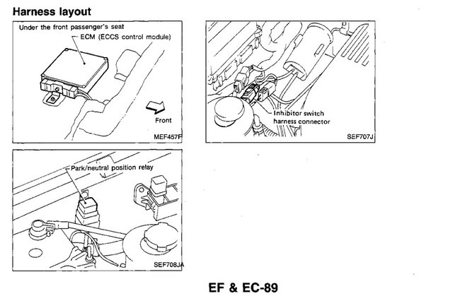

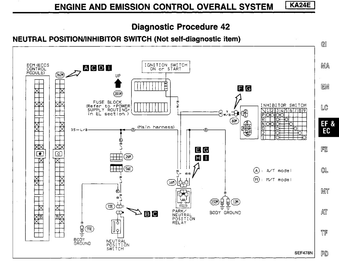

Yep got it. Thank you. Looking at a factory manual for that VIN shows the location of the starter inhibit relay in the same place as I already posted on the left side of the engine bay if it's an automatic, which the VIN shows it was built as from the factory. The online Nissan info system goes back to 1996 and looking at the 96 D21 it shows the same relay location as well in 1996. I'm not sure what relay you are looking at unless someone modified the factory harness on the truck to relocate the inhibit relay as all of the OE info shows it on the left fender.
There is a neutral position relay on the other side, but it doesn't control the starter. It only tells the ECU itself if the inhibitor switch (gear position switch) is in park or neutral as part of the emissions system. It has a light blue wire and a yellow wire as well as two ground wires in black. Is that the relay you are looking at?

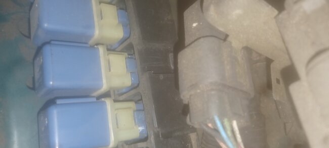

I have located the inhibitor/starter relay. I can't seem to figure out how to open the clip holding it in place. This attachment, though not the actual starter relay, is a photo of the type clip holding it. How does this thing release?

Should be a push release. Push in on the lower blue tab and pull up. Because it has been on there since new it may fight a bit. Be careful rocking it though as the connector under it may be brittle.

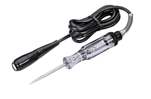

There are a few things in that circuit that can stop it from starting. A simple way to test the starter circuit would be to pull the inhibit relay. Now use a piece of wire to jumper between the black with yellow wire and the black with pink wire. Turn the key to start. This bypasses all the inhibit items, so if the starter now works you know the issue is somewhere else. If it doesn't then I would check the connections on it. With the relay out you can also use a simple test light to do some tests at the relay socket. Find the terminal with the yellow wire and the one with a black wire. Connect the test light between them. With the transmission in park or neutral and the key on the light should come on. That would tell you the neutral switch circuit is okay.
