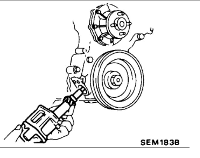

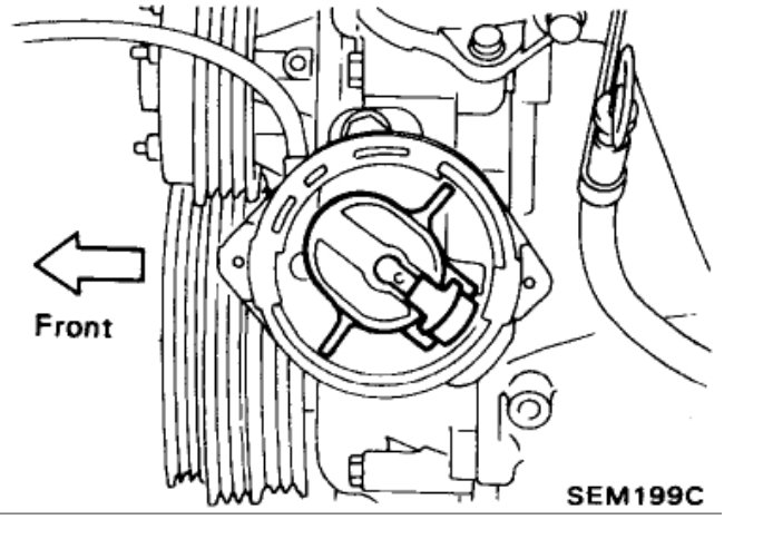

Just replaced the timing chain but not sure how to reset the timing to the proper specs. The timing looks to be set right. The truck still will not start could the distributor be 180 degrees out?
May 26, 2010 at 12:46 PM
BLUELIGHTNIN6
  • 16,542 POSTS
Yes, the rotor could be positioned wrong. Crankshaft pulley marks and front cover marks should align and the distributor. Rotor should point to plug wire number one on the cap. Here are both the four and six cylinder timing marks for the camshaft. Below

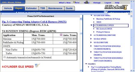

SAYLES4
Just verified that the marks are set and that they did not move. The truck seems to run good, but my timing is still at twenty btdc. Can I let it go like this?
Apr 1, 2017 at 9:47 AM (Merged)
Twenty is not too bad for idle timing. Going to check the spec.

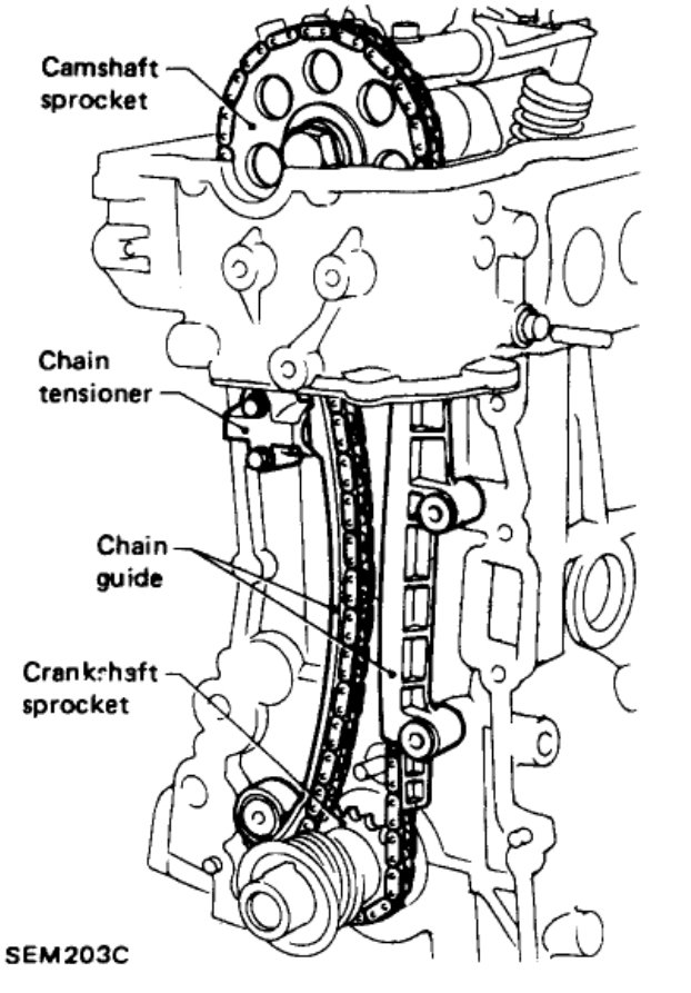

SKOOTER1113
Had to take the timing chain out, it had broken the timing adjuster and rubbed a hole in the timing cover where the water jacket was, letting water in the oil. So it had already jumped time. So I changed everything and bought new parts. Need to know how to time it back. Your help would be greatly appreciated.
Sep 9, 2018 at 9:51 AM (Merged)
HMAC300
  • 48,601 POSTS
Here are the camshaft timing marks. Check out the diagrams (below). Please let us know if you need anything else to get the problem fixed.

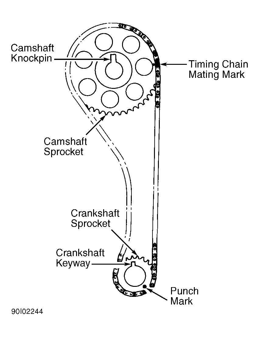

BE1974
  • 6 POSTS
does all marks have to align the crankshaft and camshaft with timing chain
Jul 29, 2020 at 6:36 AM (Merged)
BLUELIGHTNIN6
  • 16,542 POSTS
https://images.2carpros.com/forum/automotive_pictures/261618_Graphic_683.jpg
BE1974
  • 6 POSTS
Good diagram but it is a four cylinder with four spark plugs.
BLUELIGHTNIN6
  • 16,542 POSTS
https://images.2carpros.com/forum/automotive_pictures/261618_Graphic_684.jpg
BE1974

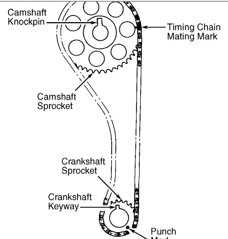

  • 6 POSTS
Thanks. okay, does camshaft knock-pin always up or just align with timing chain?
BLUELIGHTNIN6
  • 16,542 POSTS
Well, it spins in operation, but when replacing chain the cam knock-pin and crank sprocket key-way must point up (12 o'clock position).

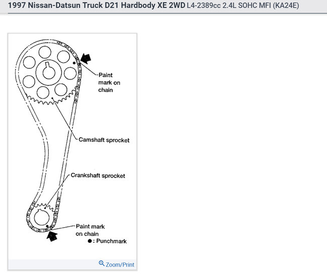

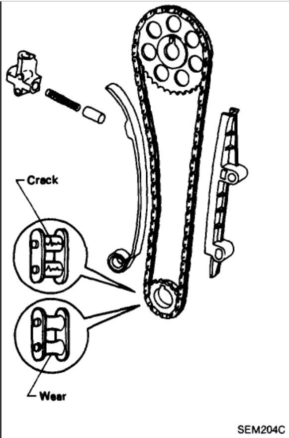

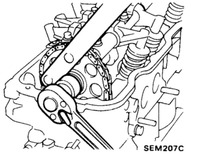

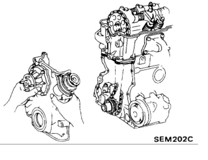

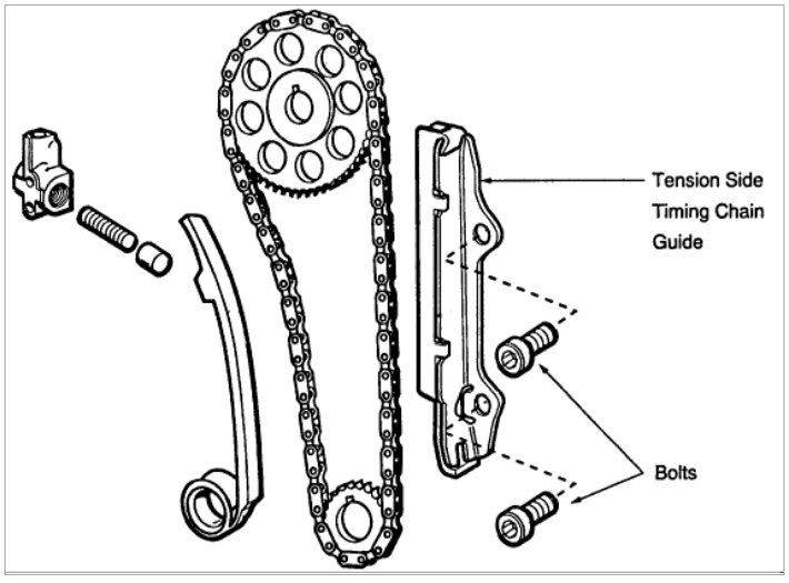

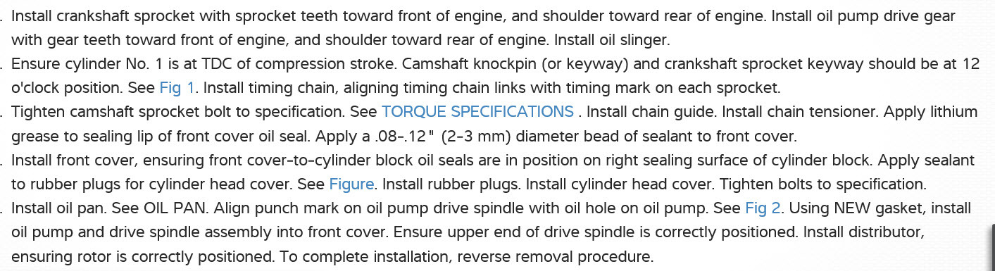

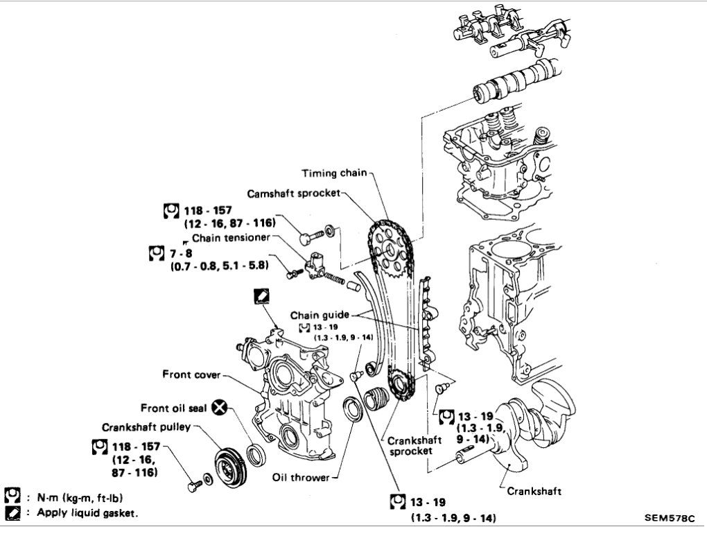

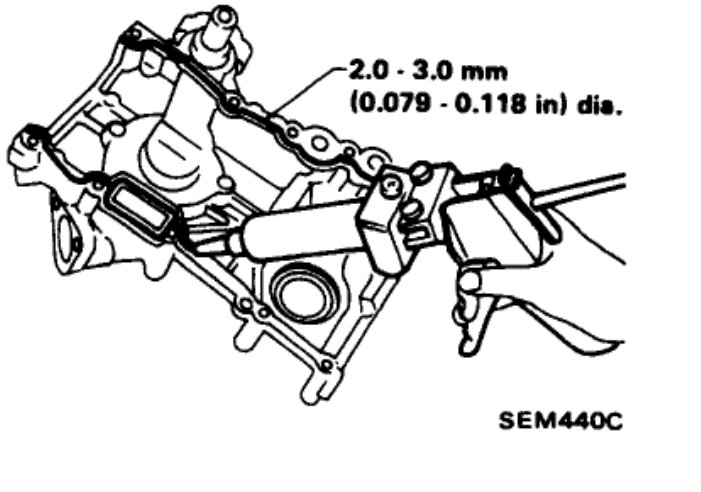

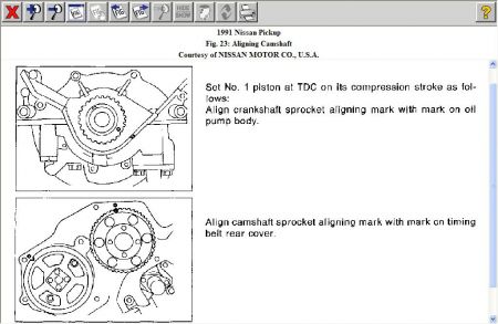

STITCHES
i have a 1991 Nissan truck w/ 2.4L (ka24e)engine. I replaced the head gasket. The timing chain slipped on the crank. I am not sure witch way. How do I time in the cam? The truck purrs like a kitten, but has a slow throttle response.
Jul 29, 2020 at 6:37 AM (Merged)
  • 55,542 POSTS
There are timing chain diagrams to show you how to install the chain and camshaft and crankshaft marks. (BELOW)
Here are the procedures and steps that are not relevant should be skipped.

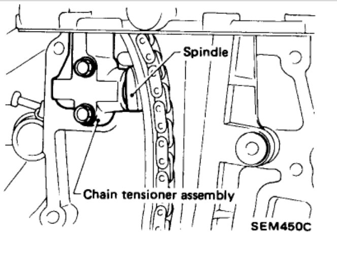

Removal
1. Remove front cover. Carefully remove chain tensioner. DO NOT lose spring. Remove chain guides. Remove camshaft sprocket bolt, ensuring camshaft does not rotate. Remove timing chain and camshaft sprocket.
CAUTION:DO NOT rotate camshaft or crankshaft with timing chain
disconnected.
2. Remove oil slinger (if equipped). Remove oil pump drive gear (note installation direction). Remove crankshaft sprocket. Remove chain guide and tensioner.

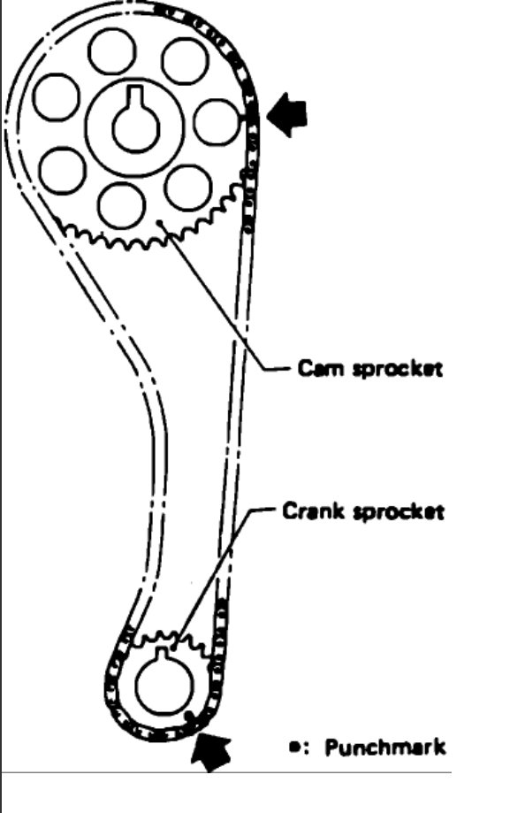

Installation
1. Ensure No. 1 piston is at TDC of compression stroke. Camshaft knock-pin should be at 12 o'clock position. Align silver timing chain link with punch mark on sprocket.
2. Install timing chain onto crankshaft sprocket. Align marks on timing chain with marks on crankshaft sprocket. See Fig. 6. Both sprocket timing marks will be toward left of engine. Install chain guide and tensioner. Adjust chain guide tensioner.
3. Install oil pump drive gear onto crankshaft with large chamfered inner face toward rear. Install oil slinger (if equipped). To complete installation, reverse removal procedure.
PS, Here are the marks for the six cylinder as well.
https://www.2carpros.com/diagrams/nissan/pickup/1991

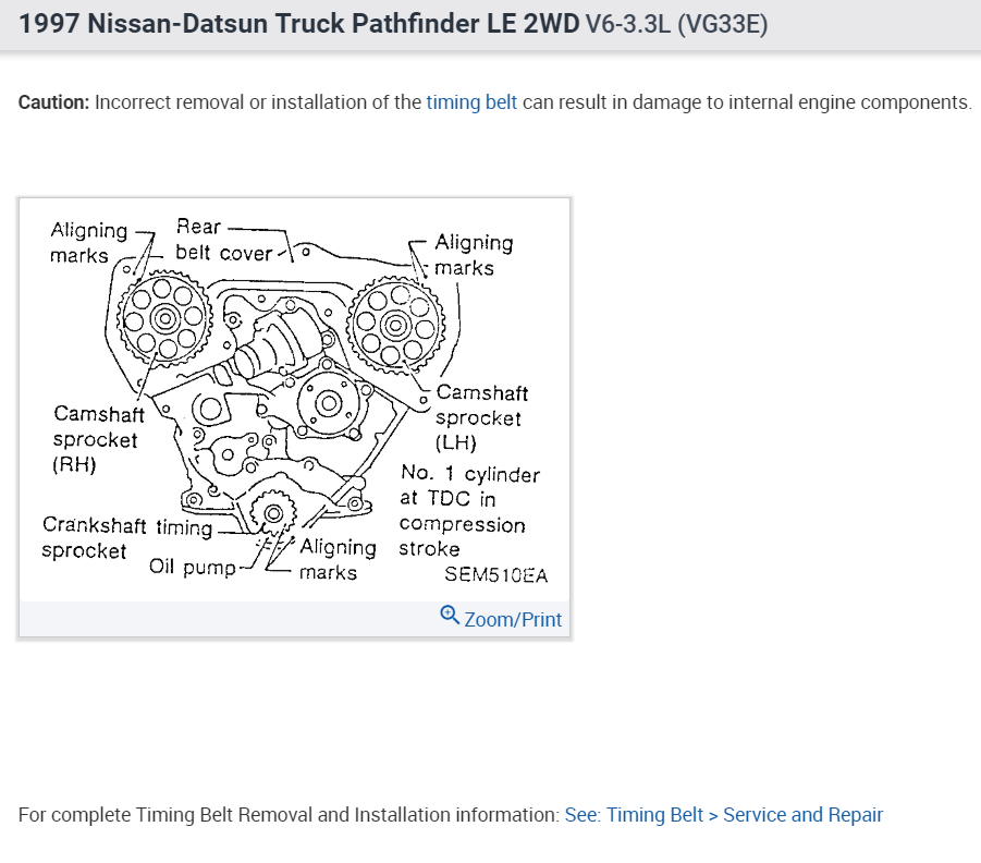

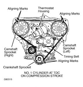

MICHELLE1298
1991 Nissan Truck 6 cyl Four Wheel Drive Manual
What are the timing marks on my truck?Can't get it back in time.

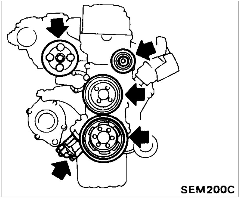

BLUELIGHTNIN6
  • 16,542 POSTS
VG30i engine.
https://images.2carpros.com/forum/automotive_pictures/261618_1_23.jpg

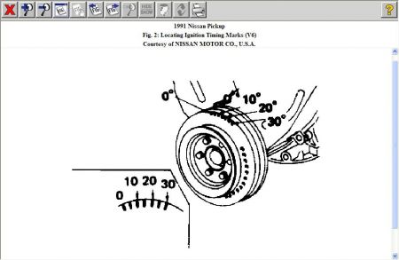

SQUAREVW
Engine Mechanical problem
1991 Nissan Truck 6 cyl Two Wheel Drive Manual 200k miles
I need to know the timing marks on the crankshaft of a 3.0 V6 in a 91 nissan pick-up
  • 75,988 POSTS
See below.
https://images.2carpros.com/forum/automotive_pictures/12900_n1_1.jpg
https://images.2carpros.com/forum/automotive_pictures/12900_nissan_V6_timing_marks_1.jpg
https://images.2carpros.com/forum/automotive_pictures/12900_nissan_1.jpg
Thank you for using 2carpros.com and have a nice day.
