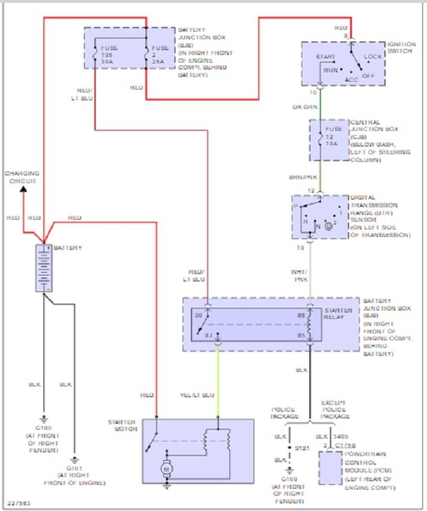

When I turn the key to the second position (accessory), the starter automatically engages and car starts without getting to the third position (starter). Car then runs fine, but when I turn it off I can hear that the starter is still engaged with the flywheel (grinding noise). Is this an ignition switch problem, a relay problem or do I need to replace the starter/solenoid?

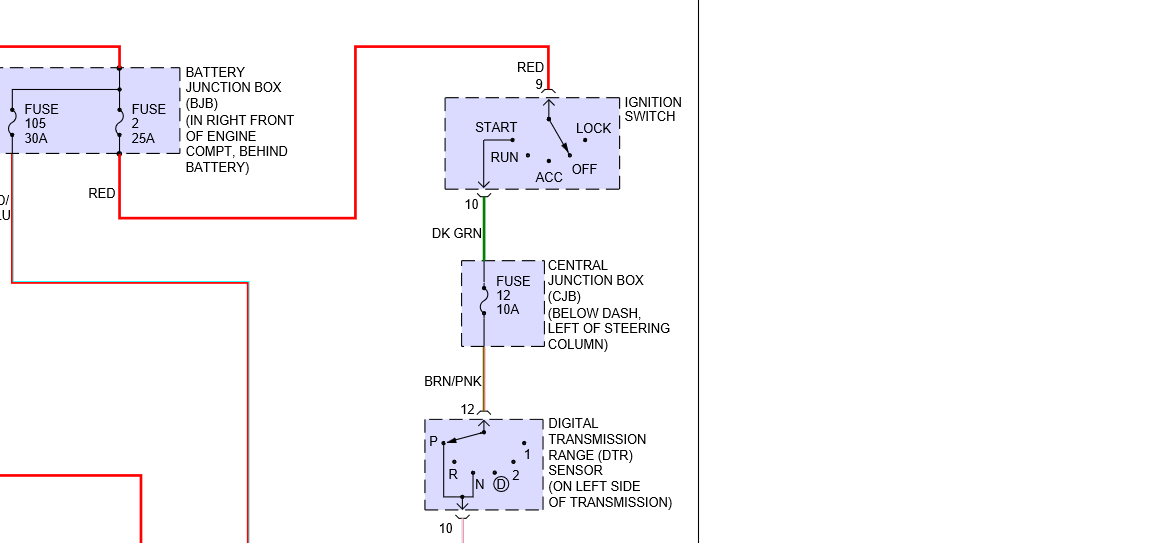

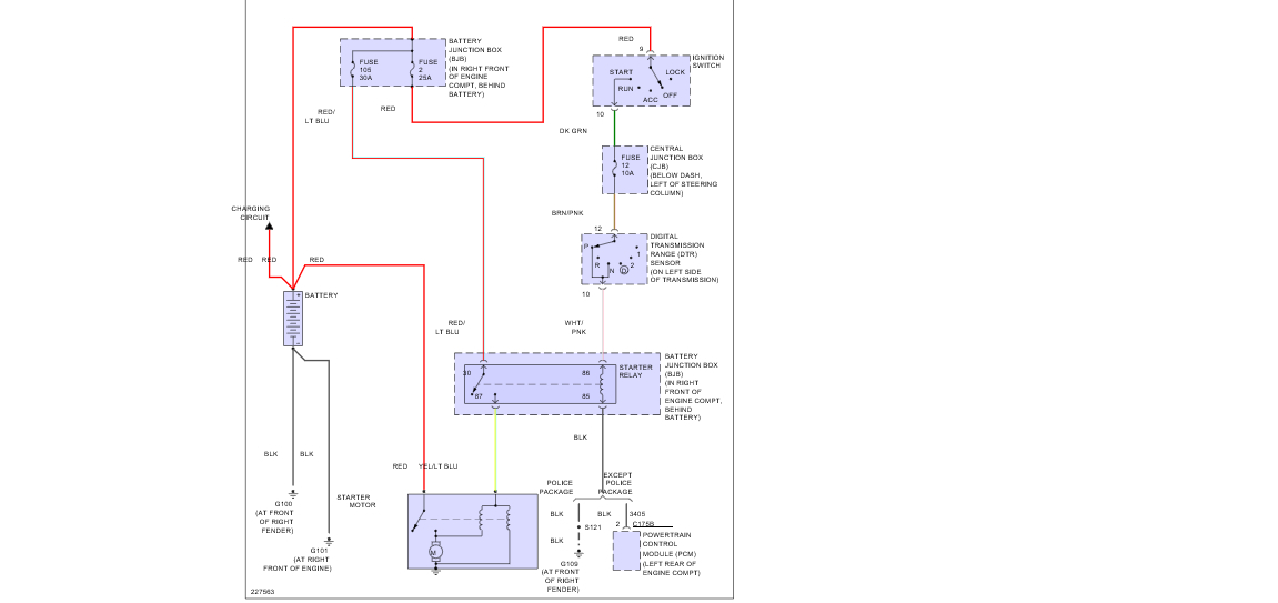

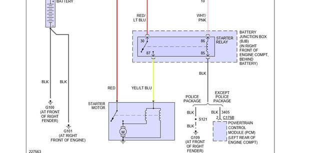

I got this diagram from "Prodemand".
Look it over AL514 (at the bottom).
My hypothesis is the hunk of plastic ignition switch itself.
If the relay were stuck, looks like it would run constantly key on or not (unless it gets a ground or hot that gets switched from elsewhere-which I doubt)
Other possibilities I could see is someone has monkeyed with the wiring recently or a wire has rubbed raw and is now shorted.
I am sticking with my first hypothesis.

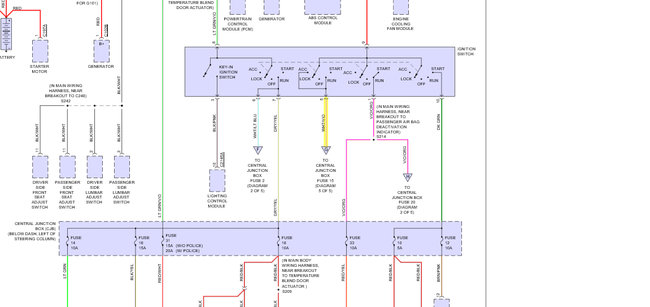

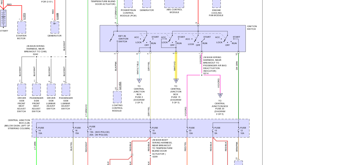

I think we need to start over here. Heres the diagram of the switch. So the car is starting is the ACC position correct? Which model Crown Vic do you own?
Oct 2, 2016 at 5:43 AM
AL514
  • 5,654 POSTS
The first issue to deal with is why you're getting starting power in the ACC position. You're grinding issue is because the starter is staying engaged all the time obviously and probably grinding everything to pieces down there.

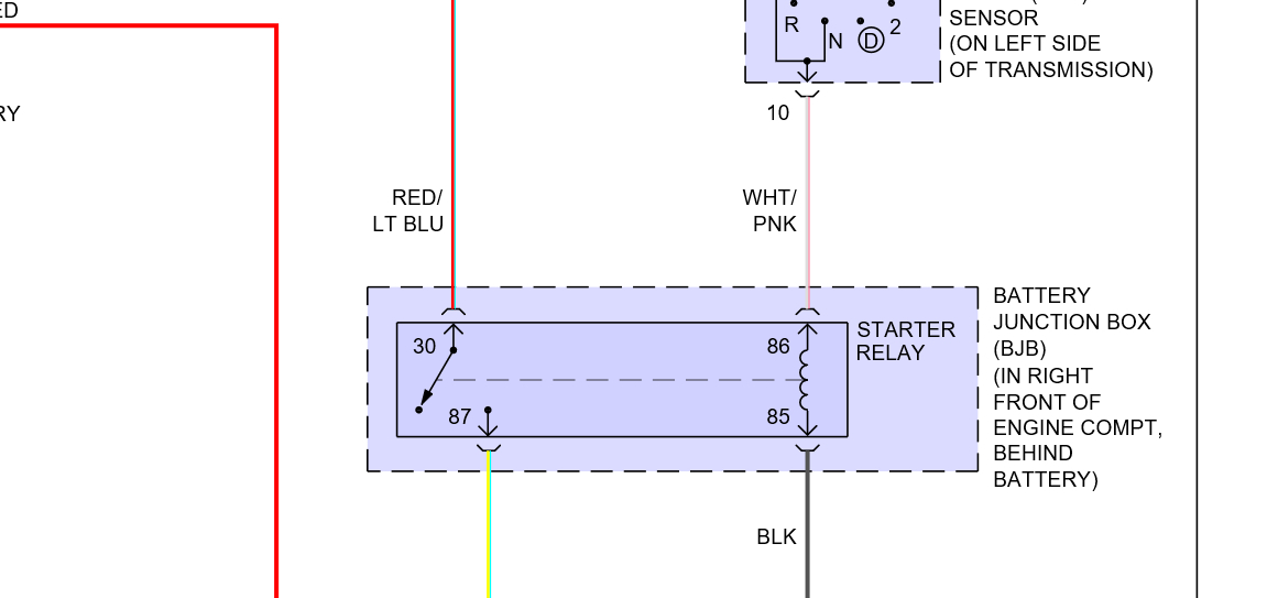

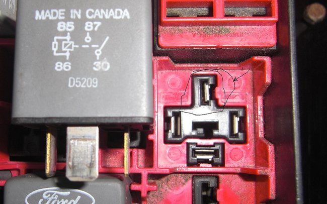

OK here we go, pull the starter relay, in the front of the engine compartment behind the battery and put the key in the ACC position...
Oct 2, 2016 at 6:11 AM
AL514
  • 5,654 POSTS
as you can see the pins on this relay are marked. With the relay out, and the key in ACC check for power at pin 86, this is coming from the ign switch. There shouldn't be any power there in ACC. Pin 85 is ground either threw the fender (on the police model) or threw the PCM (non police model). Pin 30 and 87 send power to the starter motor.
Oct 2, 2016 at 6:22 AM
ZOLATOY
  • 18 POSTS
THE ONLY POWER I GET IS IN THE TOP POINT ,THE OTHER 3 POINTS HAVE NO POWER IN THE ACC KEY ON POSITION
Oct 2, 2016 at 7:05 AM
AL514
  • 5,654 POSTS
flip the relay upside down, the pins will be labelled with a number
Oct 2, 2016 at 7:23 AM
ZOLATOY
  • 18 POSTS
OH....I GET POWER IN PIN 30 WEATHER IN ACC MODE (KEY IN) OR NO KEY...
Oct 2, 2016 at 7:31 AM
AL514
  • 5,654 POSTS
ok that's correct. Pin 30 should have power all the time. But you are not getting any power on pin 86 in ACC? pin 86 comes from the ignition switch and should only have power in START.
Oct 2, 2016 at 7:35 AM

NONE IN 86
Oct 2, 2016 at 7:39 AM
AL514
  • 5,654 POSTS
can you swap the relay with one just like it in that fuse box? I'm assuming the car doesn't crank with that relay out
Oct 2, 2016 at 7:49 AM
AL514
  • 5,654 POSTS
Pin 30 to 87 give the starter solenoid its power
