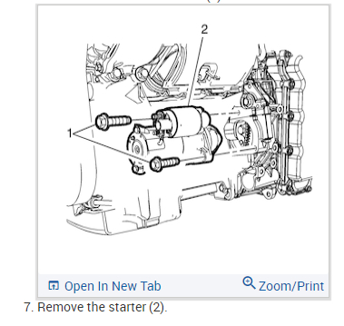

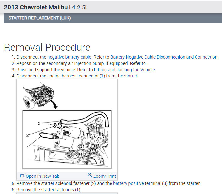

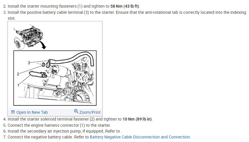

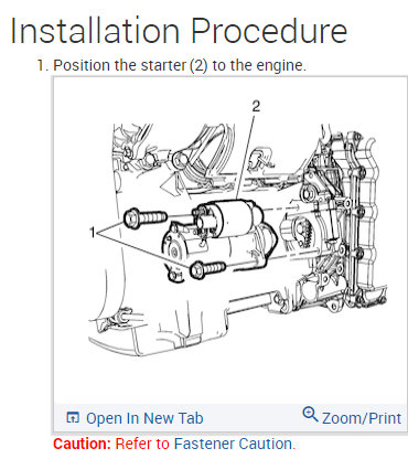

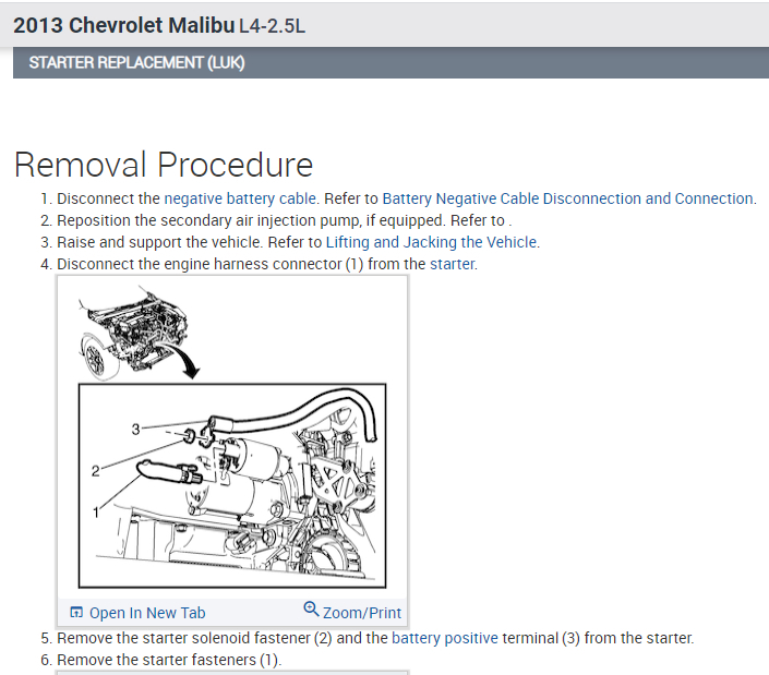

It sounds like you have a faulty starter motor solenoid which is built into the starter motor assembly causing the clicking, no start condition. Here are a few tutorials showing the operation of the solenoid and how to replace a starter motor:
https://www.2carpros.com/articles/how-a-starter-and-solenoid-works
I've attached picture steps below on how to remove and replace the starter motor on your car. Let us know if you have any further questions on this issue. Hope this helps and thanks for using 2CarPros.

Thank you for your help. My son and I used your pics and info and we got it done starts runs good!

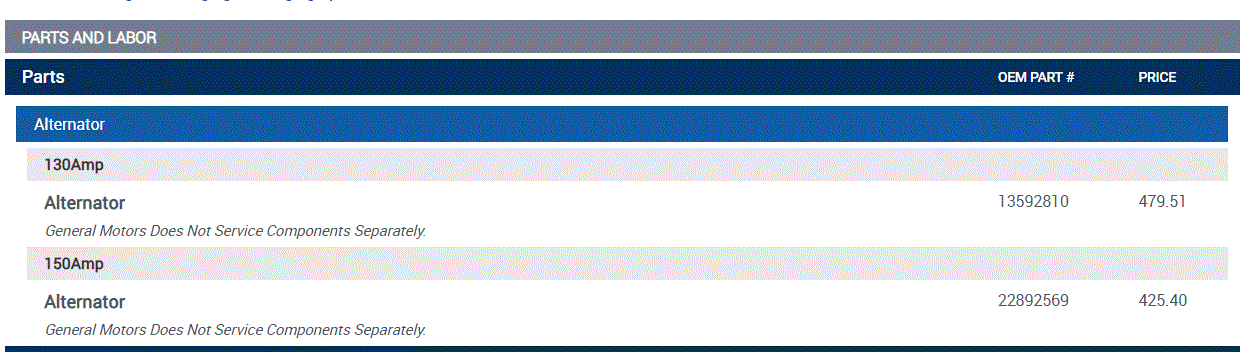

I thought when you bought a part and there was a core that was refunded back to the price. Now they add it to the price. It was 330.00 for refurbished part. They have lost their mind.
Thank you for your help. We couldn't of done it without you guys! Solved!

As far as the cost, wow!!! That is high. When you have a core, that should be refunded when you return the old part. Are you saying they charged you that amount?
I just looked on an AutoZone site and the prices range from $250.00 and up, which is extreme for a remanufactured alternator. If you look at pic 1, I attached prices for an original equipment part from a dealer. That is a retail price listed. Interestingly, there are two alts, 130 amp, and 150 amp. The 130 amp is more. Ugh!!!
Let me know if they didn't refund the core charge. That doesn't make sense.
