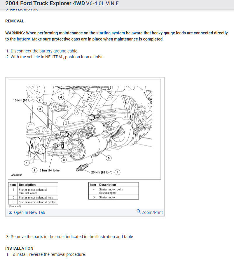

So, I just got done replacing my transmission on the vehicle listed above and when I go and try to start the car the starter doesn’t engage the fly wheel it only spins. Checked the battery, and it has 12.2 bolts which is pretty low, so I tried jump starting it with jumper cables but no luck. it still the same the starter just spins but doesn’t engage the fly wheel. I also took the starter to get tested at an auto parts store and they said it was good, but I have a feeling that they just seen the starter spin but not jump out like it supposed to and just said it was good. not sure though. I may have to go back and confirm that it does stick out but if it does, I’m not sure what it could be now. Also, by the way, the starter is only like 3 years old and battery maybe like 2 years old, but it went low because car was sitting for a while.

There could be couple of reasons. It is possible that the starter is spinning but the shaft it not extending to meet the flywheel. Another possibility is that the starter is doing what it supposed to, but it is unable to 'reach' the flywheel. Many times, on these vehicles you will have to use shims on the starter for it to make connection to the flywheel.
https://www.2carpros.com/articles/how-a-starter-and-solenoid-works
You can simply apply 12V to the starter and see if it is extending.
Let me know what you find.
Oct 2, 2021 at 2:08 PM
  • 110,240 POSTS
You can remove the starter and check it using jumper cables. Place the ground on a metal portion of the starter housing such as where the bolts go through to attach it.
Carefully place the positive on the larger bolt on the solenoid. Once both are attached, use a screwdriver or jumper between the positive and the smaller connector on the starter. That will energize the starter and the Bendix should kick the gear out and it should spin.
Note: Be careful not to short the jumper wires.
If it does, the starter is good. If the flywheel is good, something is causing too much clearance. Make sure the starter is fully seated. If there are shims being used, remove them to eliminate space.
I don't know if you need them, but here is a link that explains, in general, the procedure for replacement.
Oct 2, 2021 at 2:13 PM
