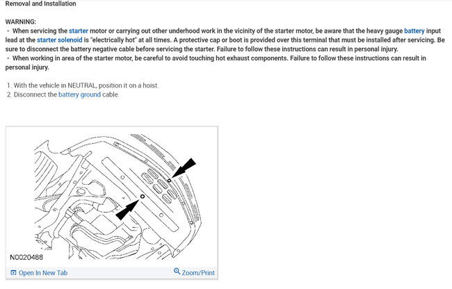

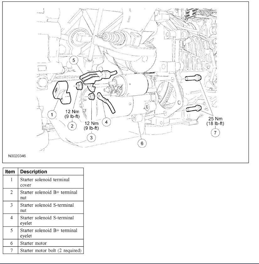

The starter wouldn't work. Banged on it (old school). It worked but didn't the next time. I took all proper steps to remove it but it won't separate from the engine. Someone told me the Bendix gear might be stuck. thought I might be able to manually rotate motor to maybe free it if it "is" stuck on the flywheel, but I don't quite see how I can do that. Camshaft pulley nut very difficult to get to.
Aug 14, 2023 at 10:40 PM
  • 55,423 POSTS

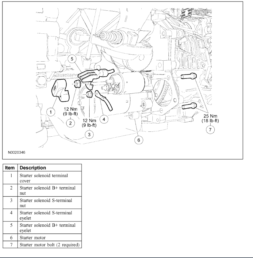

I would hammer and contact the body of the starter, it is just stuck, it will come out. Here is a generic guide to help you step by step with instructions in the diagrams below to show you how on your car. Make sure you have all three mounting bolts out.
