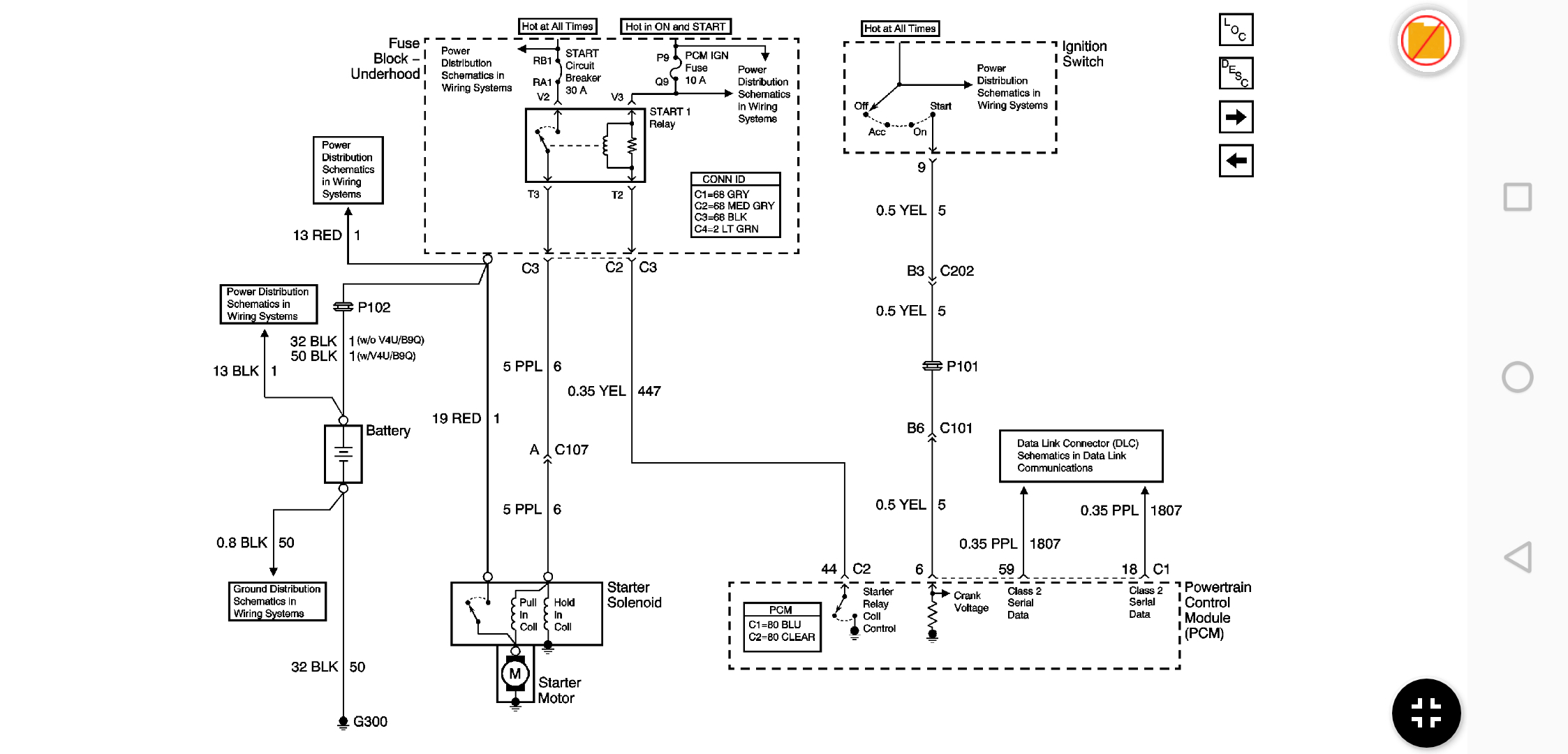

Have replaced battery, starter circuit breaker in under hood box. When you engage to start mode on the switch, nothing happens (no noise) but all dash lights light up in the on position.

Okay, then checking for power at the starter would be the next step. I don't think on that model those indicator lights are going to effect the starting circuit. But you should definitely make sure you have the correct coolant level for normal running conditions. I added a diagram for the starter circuit. If those 2 lights haven't been on before this problem started, that could be an indication of a PCM issue or a bad ground wire. The PCM is responsible for grounding the starter relay. Does the check engine light come on for about 2 seconds when you try to start it and then go off? it should. (PCM IGN Fuse # 10 is power for the Starter Relay) so is (Start Circuit Breaker 30Amp) Start 1 relay is the starter relay.
