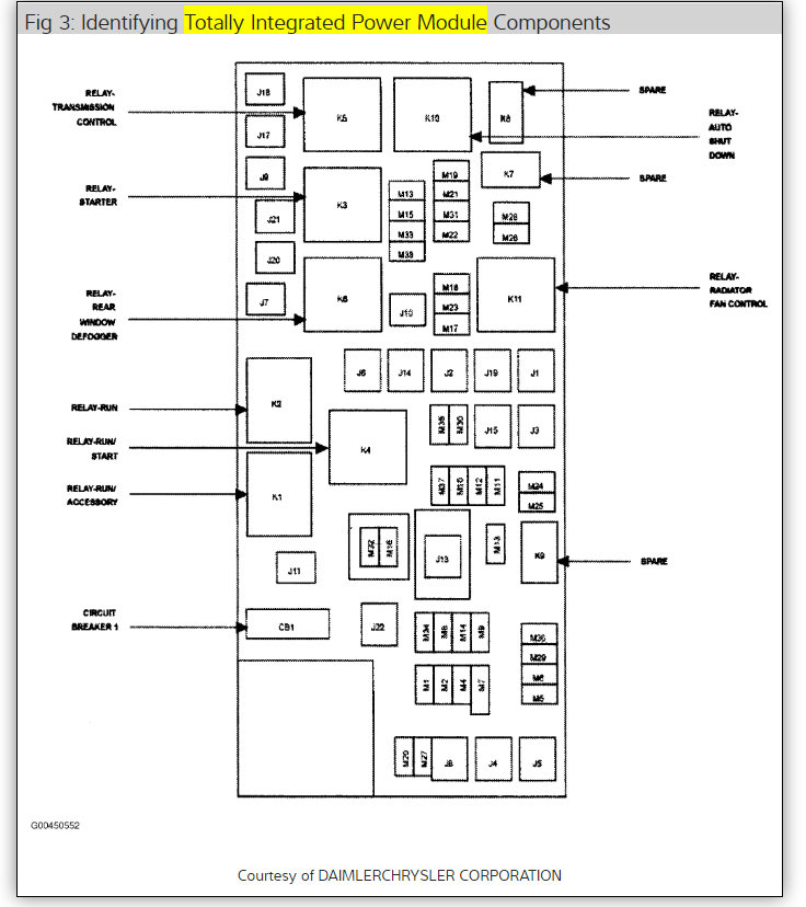

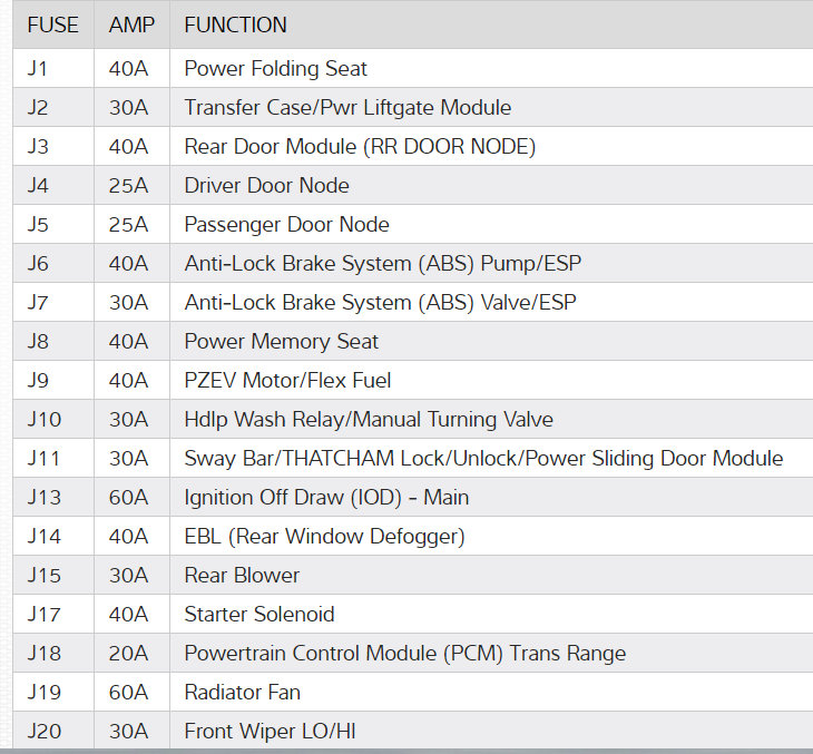

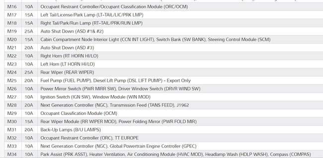

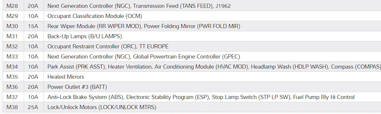

CARADIODOC
  • 34,383 POSTS

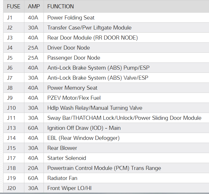

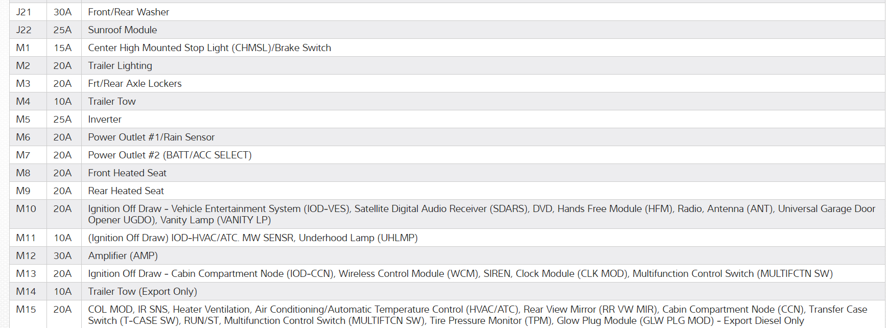

No fuel pump relay. It is switched on by the TIPM through fuse M25, a 20-amp fuse. Look for the two test points on top of that fuse. You can check for voltage there, but remember, it will only be there for one second when the ignition switch is turned on. That means you'll need a helper to run the switch while you watch for voltage. A test light works best for this because most digital voltmeters don't respond fast enough. Check for voltage on both sides of the fuse. If it appears briefly on one side but not on the other, that fuse is blown.

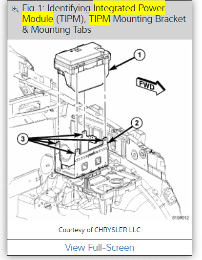

  • 55,433 POSTS
Here is a guide to help you check for power at the fuse and the fuse location as well:
