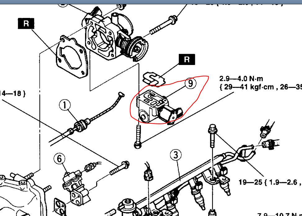

Whenever I turn the wheel the idle drops and sometimes shuts off. Doesn’t happen when cold only when at operating temperature.i recent had the water pump replaced not sure if this has anything to do with it?

Since you just had work done, I suspect you have a vacuum leak. Here is a link that explains how to locate and repair one:
and
https://www.2carpros.com/articles/engine-stalls
If nothing is found, the next suspect would be the idle air control valve. This component is what is responsible for maintaining idle speed. When you place a load on the engine such as from the power steering, the IAC adjust engine speed to compensate.
IF you look at the attached pic, I circled the component. It is on the throttle body. Check to make sure nothing is disconnected or damaged there.
Honestly, since you just had work done, chances are it is a vacuum leak rather than the IAC. Check that and let me know if it helps.
