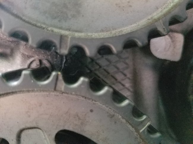

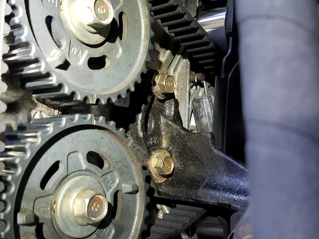

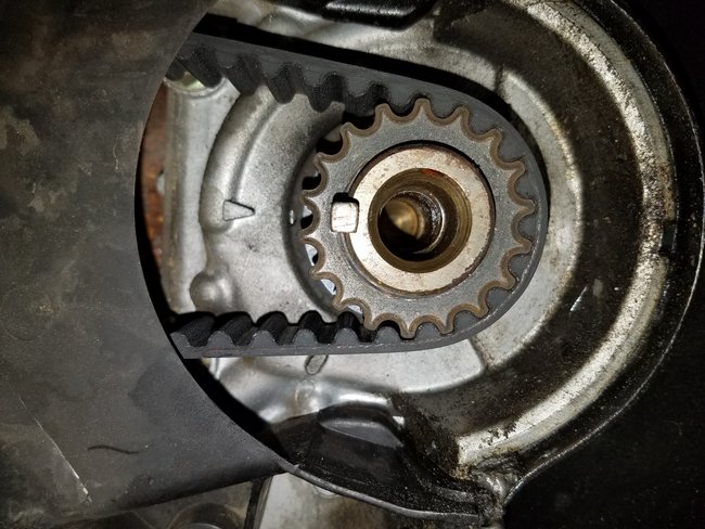

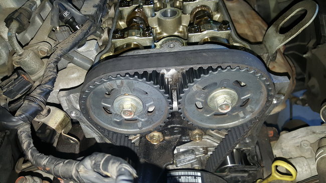

BETHWAH
  • 17 POSTS
Here's some pics!
Aug 4, 2020 at 5:18 AM

  • 55,797 POSTS
It looks like there are more marks on the cam sprockets. You are looking a dot I believe. There are two lines on each one so I don't think you are on the right ones. Can you take a picture of the entire sprocket please?
Best, Ken

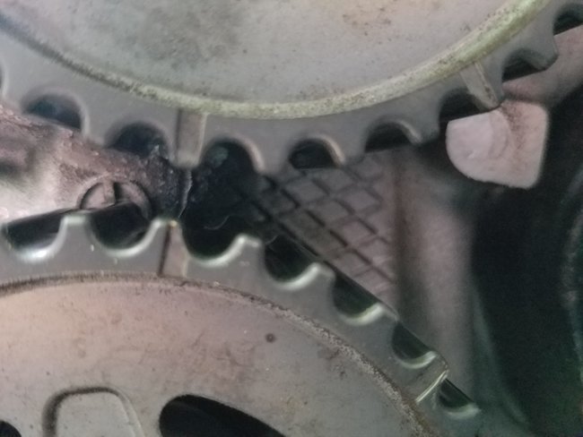

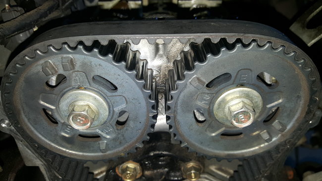

BETHWAH
  • 17 POSTS
Hey Ken, Hard to get a good angle on it, how's this? PS... Now the car will not start at all. Tall building, here I come :(

  • 55,797 POSTS
Yep I see a dot on the gear on the right, do you see one on the left? This is the marks that should lined up I would think.
Please let us know what you find ;)
BETHWAH
  • 17 POSTS
Thanks, line up with what? I/E are at top with marks meeting in the middle. Am I supposed to do something else with the dots? For giggles I did line them up in the middle yesterday, but it wouldn't start. All other marks are off if I do that though.
  • 55,797 POSTS
I see, you are okay with the marks, I took a closer look at the diagram so the way you have it is correct. So it runs but it dies at idle or?
