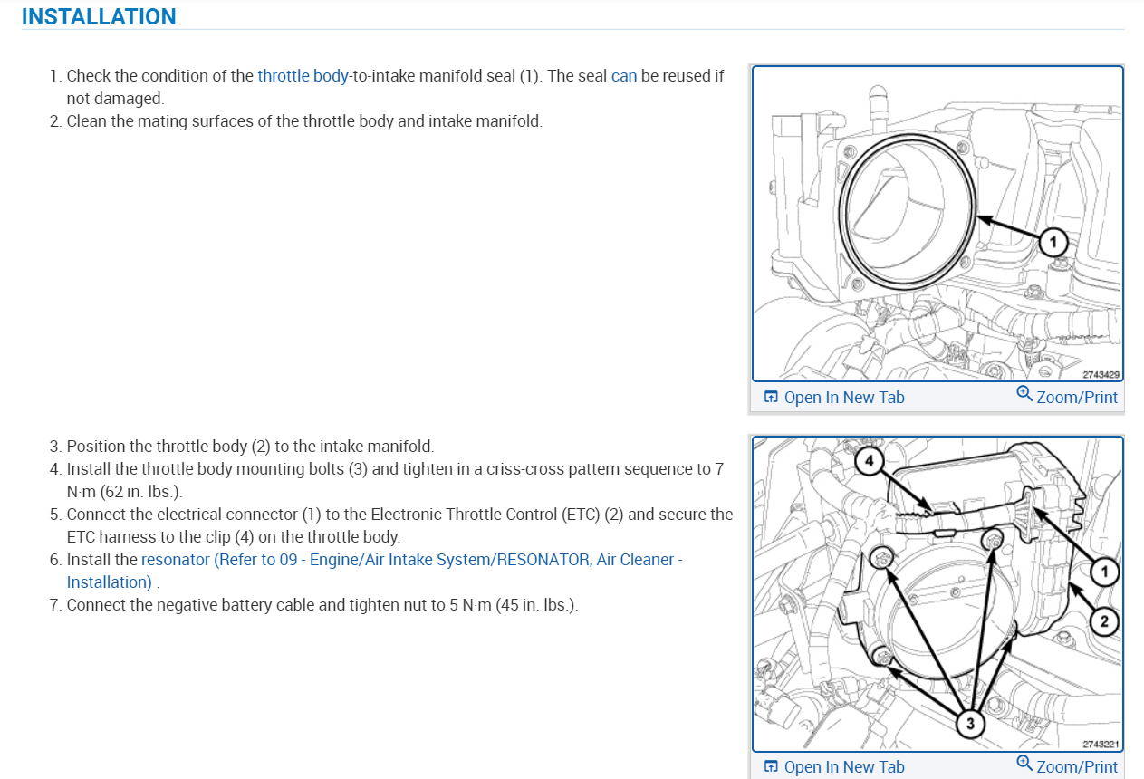

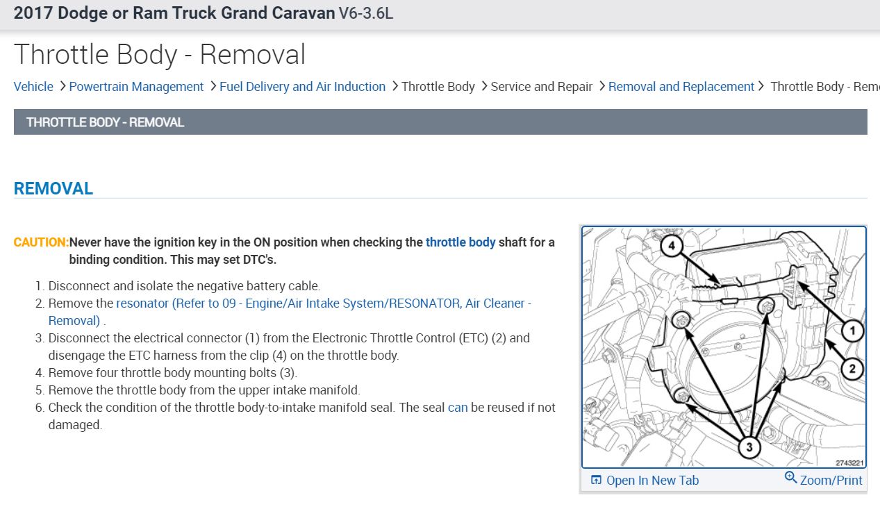

Yes, this is common when the throttle bore gets dirty, you are in the mileage range for this issue. What happens is the air going into your engine is not perfectly clean so after a while the air impurities build up causing idle performance issues, fortunately this is an easy fix. Please follow this guide and video (read all before you begin) which should fix the issue. I will leave instructions for your car in the diagrams below.
and
https://youtu.be/Ui8zhMLp5EM
Please run down this guide and report back. Let us know what happens and please upload pictures or videos of the problem.

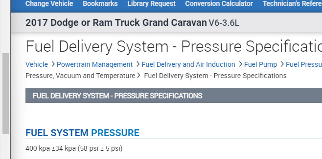

First, we need to check the fuel pressure when this happens.
You should have around 60 PSI of pressure all the time.
