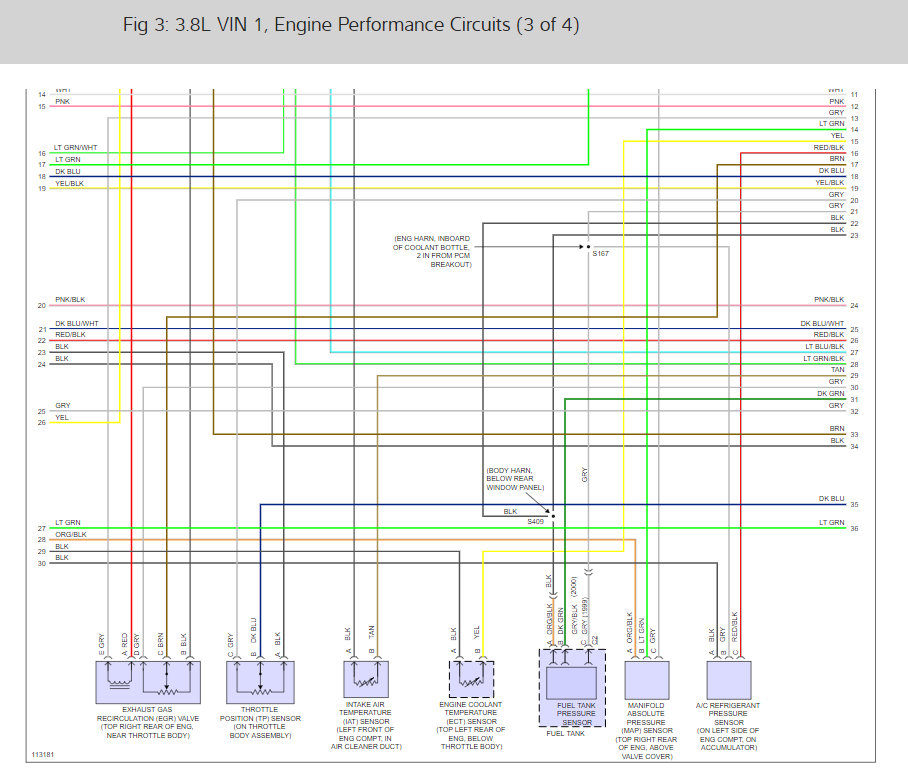

So how do I check the map circuit?
Apr 13, 2019 at 3:54 PM
  • CERTIFIED EXPERT
  • 53,872 POSTS

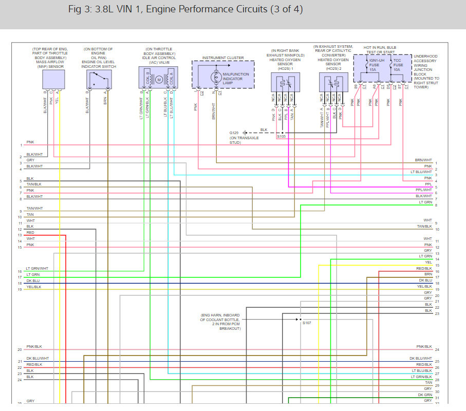

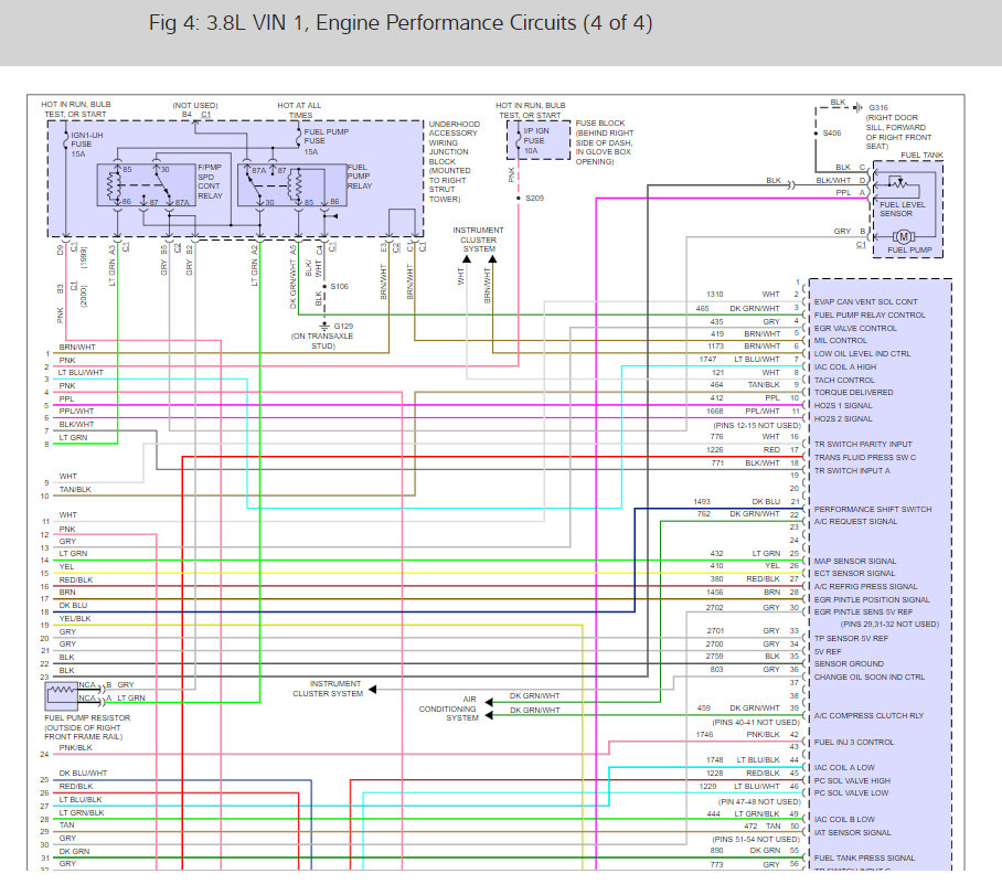

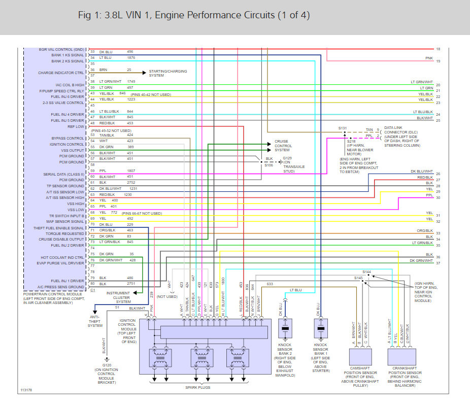

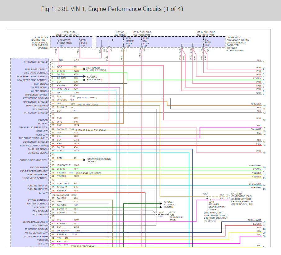

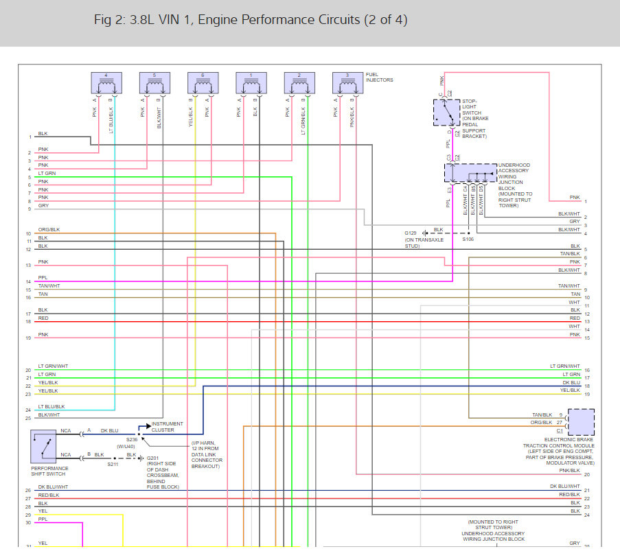

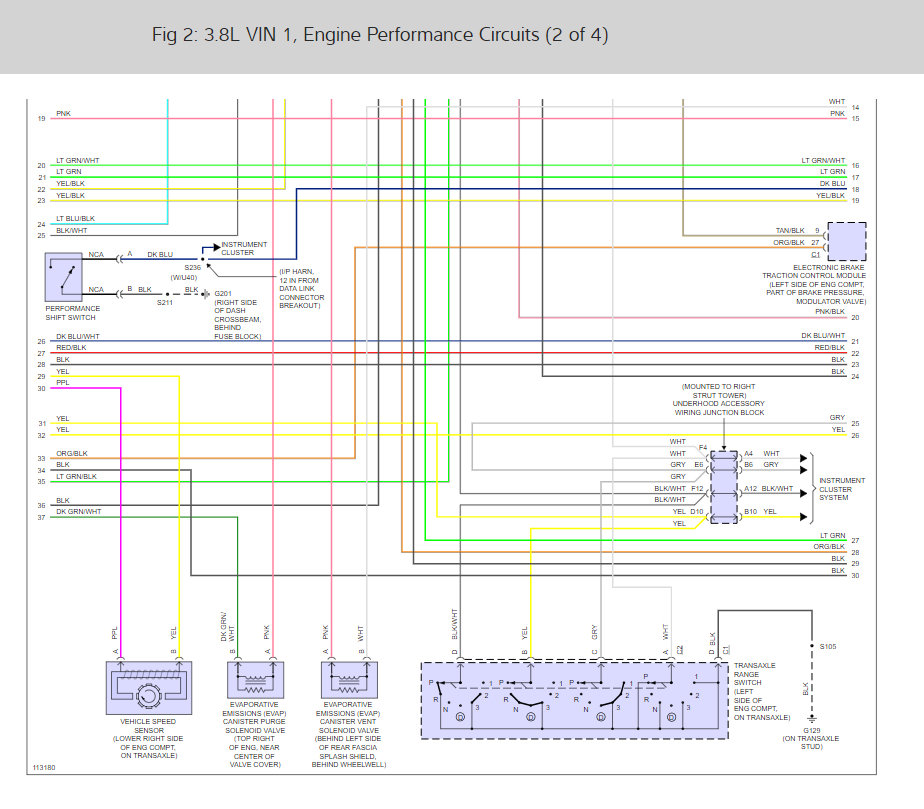

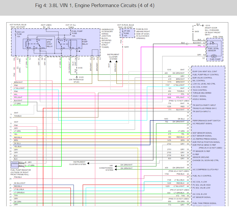

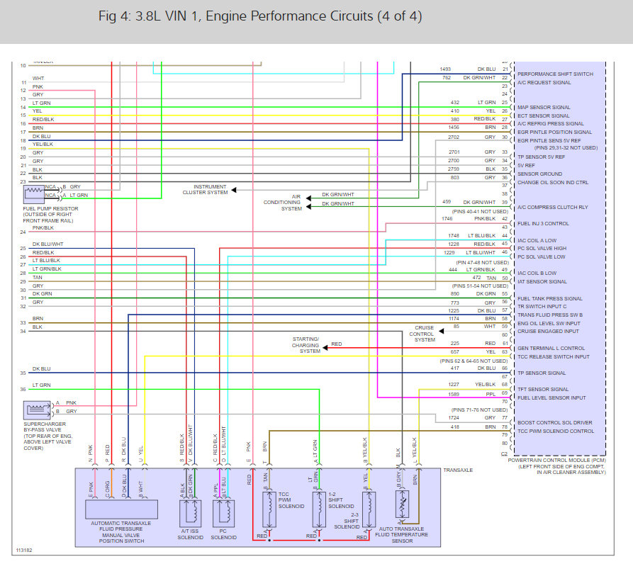

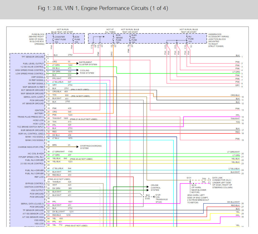

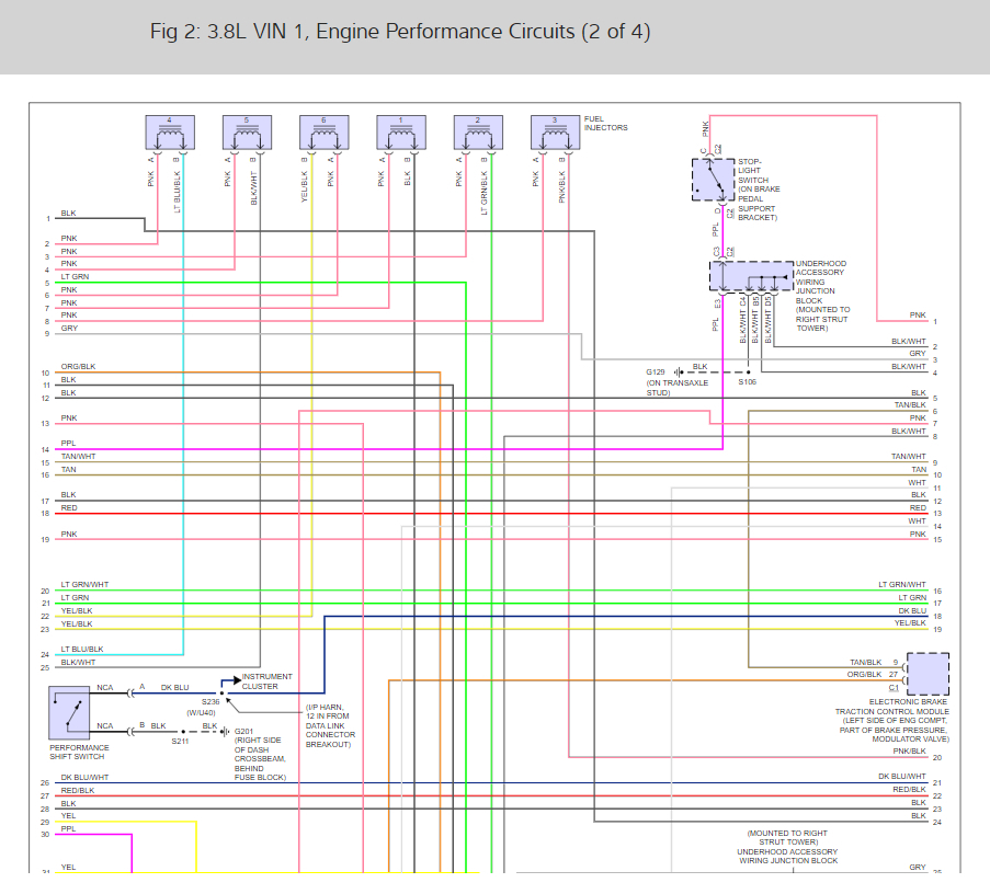

Here is a guide to help you test the MAP sensor circuit and the engine wiring diagrams so you can see how it works:
