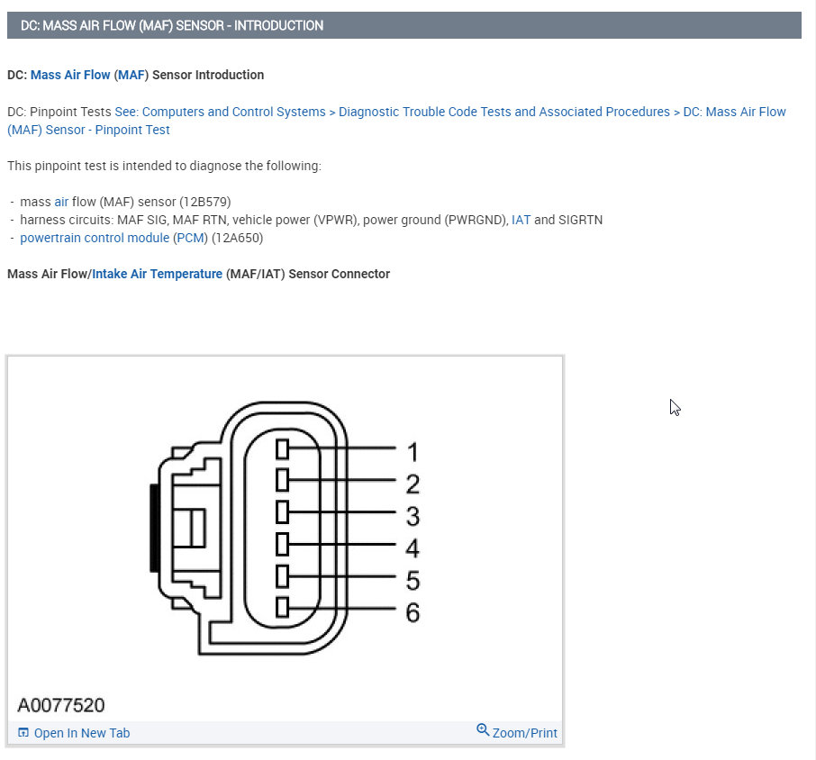

Attached is the procedure on how to replace the ECT sensor.
As for the issue, have you replaced or cleaned the idle air control valve? This is responsible for allowing enough air into the engine during idling. This valve can cause other issues but they don't exactly match yours. However, you need to remove it and inspect it or replace it to ensure it is not your issue.
Let me know and we can go from there,
https://www.2carpros.com/articles/how-to-replace-an-idle-speed-control-motor-iac
https://www.2carpros.com/articles/symptoms-of-low-engine-power

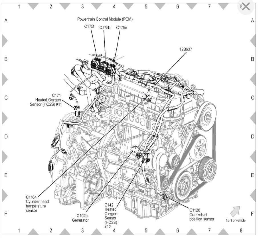

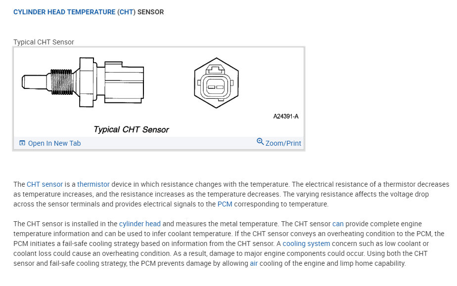

I have replaced the engine coolant temperature sensor already (ECT). The one I need help finding is the cylinder head temperature sensor (CHT). I’ve researched my engine and it requires both of these sensors to work in conjunction. Also, I have taken the IAC valve off and completely cleaned it. I don’t believe it’s the issue.

Please see attached. Let me know what happens and we can go from there. Thanks

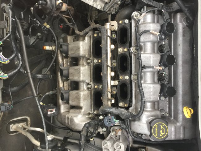

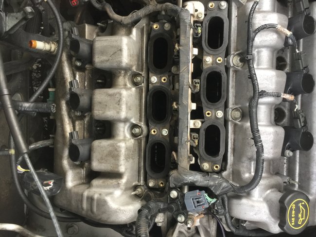

Still having trouble finding the CHT. Can’t put it in place according to the diagram you provided. Here’s pictures of my engine with the intake manifold off. I’m not a skilled mechanic so I do not want to remove stuff that is unnecessary. What exactly do I need to remove to expose the cylinder head sensor?

Is it possible you can send me your VIN? I am finding conflicting information. It looks like the 3.0L is not equipped with a CHT but I find one listed on parts sites. I am thinking we have a terminology issue because the info I sent was for a 4 cylinder (according to the picture) but it was listed under the 3.0L.
If you can send your VIN I am going to have one of my Ford dealers look it up and get VIN specific information.

Okay. So I had one of my Ford dealers confirm that this engine does not have a CHT which is why you can’t find it.
