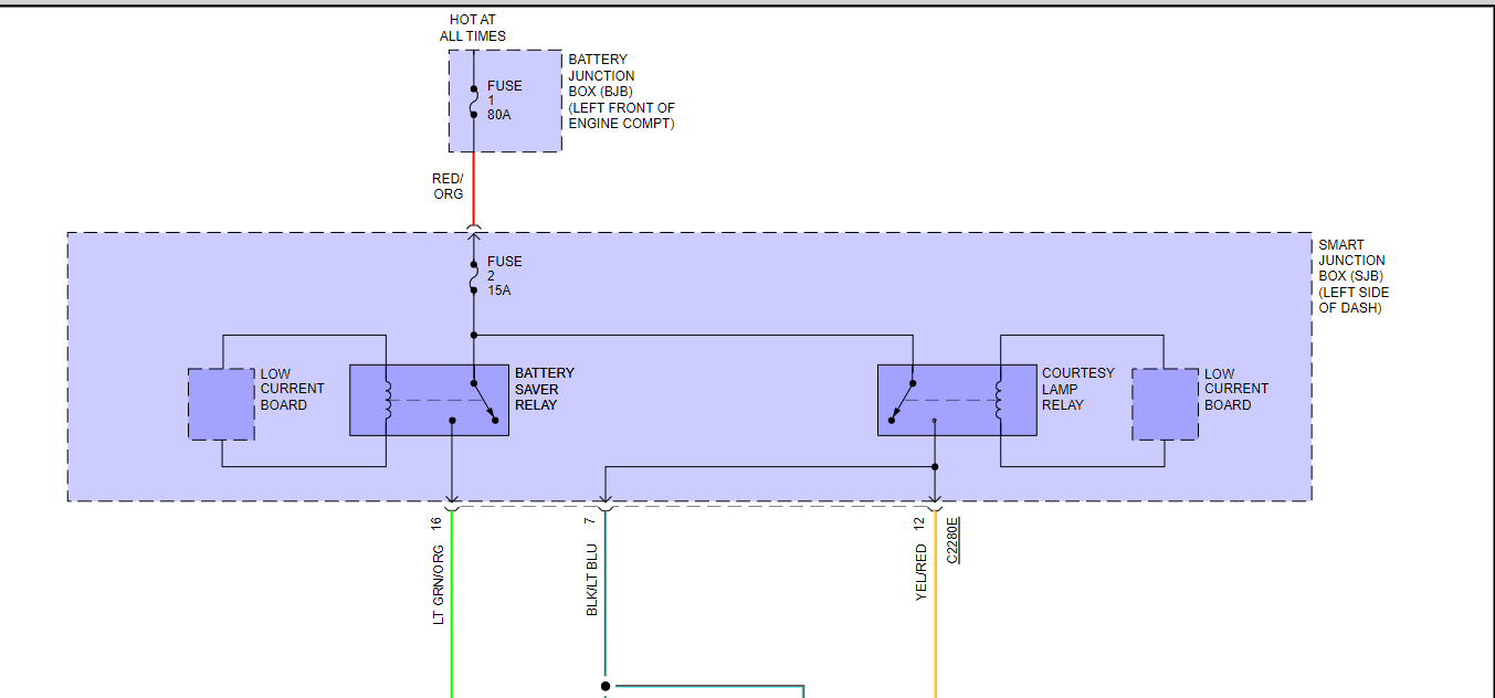

I feel your frustration, if you didn't find that harness fault on the ac line, I was hoping that's what it would be. I believe there is a battery temperature sensor on this vehicle, but I can't find any diagrams or information on it. This could be an ECM failure too considering the ECM is directly in control of the charging system. Check one last thing for me. Check the back of this Junction box on the driver's side dash, there are current detecting circuits in these junction boxes that the ECM watches.

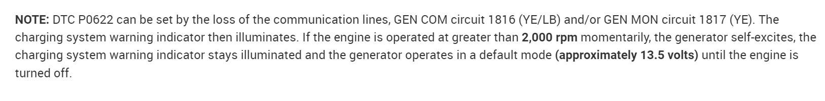

I'm not sure if your scan tool has an oscilloscope on it but you could also watch the two wires on the alternator, the yellow/light blue (Generator Comms) and the yellow (Generator Monitor) and see if any signals are dropping out.

If you had a P0622 setting you would know that communications on one of the alternators wires were being lost. If you don't have that code, that can indicate it's not an alternator fault. But definitely run a full system scan and see if there are any current or history codes.
