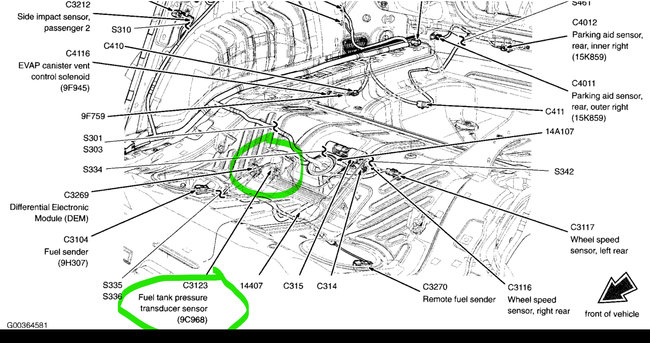

Hello everyone, I'll try to make this as short (yet detailed) as possible. The car stalls about 5 seconds after start up but will repeatedly do the same thing. I have replaced spark plugs, throttle body, fuel pressure sensor, and air filter. The only MIL code I'm getting with my Autel mk808 is p0453 Evap system pressure sensor/switch 'A' circuit high. After a few tries I decided to delete the existing DTCs and it started up and idles/drives great. Drove about a 16-mile trip and parked it (no MIL on). Once it was turned off and as soon as I try to restart it it idles perfect, but the code comes back on immediately. So, I assumed it was just some Evap thing going on and didn't worry about it. Well, two days later I went out to try and start from a very cold condition and the same thing started and ran for about 5 seconds and shut off. I have repeated this process two times or more and the same thing, if I delete the code, it'll seemingly drive cross country until I let it sit for a day or some and then same thing. Would this code actually cause a stall issue (I have done a lot of mechanic work and have never seen this issue)? I know if the code is there, I need to fix it regardless but I'm just making sure that sensor or wiring to the sensor could be my main culprit and hopefully resolve my issue. Thank you very much for any and all help you can give me and have a blessed day.
Jan 23, 2022 at 8:26 AM
AL514
  • 5,587 POSTS

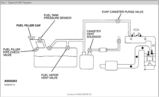

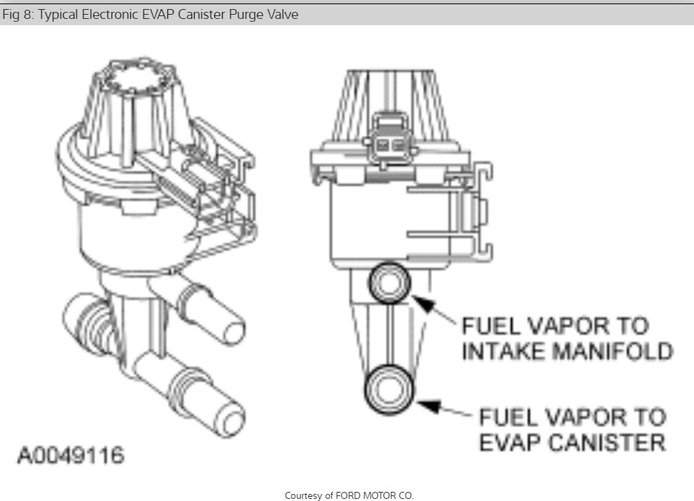

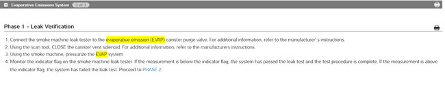

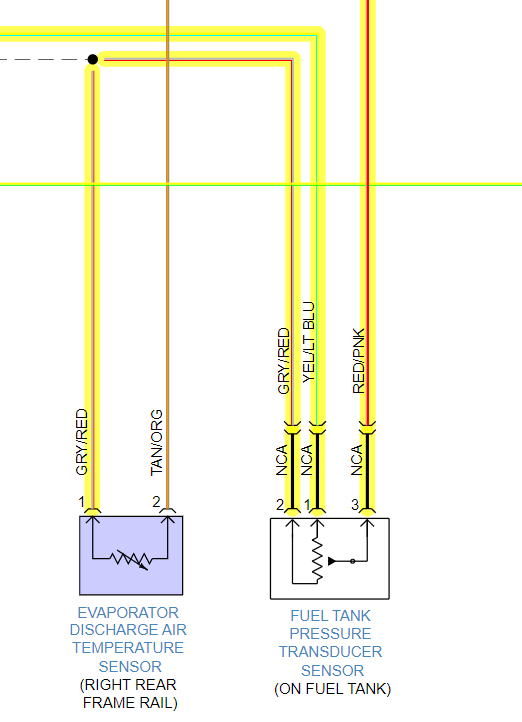

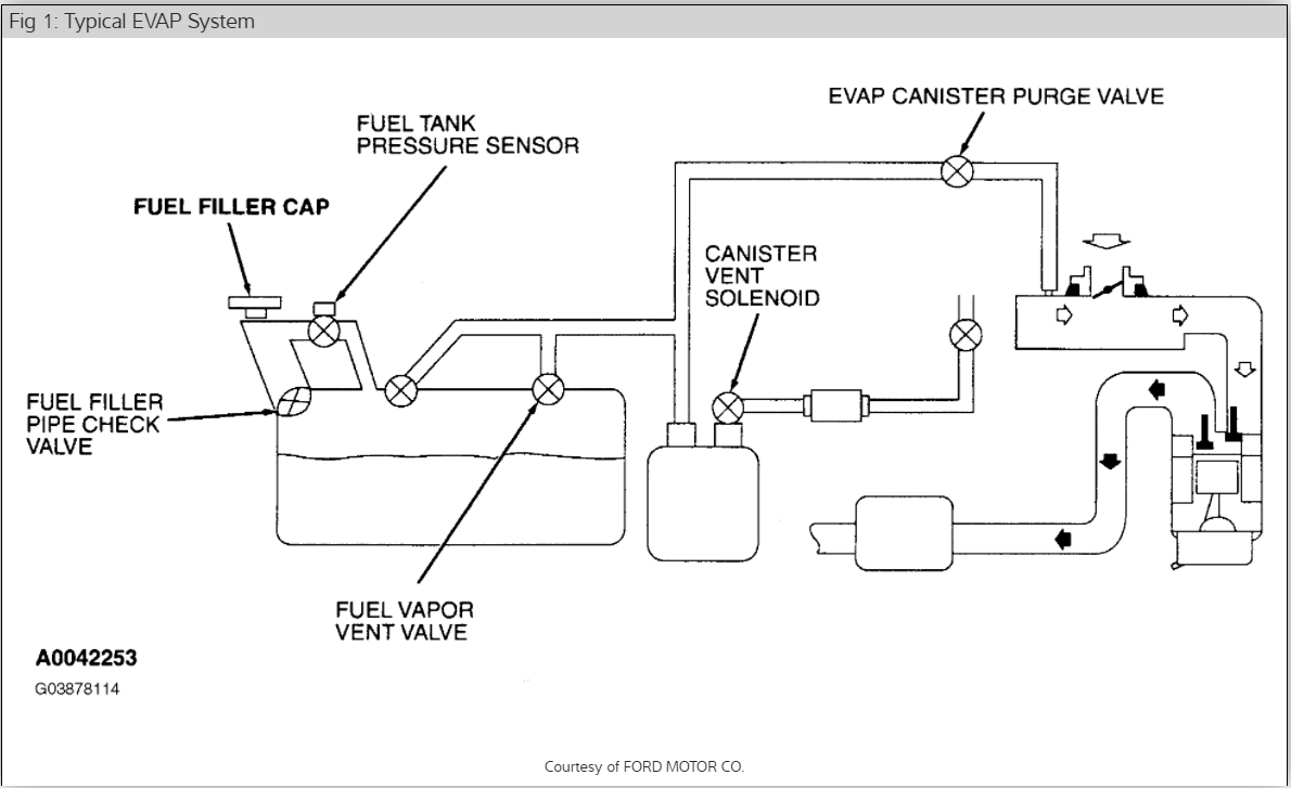

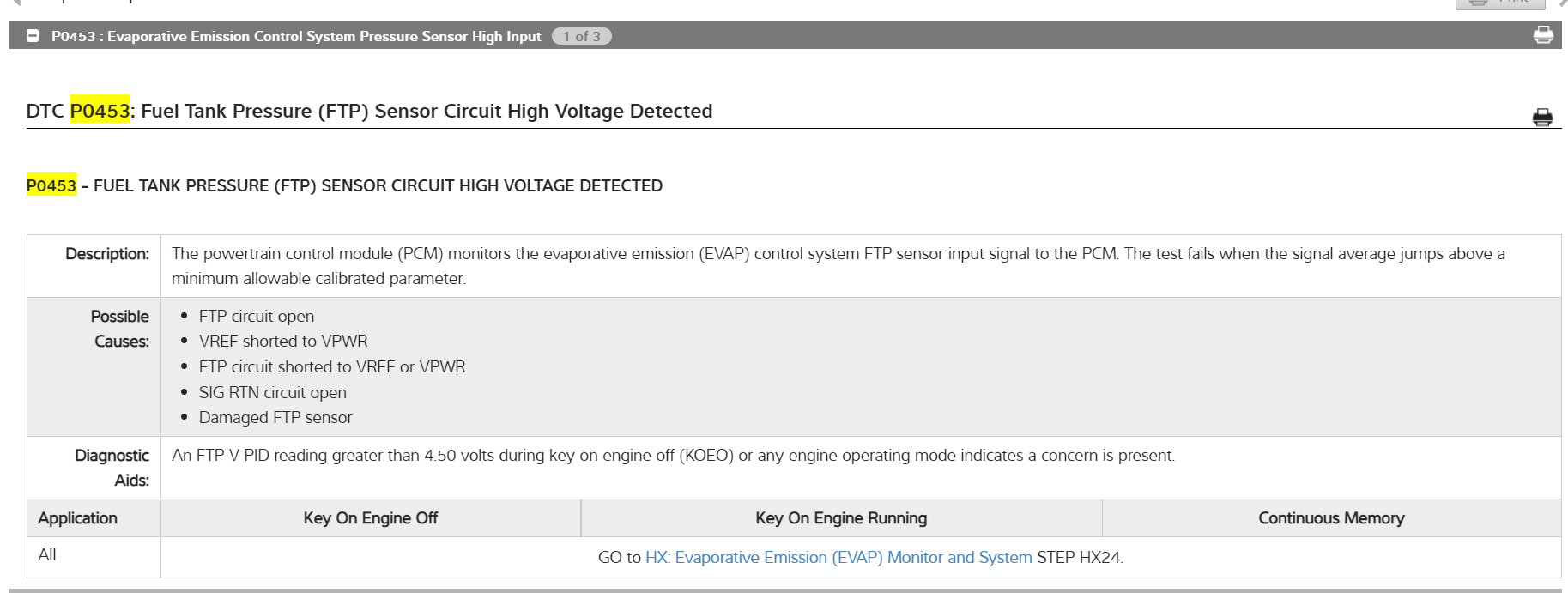

Hello, this code is for the Fuel "Tank" pressure sensor. I stress the tank part because some people get it confused with the fuel rail pressure sensor. And yes, it is part of the Evap system, these sensors are extremely sensitive, especially on ford setups. Ford has a completely different evap system and it runs its self-tests differently than any other manufacture. The sensor is located on top of the fuel tank, fortunately for you, you can remove the rear seat to get to it instead of dropping the tank. So, the code is for Sensor High Input, meaning the signal is sending to the ECM is higher than it should be. This can be caused by a number of things, bad ground, short to reference voltage etc. What I would do before you go taking the seat out, is when it stalls again. check the reference voltage at another sensor. The easiest place would be at the Fuel rail pressure sensor. Where the fuel injectors are. Ill post wiring diagrams, because if the reference voltage is being pulled down by a shorted sensor, you'll know right away which sensor it is and what's going on. It may be setting the code for the Tank pressure sensor because they are so sensitive. It would be the first sensor to have an odd signal. So, the first diagram is for the Fuel Rail Pressure sensor. and just make sure there's a full 5 volts on this wire with the key on. The last diagram is the Fuel Tank Pressure sensor. The yellow/blue wire is the 5-volt reference wire, the grey/red is the signal return (ground). and the red/pink wire is the signal back to the ECM. The Ford systems run a total of 4 or 5 tests on the evap system at various times, it has to pass the first 2 vacuum decay tests to go on to the Vapor Generation tests. So, it is pretty complicated. It took me awhile to learn it all honestly. But this could be a bad ground, missing 5 volts, or bad signal at the ECM, or just a bad sensor so you'll have to do some testing with a multimeter at the sensor to be sure. I will post more information here and if you have any questions on testing let us know.
The reason it's setting the codes every few drive cycles is because that's when it will be running its self-tests.

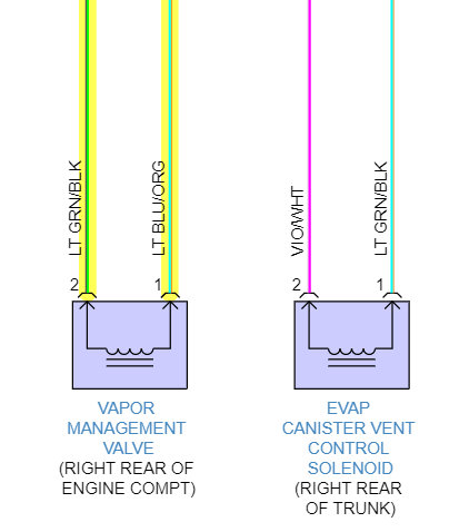

This code also be a Canister Vent valve or Purge valve that is stuck open and that's why it's stalling out. The main cause of this code on Pro Demand seems to be the wiring harness back at the sensor itself, so you will have to pull the rear seat eventually and check out the wiring harness. You can find the sensor by wiring colors for it.
And since you mentioned you have an mk800 you can start by actually checking the data PID for the sensor. anything over 4.5volts is a concern. Thats with the engine running.

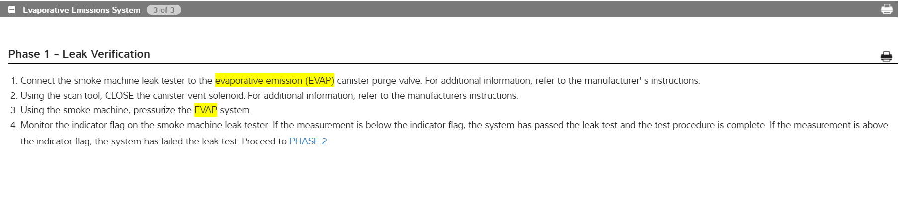

Another real quick test is to disconnect the purge valve and block off the intake manifold line to it. If the stalling stops, you know you're getting flow when you shouldn't. The last diagram shows the purge valve wiring colors. It's located in the engine compartment.

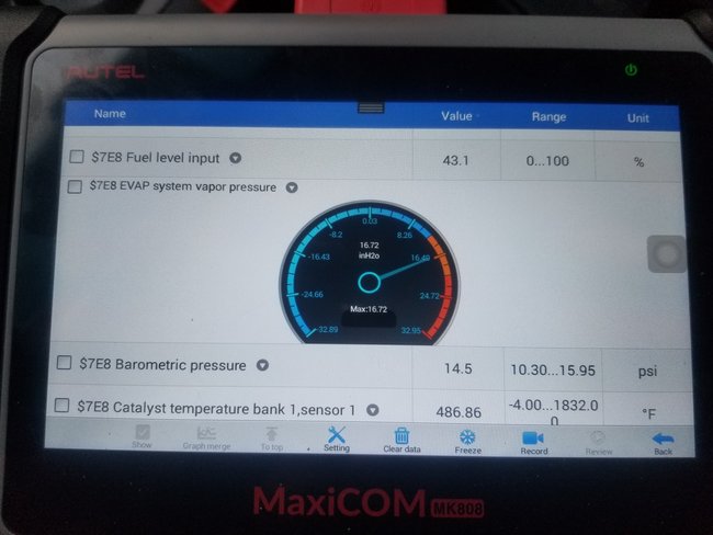

The barometric pressure is correct. The atmosphere is about 14PSI. So that's correct, the Evap system vapor pressure is measured in H20, (water) this is because it's a wider range of pressure to be monitored. 16 inH20 is about 0.5psi. so very low. Also, just FYI, if you go to take the Fuel Tank Pressure sensor out, make sure you don't have a full tank of gas.
So, is it not drivable now? Just start and stall? If that's the case, the first thing I would do is block off the purge valve from the intake manifold and see how it runs. I'm wondering if your charcoal canister is full of liquid gas instead of just fuel vapors.
The vehicle usually won't purge at cold start up, but all systems are different. While the system is purging the Evap it also opens the canister vent valve and draws a small amount of oxygen from the vent valve that mixes with the fuel vapors and then is pulled into the intake manifold. If the charcoal canister is full of liquid gas and pulling liquid gas into the intake due to a failed purge valve that could flood the engine right out. Maybe take a look at the sparkplugs and see if they're fouled out. I'm going to take a look through the TSBs for any information on Recall notices.

Okay, again thank you for the help. I had the car dropped off yesterday and was able to do some testing. Today I was again able to test I did the blocking off of the intake hose from the Evap test, with no change. Also, I went again at it with my scanner and was able to figure out this (attached image) using the hot functions live data. All other values read no fault this was the only one that said there was a fault in real time. I'm not sure as to where this is located, possibly in-line somewhere near the Evap system but to be honest I haven't even got a chance to look yet. Thanks again and I will get back to you with anything newfound. Not sure if there is a way to test this or not, please let me know, thank you very much again.

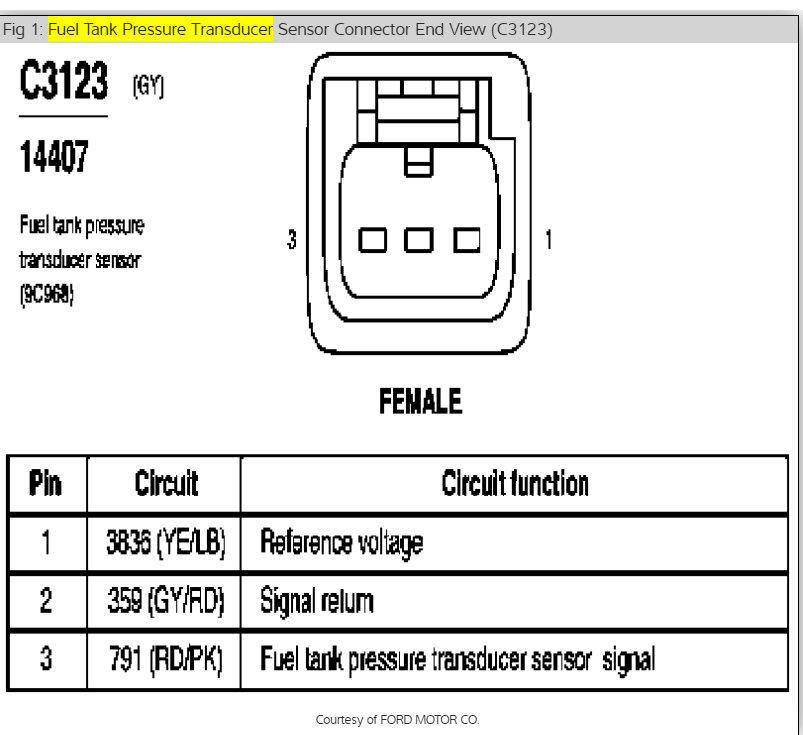

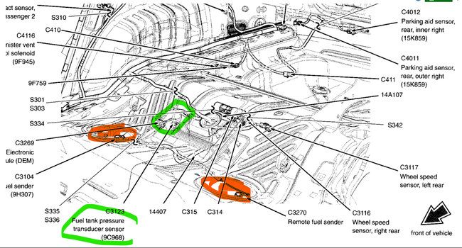

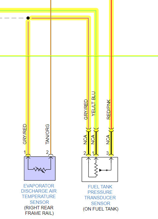

Going back to your previous post with the EVAP system vapor pressure dial reading, that's where that reading is coming from, The Fuel Tank Pressure sensor/transducer. Looking at it again, notice that it's in the orange range, almost red. I'd say that's where your fault comes from. You should be able to take the gas cap off and the pressure in the fuel tank should drop to 0 on your Scan tool. If the Tank Pressure sensor is reading higher than 0 you can release the pressure that way. If it doesn't drop to 0 there's a problem with it. It's on top of the gas tank.

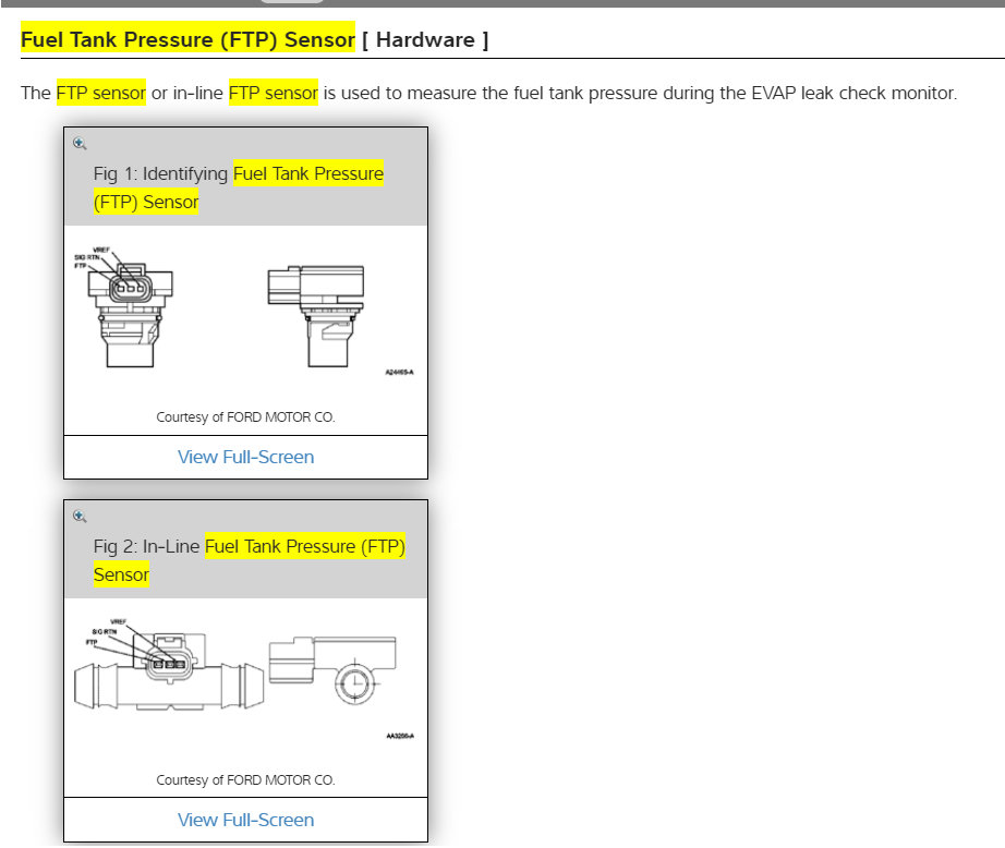

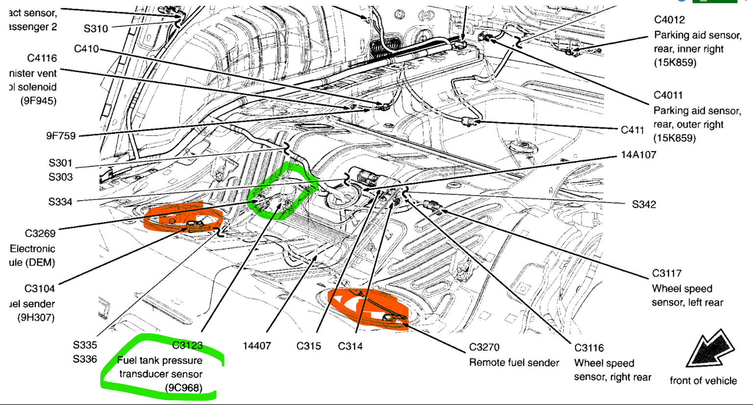

If you look back up top, i put directions to get to it by removing the rear seat. It's a 3-wire sensor, so a Reference voltage wire (5 volts) yellow/light blue wire, a ground (grey/red wire) that's shared with the Mass Air Flow sensor and the APP sensor (Accelerator Pedal Position), and a Signal wire back to the ECM (red/pink wire).
So, you can check that it has its Ref voltage and its Ground. To be certain of the Signal wire is making it back to the ECM undisturbed you can check the voltage at the sensor and either compare that to scan data or go to the ECM and check the Pin there and see that the voltage reading is the same. But with a High Voltage code I would be concerned with bad ground or short to the signal wire. But do the gas cap test, it's probably just a bad sensor. These sensors are so sensitive, the expansion of the Fuel Vapors is actually measured with this sensor. That's just from the fuel vapors warming up. Thats what Fords Vapor Generation Test is, so it's the opposite of the vacuum test. But if you think about how low the pressure rise would be from just vapor expanding, it's such a small amount and that's why this sensor has to be reading in H20, to watch for such slight rises.
But that fault was the original code you had at the beginning of this. I'm a little surprised this is a no start condition. I don't think this would cause a no start condition. So, I would probably pull the rear seat and check the wiring harness back there. Maybe the harness is in trouble and the fuel pump is losing power or ground as well.

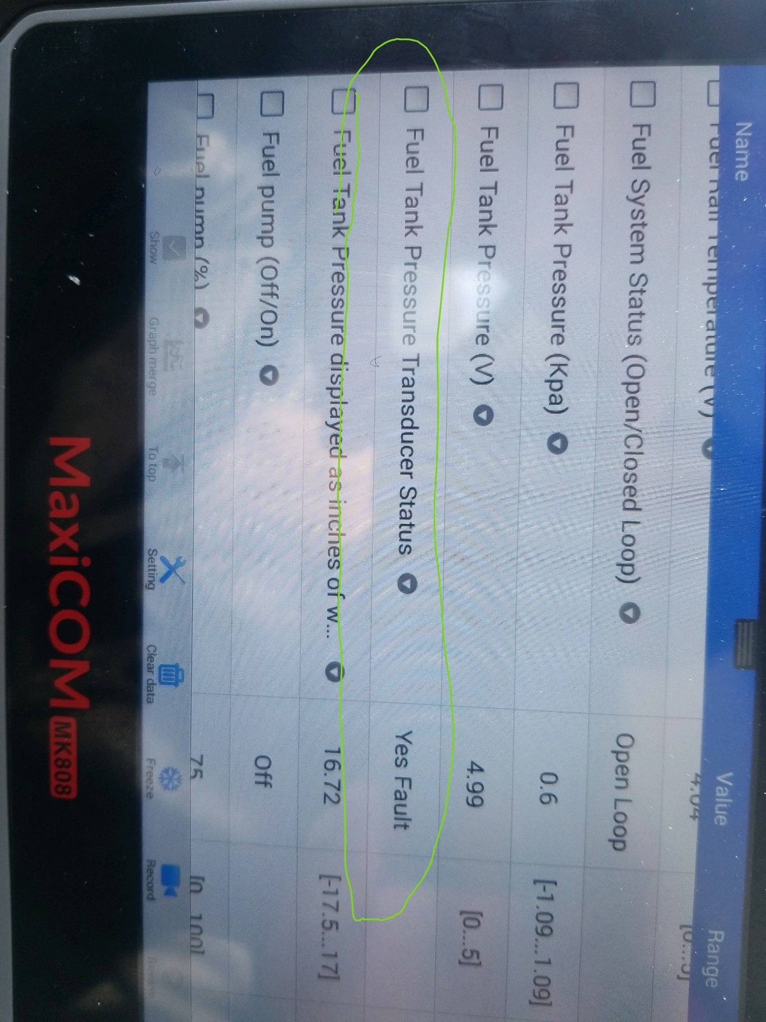

And that data, is that just Key On or is that Cranking? I'm also concerned with the Fuel Tank Pressure value is maxed out. Fuel pump command is off, is this still a no start, correct?

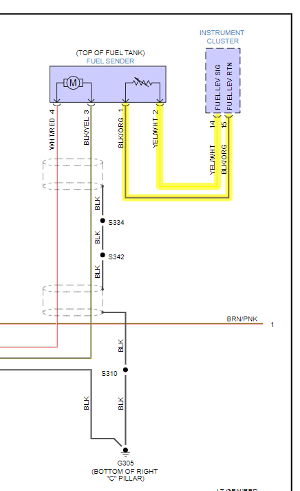

The car will start and run for about 3 to 7 seconds before it stalls. I didn't think to check the values with cap off great idea. I have gone out and checked the values and the pressure with cap off stays at 16.72 no change from key on to start and stalling. The voltage stays at 4.99. The sensor I looked at was only a two-wire sensor on the driver's side of the fuel tank. There are 2 separate access holes, one on drivers and one on pass. The passenger has the fuel pump and lines on the other side have just one two wire sensor. Any and all pictures or videos you may need I can go out and take them really quickly. As for voltage with the multi seamed spec unless I checked the wrong one of course. But I do not see a 3-wire sensor on the tank. Thank you again.

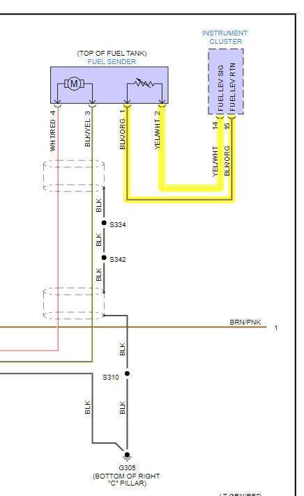

Never mind the two-wire sensor on the driver's side is the fuel level sensor.
Jan 30, 2022 at 11:54 AM
AL514
  • 5,587 POSTS
So, I'm assuming the 2-wire sensor you are seeing is the sending unit for the Fuel Gauge on the cluster. I see the 2 access holes, so the Fuel Tank Pressure Transducer is going to be through the passenger side access, it's going to be high up on the tank, so it avoids liquid gas. It may be attached to the Vapor line coming off the top of the tank, but it will be at one of the highest points, 3rd diagram is the connector. My biggest concern is that 4.99 voltage reading. That almost points to the Signal wire possibly being shorted to the 5-volt reference wire. And the no start issue might be another problem all together. Is this an Auction vehicle? With the start-stall issue, which sounds fuel related. Does this car have Dual Fuel injection? Two injectors per cylinder?
Another concern is that your Fuel pump Value is reading 75% but the Fuel Pump command is "off". There's more going on here, I think. This does have a Fuel Pump Module that is responsible for Fuel control. So, it's not directly the ECM.
After a stall out, what are your fuel trims reading? and are the 02s giving any reading at all. I know its in Open Loop, so the ECM is going to be looking at the Coolant Temperature for fuel control until it goes into Closed Loop operation.

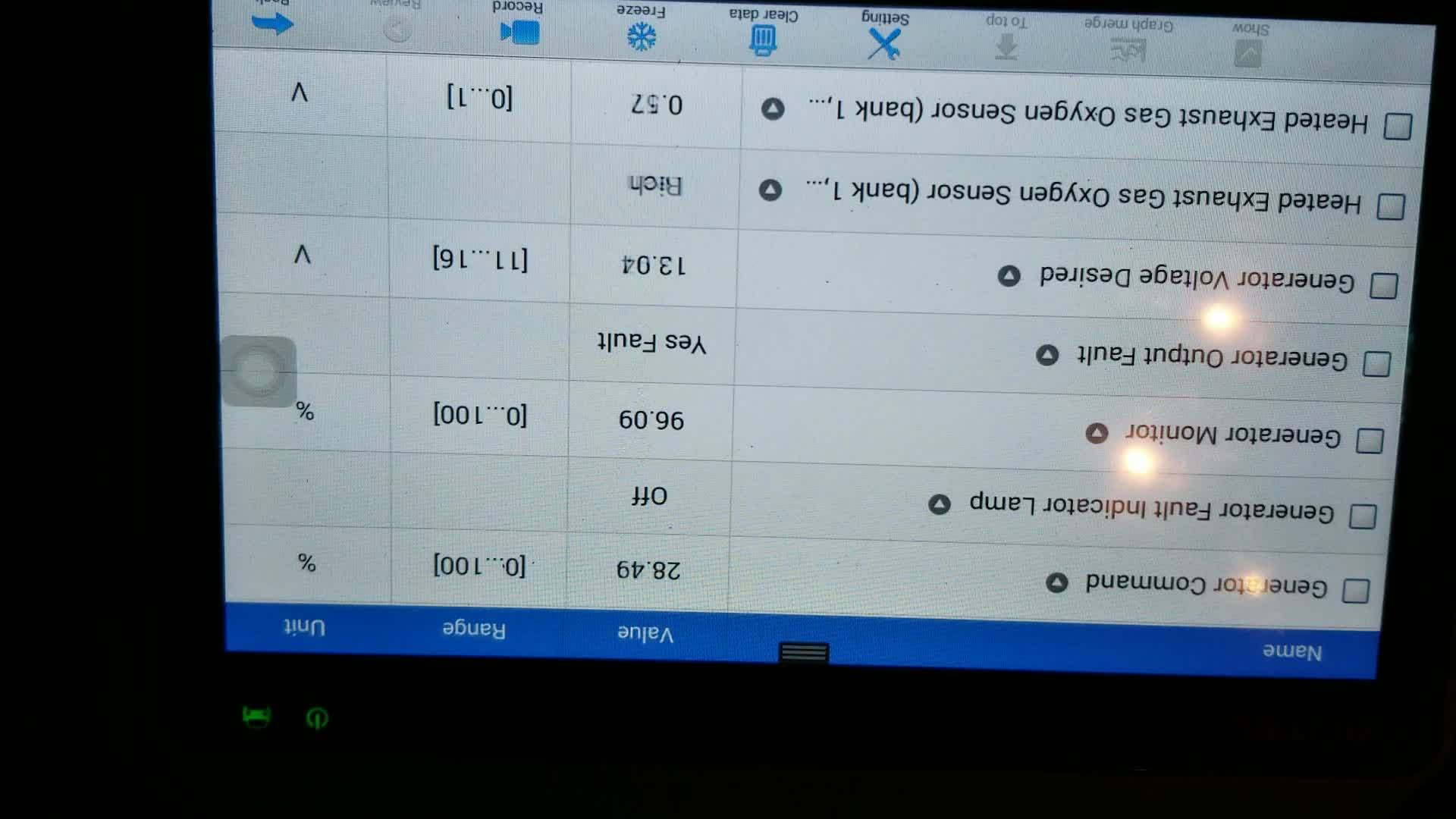

oh, wow what's the definition under Generator Monitor, what does that value mean? its reading a fault, was there any code for the Alternator? I wonder if a diode failed inside the alternator and it's putting out ac voltage ripple. You can check that by setting your multimeter on ac volts, it will be a very low range (around 2-volt range). The Max ac voltage is only 50-75mv, so if the diode set or just one diode out of the 3 is bad it can send the ECM into a mess. It can't read ac voltage. Some alternators will still show a charging voltage but have failed diodes that can take out the ECM, it looks pretty unsteady, Id like to know what that value % means though, that little arrow next to it will have the definition of that parameter. I would think there would be a code too if the ECM is picking up a fault like that.
And you're correct, if there's some strange voltage issue going on who knows what codes it will throw out, I took a screen shot of your Scan tool. Looks like an Autel correct? Ill see if I have that data pid on mine. I know the car has a Fuel Tank Pressure sensor, but I would do the same you're doing and worry about a charging system issue first.

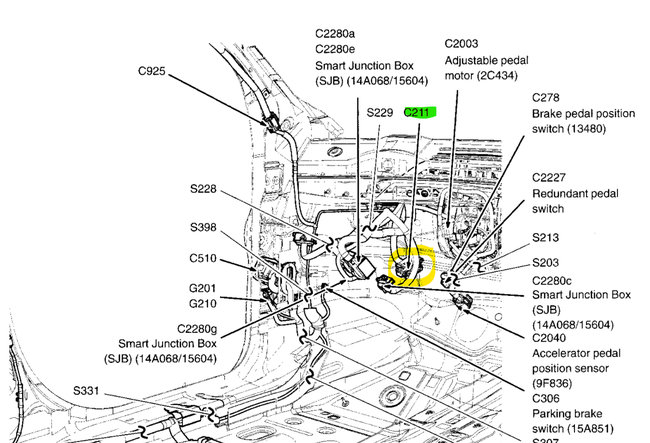

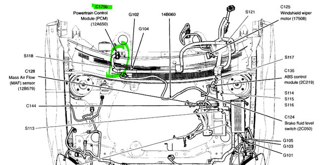

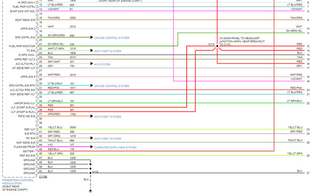

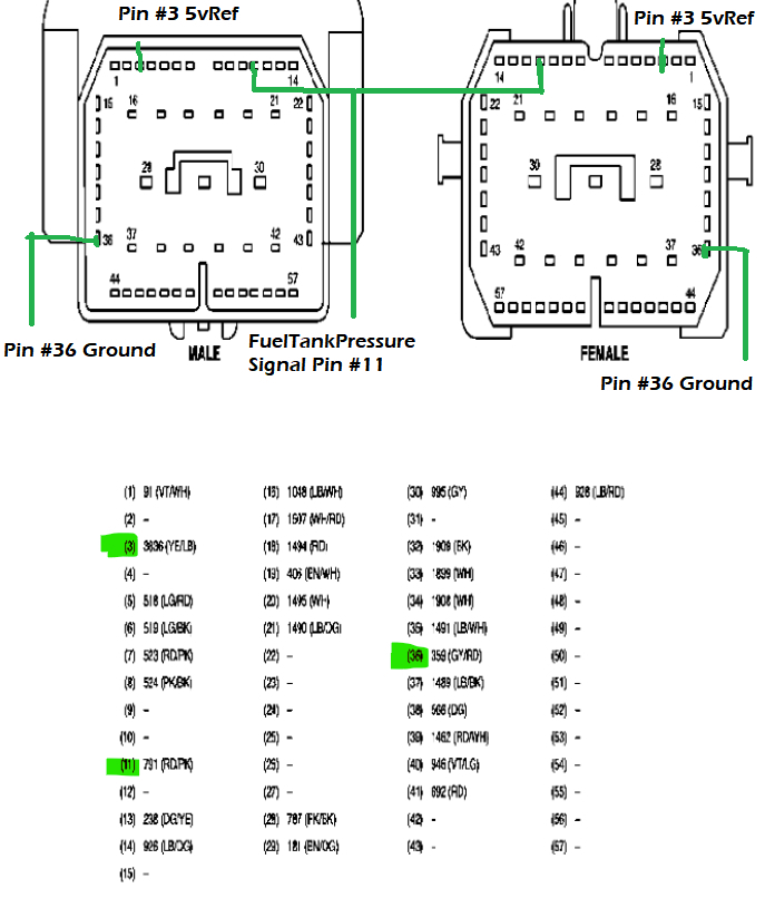

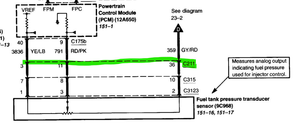

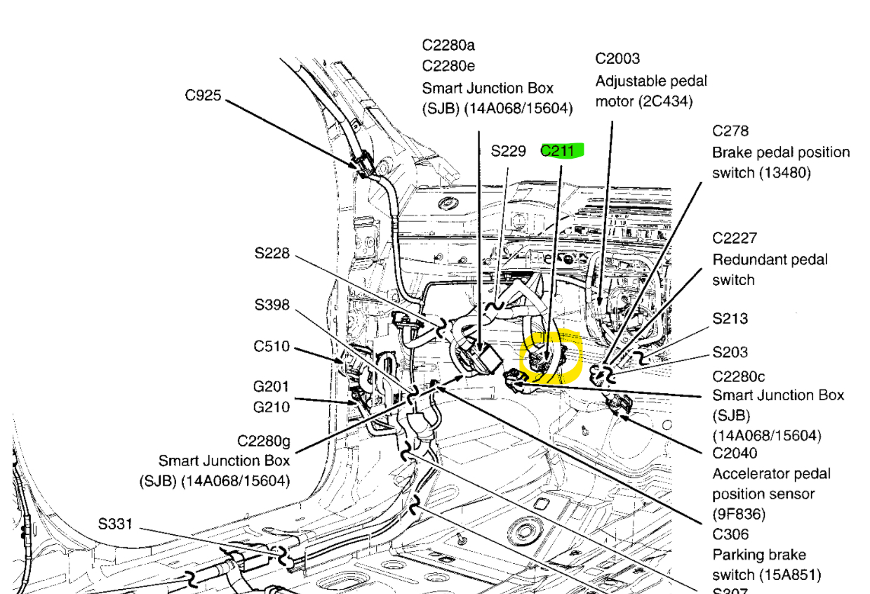

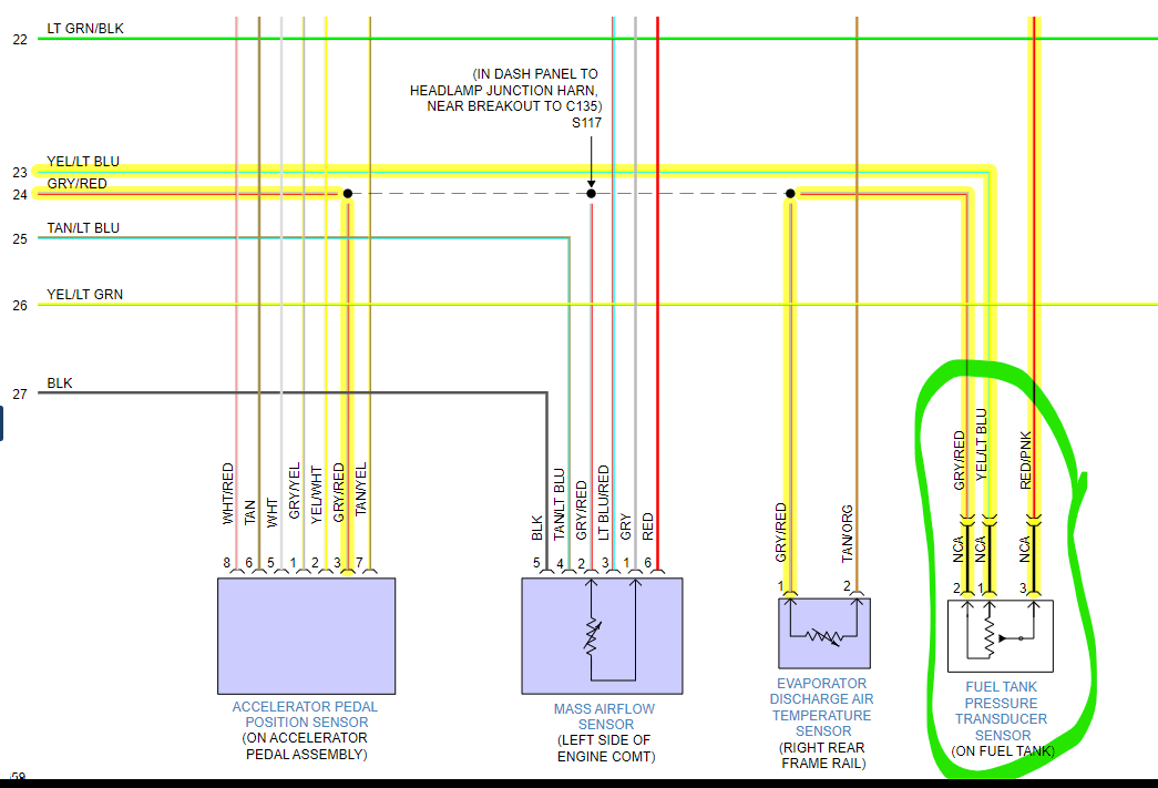

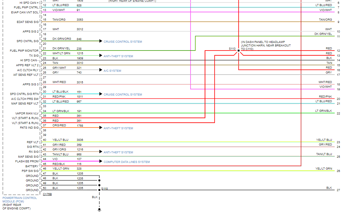

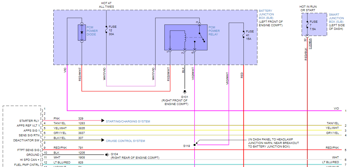

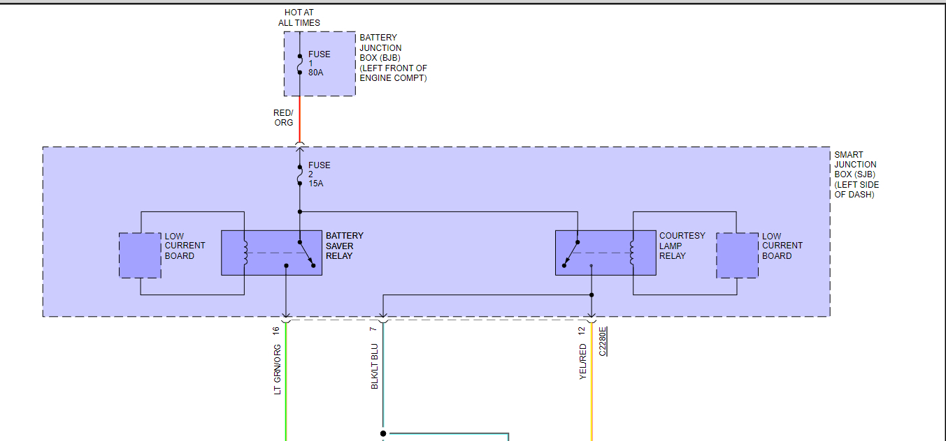

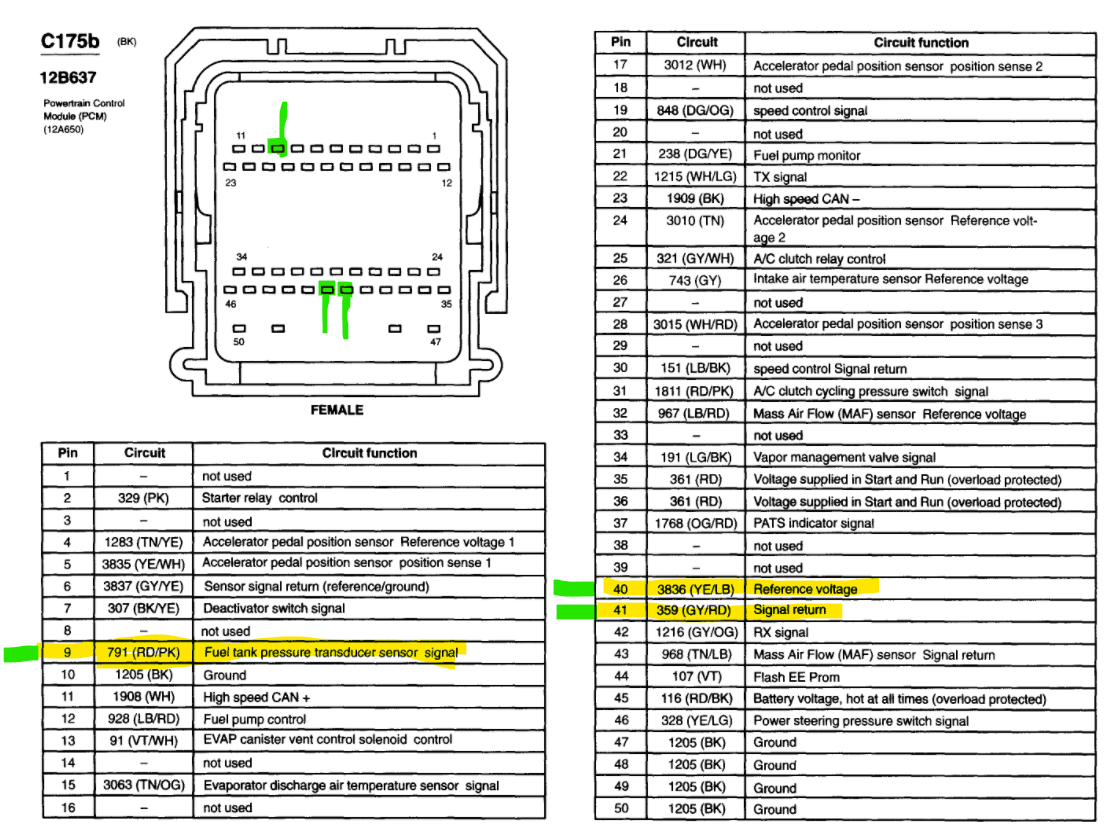

Okay, I just went through an hours' worth of wiring diagrams, I found a connector C211 that has the Fuel Tank Pressure sensors 5vRef, Signal, and Ground, it's under the driver side dash. It's a bulk connector so I don't what else runs through it, ie, airbag wires and such,
So, i don't recommend pulling the connector apart, but you could back probe the connector and see what voltage readings you're getting there.

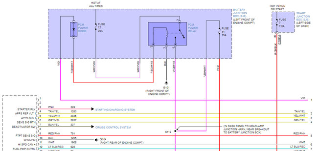

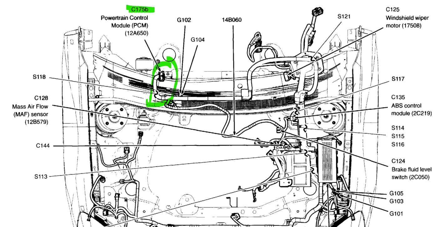

Another option is going right to the ECM connector C175B which I recommend this because it might be easier to get to and we know everything that's on that connector. You can even de-pin the signal wire or its reference voltage wire and see if one is shorted to the other. It looks like the pressure sensor doesn't share the Ref voltage with any other sensors. It does share a ground though.
So, I leave it up to you how you want to do this, but it's going to be much faster than trying to get to that sensor near the gas tank. Plus, I found that the Tank Pressure sensor can be an inline on the vapor hose, there's 2 different types.
So, I recommend going to the ECM and checking at the C175B connector, I will put everything you need for diagrams below. You can even check the Input Battery Voltage (hot at all times) on Pin #45.
I'm going to put the other connector that's under the driver side dash if you want to back-probe that connector too. Connector C211 (diagrams 3-5)
Diagram 6 is the 2 types of Tank Pressure sensors, probably why we can't find it under there. And finally pages 7 and 8 are everything on that ECM connector C175B so you know what you're disconnecting if you unplug it. I don't know if you need to disconnect the battery negative to unplug the ECM connectors on this vehicle, I would definitely have the key Off first. But at least you can get at these wires now.
I know that if you unplug the connector on a 3-wire component that uses a 5vRef you will read 5 volts on the signal wire because it's usually a bias voltage from the ECM to check the circuit integrity.

No, I think if you're really seeing a difference with temperature change and it's consistent then that's something to consider. You have a charging fault too. With heat related problems they come and go in a matter of minutes, so if we step back and look at everything together, you've got a charging system fault that the ECM is seeing, it's also seeing and evap system fault, a high pressure reading in the tank when there's no actual high pressure. Thats what we know. This can definitely be a pin-fitment issue at the ECM or one of those bulk connectors. Thats what I would be checking, and do it right where it all starts, the ECM connector. You don't need to get under the car for that and if you look at where that ECM connector is, the bottom of the windshield is the perfect place for it to get water intrusion.
Really, go check those connectors. That first picture shows the ECM connector being right under the windshield cowl.
This all points to a connection issue.

The other thing I noticed in your live data video is that the scan tool was indicating a Generator Fault, but if you notice the ECM was not seeing it, just above that it was not putting the Generator Fault Lamp on. Thats also very strange, it looks like part of the ECM is seeing a fault, but another part is not reporting the fault. I didn't see if you had actually unplugged the ECM and checked the connectors or not.

I fully agree, you were seeing a Generator fault, I saw it too. I don't think it's fixed. But like you said until it's cold enough to see, we won't know. May want to warn your customer about this, just to cover yourself. I have pictures of the Fault on your scan tool. Changing a part due to a code is the worst thing to do. But that was their call. Hope it goes well.. If some other code comes back or the battery light, we'll have to look back into it, But the intermittent cold issue is tough, especially with spring coming, it may not act up until next fall now.. Anyway, have a nice day...
