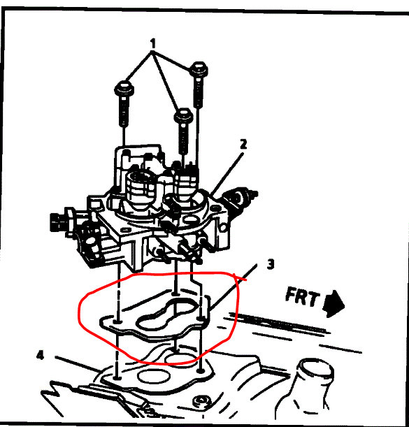

I did find a broken boot on the vacuum tube that goes to the PCV valve. I replaced it and it didn't fix the issue. I was reading the directions in the link and where is the throttle bore gasket? If it makes any difference I can smell the exhaust much more like the truck is running rich.

The throttle bore gasket, it is between the throttle bore an the intake. See pic 1.
If the gasket is leaking, that would create a lean mixture. The idea that you smell fuel would indicate a rich fuel mixture. Have you checked fuel pump pressure to see if it is high?

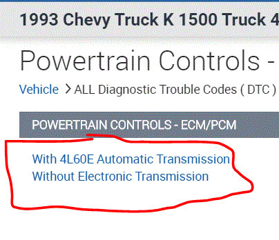

You may have an issue with the EGR hanging up or even a vacuum issue. Have you done any work on it? Let me know that and if you have an electric shift transmission or not. See pic 1.

I have not done any work on the EGR but I did pull a lot of the vacuum lines off to inspect them and make sure they were okay when trying to fix the other issue. I don't know how to find out if i have an electric shift transmission.

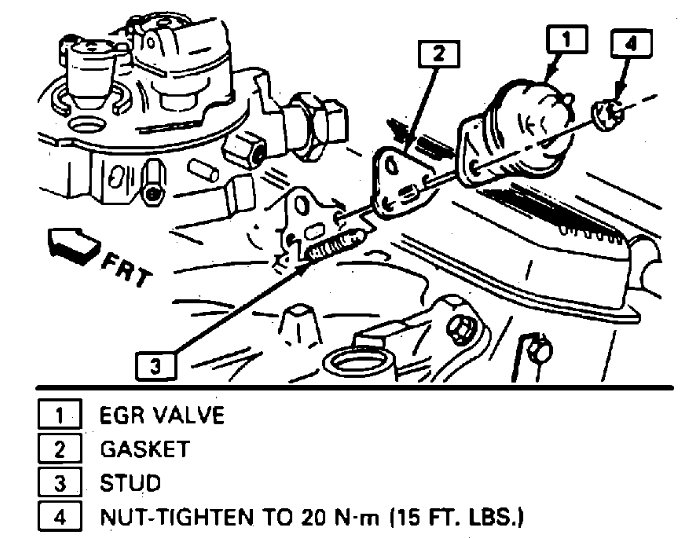

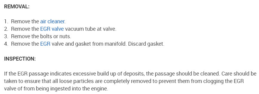

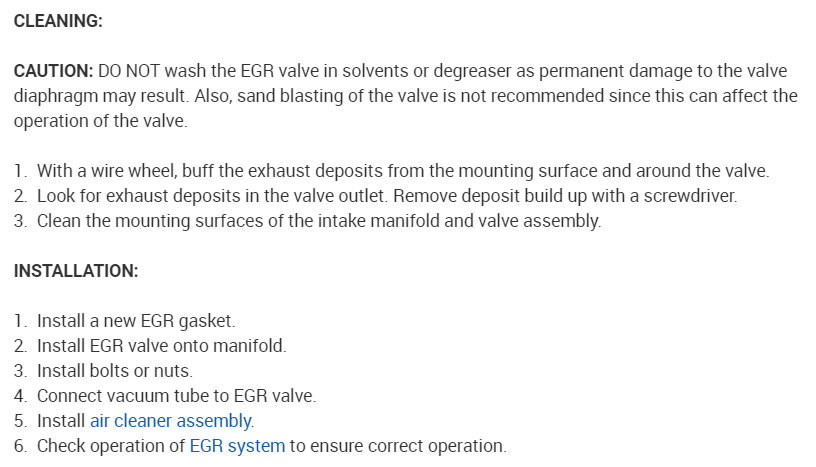

Hello, I'm Danny.
Just here to add my 2 cents. I've attached a picture of the location of the EGR valve and cleaning instructions if this helps. I've owned a few 88-98 K1500's. The EGR is behind the throttle body near firewall.If it's too far gone you can replace. As far as your transmission it is more likely to be the 700R4 which is non-electronic. We can confirm with your VIN - the vehicle identification number.Attached my K1500's below.Hope this helps and thanks again for using 2CarPros.

I know from past, and present transmission issues, that my transmission is a 4L60E. I will also get on with cleaning my EGR valve. Thank you

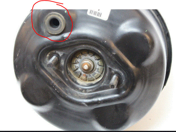

Okay, I have put about 175 miles on the truck. Now when I start it it almost seems to be missing. If I shift it into gear it will almost chug out and shut off. If I shift back to park or neutral it won't go back to normal until I let off the brake. After 5 minutes or so everything seems to even out and I have no issues after that. Even restarting it it will run fine. The issue starts if I let it sit and let it cool down.
Jul 23, 2020 at 12:50 PM
  • 110,248 POSTS
Does releasing the brake seem to clear things up for you? The power brake booster could have a vacuum leak. The brake booster is behind the master cylinder.
There will be a large vacuum hose running to it. I attached a pic I found on the net and circled where the vacuum hose will connect. Make sure nothing is leaking at that point.

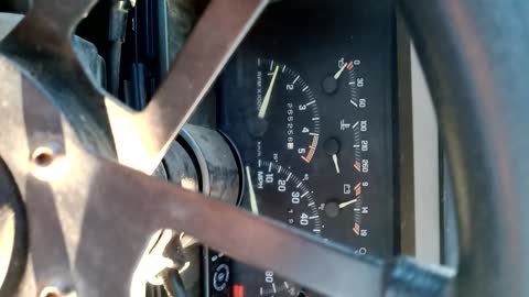

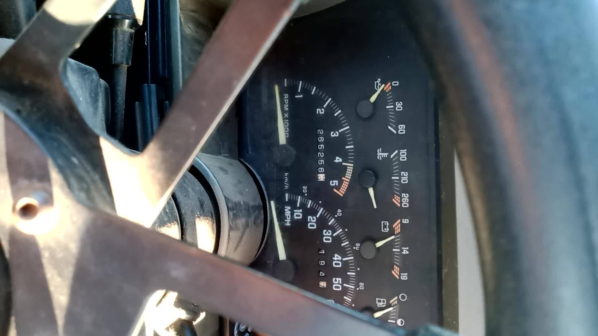

Sep 1, 2020 at 12:08 PM
TRUBLUROOKIE
  • 48 POSTS
Sorry the video isn't louder. I don't have exhaust on my truck so I though there wouldn't be any trouble hearing it. There did a not one time I gave it has to keep it from shutting off before it leveled out and drove without issue.
Sep 1, 2020 at 12:11 PM
  • 110,248 POSTS
I really can't hear it, but noticed the temperature gauge is off. Do you have access to a live data scan tool? If the engine coolant temp is sending a radical signal, it won't set the check engine light but will cause issues with the air/fuel ratio. That can cause issues.
Sep 1, 2020 at 1:12 PM
