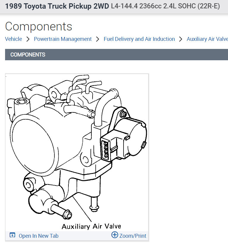

If I'm driving it at operating temperature it runs like a charm except for the occasional backfire and flames. It had the top end rebuilt along with the manual fuel pump being replaced. The brake light is on and I was told it was a vacuum leak but couldn't find a bad vacuum.

This sounds like the throttle body and IAC motor needs to be serviced. Here are three guides to help us see what's going on:
https://www.2carpros.com/articles/idle-air-control-valve-service
and
and
https://www.2carpros.com/articles/why-does-my-car-engine-stall-when-hot-and-how-can-i
Check out the images (below) to see how the job is done on your truck. Please upload pictures or videos of the problem so we can see what's going on.
