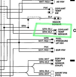

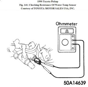

SERVICE WRITER
  • 9,123 POSTS

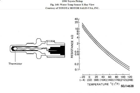

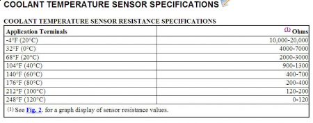

First thing I would check is the CTS since you are unable to verify codes.
A bad cts can cause a rich condition.
https://www.2carpros.com/forum/automotive_pictures/30961_toycts_1.jpg
https://www.2carpros.com/forum/automotive_pictures/30961_toycts1_1.jpg
https://www.2carpros.com/forum/automotive_pictures/30961_toycts2_1.jpg
Is this sensor in spec?
+1
Thursday, October 8th, 2009 AT 6:19 AM
DENNYT
  • 11 POSTS
I'll try to check it out today. Thanks

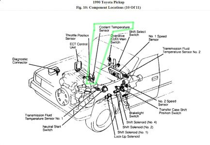

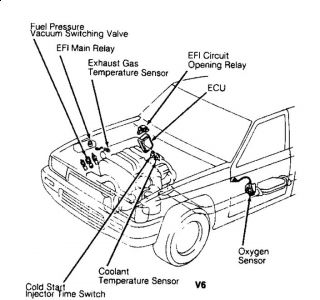

I can't seem to locate this sensor I have the 3.0 6cylinder fuel injected motor. Can you tell me where that cts is located or send me a better diagram. I would really appreciate it. Thanks Denny
Thursday, October 8th, 2009 AT 9:55 PM
SERVICE WRITER
  • 9,123 POSTS
It is in the coolant passage at the rear of the intake manifold.
https://www.2carpros.com/forum/automotive_pictures/30961_toyloc_1.jpg
https://www.2carpros.com/forum/automotive_pictures/30961_toyloc1_1.jpg
https://www.2carpros.com/forum/automotive_pictures/30961_toyloc2_1.jpg
Check for wire colors if you aren't sure. Getting good information thatis clear in the industry isn't always available.

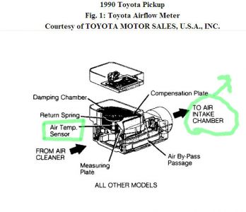

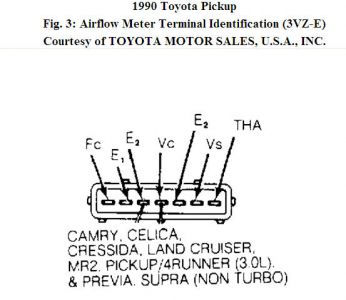

Unplug the mass air flow sensor and see how it changes the symptoms. Also check the air snorkel for any cracks that may be allowing unmetered air.
Saturday, October 10th, 2009 AT 5:55 AM
DENNYT
  • 11 POSTS
My truck is the3vz-e engine the book I'm looking at has a volume air flow metet(vaf) on the next page it shows a mass air flow meter (maf) but it's for different enging models than my truck. Can you send me a diagram of this sensor? And where is the air snorlel. Thanks Denny
Saturday, October 10th, 2009 AT 9:59 AM
SERVICE WRITER
  • 9,123 POSTS
https://www.2carpros.com/forum/automotive_pictures/30961_toymaf_1.jpg
https://www.2carpros.com/forum/automotive_pictures/30961_toymaf1_1.jpg
Sunday, October 11th, 2009 AT 6:49 AM

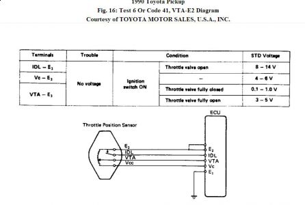

SERVICE WRITER
  • 9,123 POSTS

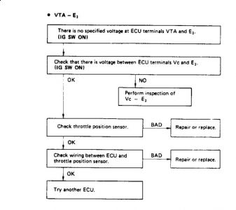

Codes 24 and 31 fall under the same test procedure.
IF this were mine, I would get some electrical cleaner spray and clean the mass air flow meter and the air temp sensor. If symptoms still exist I can post a troubleshooting chart for the code. I expect these two codes to be related.
For the code 41 the tps, there is 3 charts. Run through this one first.
https://www.2carpros.com/forum/automotive_pictures/30961_toy41_1.jpg
https://www.2carpros.com/forum/automotive_pictures/30961_toy41a_1.jpg

Denny, did you unplug the MAF and see how the perfomance changed?
https://www.2carpros.com/forum/automotive_pictures/30961_af_1.jpg
Tuesday, October 20th, 2009 AT 4:14 PM
DENNYT
  • 11 POSTS

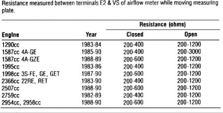

Yes I did unplug the maf and the engine died. I don't know how to test the maf with the ohm meter, do I unplug it fron the electerical connecter? I'm not sure how to do this step. Thanks Denny and thankd for hanging in there with me!
Friday, October 23rd, 2009 AT 9:15 AM
SERVICE WRITER
  • 9,123 POSTS
Un plug it and check the resistance with your ohm-meter on the terminals noted. Move the measuring plate....(throttle plate, I believe ). The resistance should fall between the value on the chart.
https://www.2carpros.com/forum/automotive_pictures/30961_30961_toymaf1_1_1.jpg
https://www.2carpros.com/forum/automotive_pictures/30961_30961_toymaf1_2_1.jpg
