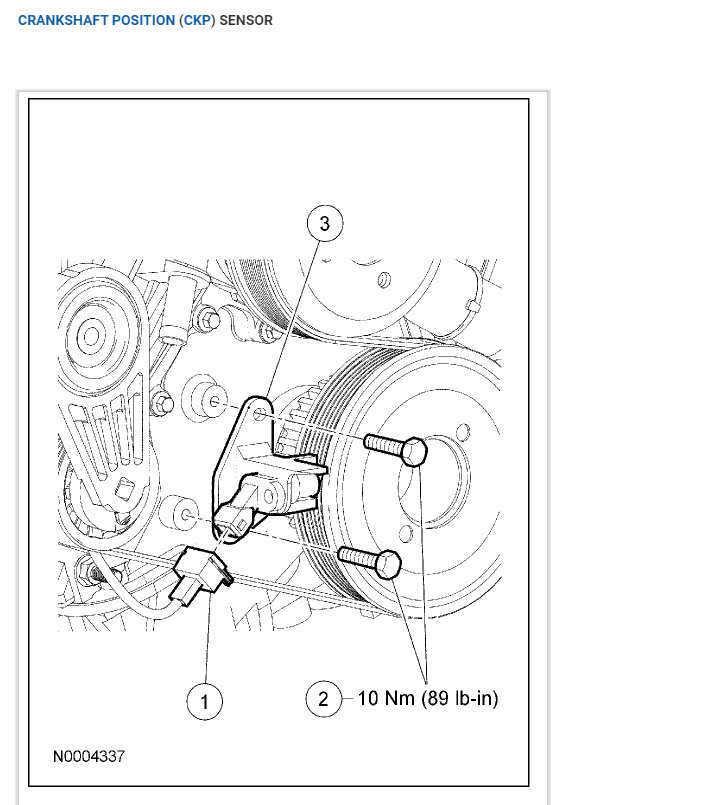

When you say it will not turn over do you mean you turn the key and nothing happens? Or do you mean it cranks but will not fire? Many people get these confused but they are very different issues.

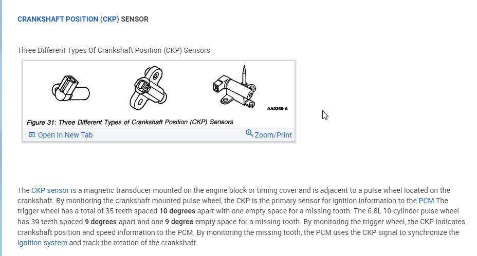

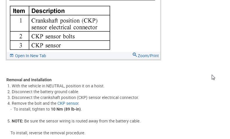

If it is a crank no start (turns over but does not start) then I suspect the crank sensor is the issue. However, we need to check for fuel and spark. Check for fuel by seeing if it starts with starting fluid in the intake. Check for spark by pulling a spark plug and reconnecting to the ignition and holding it against the block to see if there is spark.
Let me know what you find and we can go from there. Thanks
