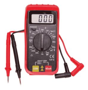

Ok we either need to get our hands on a digital multi meter or have the cam sensor checked. It could have corrosion on the plug or not be sending the signal correctly or? Here is a pic of a inexpensive multi meter. If you are not comfortable doing these tests please just let me know and I will let you know what tests I would run if you would rather have a shop do it ok.

I don't know enough about mechanics to do the tests so please tell me what to tell my mechanic.

Ok if you would have him unplug the camshaft sensor and ohm it. Get back to me with what you find and I will look it up to see if it is in spec.
