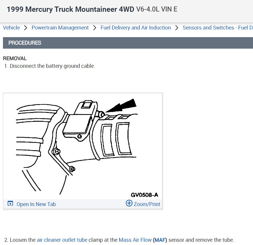

Yep this can be many things included the MAF sensor, I would run the codes which this guide can help with and if a code comes up for the MAF I would replace it.
Here is the MAF sensor location. Check out the images (below). Please let us know what happens.
