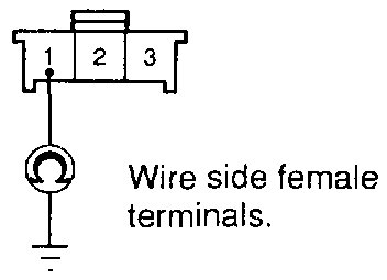

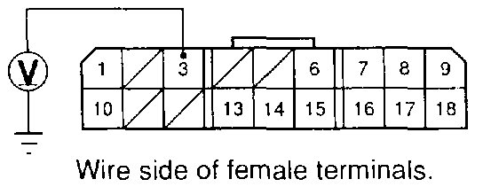

My SRS light is on my Honda Avancier. I can't afford to take her to a mechanic. so i decided to fix her my self. Sorry they didn't have my model in the selected box. Can you help me?

There are a few things that can cause this light to come on for you. The only way to be sure where the problem is originating is to scan the computer for diagnostic trouble codes. Here is a quick video showing how it is done:
https://youtu.be/YV3TRZwer8k
I realize most people don't own a scanner, but to avoid replacing parts that are good, we need to first determine the problem. Often times even a parts store will scan it for you or lend / rent you a scanner.
Do that and let me know the results.

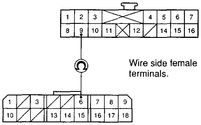

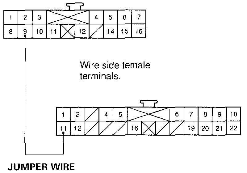

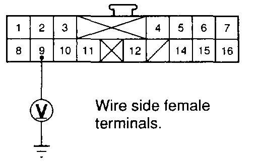

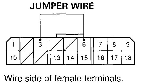

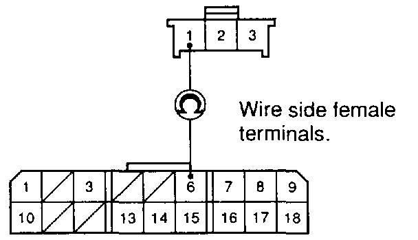

It is called an OBD 2 scanner. And it will need to be plugged into the OBD port under the dash of the vehicle. To read the codes will require a higher level scanner. The lower cost ones are designed to only read power-train codes.
Here is a flow chart related to the SRS light not turning off. Take a look through it. It is somewhat involved. The attached pictures correlate with the directions.
Note: This information is for an Accord. I will not have the specifics for your vehicle, but wanted you to see the process.

8. Disconnect the battery negative cable, and wait for three minutes.
9. Disconnect the driver's and front passenger's airbag connectors.
10. Disconnect the SRS main harness 18P connector from the SRS unit.
11. Reconnect the battery negative cable.
SRS Main Harness 18P Connector
pic 1
12. Connect a voltmeter between the No. 3 terminal (+) of the SRS main harness 18P connector and ground.
13. Turn the ignition switch ON .
Is there battery voltage?
YES - Go to step 14.
NO - Open in the SRS main harness (VB line); replace the harness.

14. Connect the SRS main harness 18P connector terminals No. 6 and No. 3 with a jumper wire and backprobe adapters.
Does the SRS indicator light go off?
YES - Faulty SRS unit or poor contact at the SRS main harness 18P connector; check the connector. If the connector is OK, replace the SRS unit.
NO - Go to step 15.

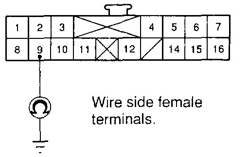

16. Turn the ignition switch OFF.
17. Disconnect the dashboard wire harness 16P connector from the gauge assembly.
SRS Main Harness 16P Connector
pic 3
18. Check resistance between the No. 9terminal of the dashboard wire harness 16P connector and ground. There should be 1 M Ohm or more.
Is the resistance as specified?
YES - Short to ground in the gauge assembly; replace the gauge assembly.
NO - Go to step 26.

22. Connect the No. 9 terminal of the dashboard wire harness 16P connector and No.11 terminal of the dashboard wire harness 22P connector with a jumper wire.
YES - Go to step 23.
NO - Faulty SRS indicator light circuit in the gauge assembly; replace the SRS printed circuit board in the gauge assembly.

25. Check resistance between the No. 6 terminal of the SRS main harness 18P connector and No. 9 terminal of the dashboard wire harness 16P connector; there should be 0 - 1.0 Ohm.
YES - Go to step 28.
NO - Go to step 31.
26.Disconnect the SRS main harness 3P connector from the dashboard wire harness.
SRS Main Harness 3P Connector
pic 6
27.Check resistance between the No. 1 terminal of the SRS main harness 3P connector and ground. There should be 1 M Ohm or more.

29. Connect a voltmeter between the No. 9 terminal (+) of the dashboard wire harness 16P connector and ground.
30. Turn the ignition switch ON , wait for six seconds, then measure voltage.
Is there 8.5 V or more?
YES - The problem corrected itself after disconnecting and connecting the connectors. Be sure all terminals make good contact, and recheck the system (see Troubleshooting Intermittent Failures)
NO - Poor contact at the SRS main harness 18P connector; check the connector.

31. Disconnect the SRS main harness 3P connector from the dashboard wire harness.
pic 8
32. Check resistance between the No. 6 terminal of the SRS main harness 18P connector and No. 1 terminal of the SRS main harness 3P connector; there should be 0 - 1.0 Ohm
YES - Open in the BLU wire of the dashboard wire harness; repair the dashboard wire harness.
NO - Open in the SRS main harness; replace the SRS main harness.
