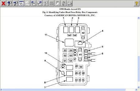

BAKOLLEH
My Honda accord runs great. One of my brakes light blew off. It ran fine. Quite recently, when I start the car, I don't see the brake light on the dash board as I should and it is very difficult to get from the Park mode into either the reverse or drive mode. My wife could not take it to church because it wouldn't shift from the park mode. What do I need to do??
Please help!!
Sep 30, 2020 at 10:56 AM (Merged)
KHLOW2008
  • 41,814 POSTS
Hi bakolleh, The interlock system is being locked out and the symptoms described seems to indicate: 1 a faulty brake switch or 2. a blown brake fuse. Check underhood fusebox Fuse # 47 (20A)
https://images.2carpros.com/forum/automotive_pictures/192750_FuseBox98Accord4cylHood_2.jpg
