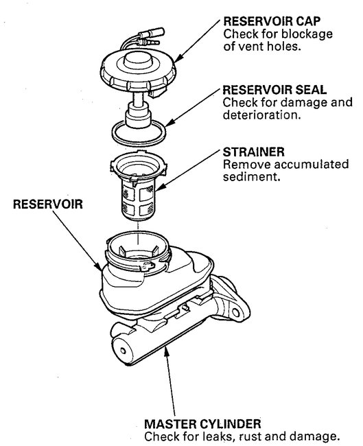

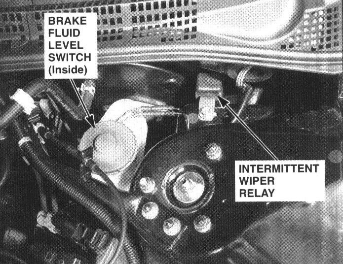

RIEBE123
  • 46 POSTS
I just did a lot of brake work including replacing the master cylinder, now the brake light keeps coming on at random.when I tap the cap of the master cylinder it goes off. I have no problem braking. my question is, is the sensor in the brake cap bad and does the master usually come with a new cap? I didn't have this issues before the replacement.
Sep 30, 2020 at 5:54 PM (Merged)
  • 110,194 POSTS
Welcome to 2CarPros.
Chances are the switch is going bad and sticking (or the fluid is low). The switch is in the cap and basically functions as a float. As the fluid goes down, the plunger drops. At a specified point, it actuates the light.
You can try removing the cap and moving the plunger up and down to see if that takes care of it. Other than that, it needs replaced.
By the way, this cap doesn't come with a new master cylinder.
I attached two pictures. Picture 1 shows that the cap is the switch and picture 2 is an exploded view of the cap and reservoir.
Let me know if you have other questions or need anything.

DAVE1310
  • 64 POSTS
Thanks a lot-I have to replace the cap since I already played with the plunger-appreciate the info.
