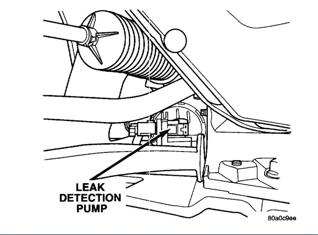

Does it matter if it is in gear? The description sounds like it could be electrical, like the leak detection pump. Shouldn't be hard to locate it though. Take a piece of water or heater hose, hold it tight to your ear and then use the end of it to track the sound, it will limit the sound to an area in front of the opening. Just be careful of the moving belt. It should let you at least track the sound to one component.

GARY Z
I can't say that it is not the leak detection pump, as I have never even heard of this part. But the chirp does sound metallic, not any type of an electric noise that I have ever heard before. Question: What is the "leak detection pump".
Mar 19, 2020 at 6:50 AM
  • 110,244 POSTS
The purpose of a leak detection pump is to pressurize the fuel system checking for leaks. It closes the EVAP system vent so the system can be pressurized and tested for leaks. I attached a pic below of it. Your vehicle does have one under the engine (passenger side).
The idea that it doesn't change with vehicle or engine speed really limits things. As Steve mentioned, the pump could play a role. Take notice if that is the area it is coming from and let us know. By the way, Steve, good thought on this one.

GARY Z
Can the leak detection pump make a type of chirp or any other strange noise when it's getting old? And, if yes, could the chirping of my van possibly be the leak detection pump?
Mar 19, 2020 at 8:30 AM
  • 110,244 POSTS
Interestingly, yes it could. It's a pump. To further the idea, it would not be affected by engine speed or vehicle speed. Could it be? Sure it could. However, don't just replace it without checking to see if that is where the sound is coming from. If you find it is, we will provide directions.
Let us know,
