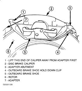

Had a complete brake job done. New pads roters turned and now there is a clicking noise in the right rear wheel when brakes are applied. Mechanic is baffeled. Can anyone help? Thanks.

Possible causes adapter abutments not lubed, left and right outboare pads different they are marked and damaged or worn guide pin bushings.
Hope this helps

Adapter abutments are lubed guide pin bushing fine outboard pads fine. Possible roter?

Could check rotor for true but no pedal pulse on braking? Check torque on wheel lugs 100 ft. Lbs.
