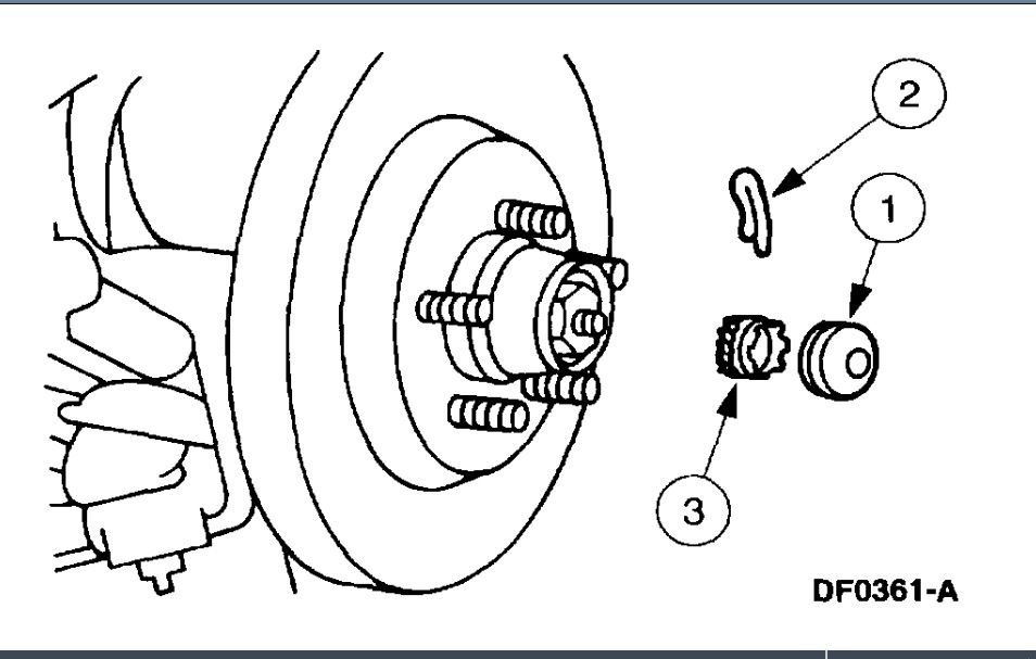

Heard a pop-like noise while turning around with wheel fully turned. shortly after that, the front passenger wheel basically was wobbling on the hub and i lost brake pressure. lucky that i was going slow! So, i had it towed to the shop that did my brakes. They said that the spindle nut and lock were missing? they did the front brake work about 6-8 months ago. Is there any way that i was driving for that long without the spindle nut on?

No, it is not possible. If there was no nut, it would have failed within miles.
Did they show you the failure?

When they removed the cap, they said it was not there? That does not make any sense at all. I think they are lying.
My guess is that they did not put in the cotter pin to keep it from loosening up. Over time, it came loose and the nut and washer came off inside the cap. They just did not tell you that.
That is my opinion and will be very hard to prove since so much time has passed.
