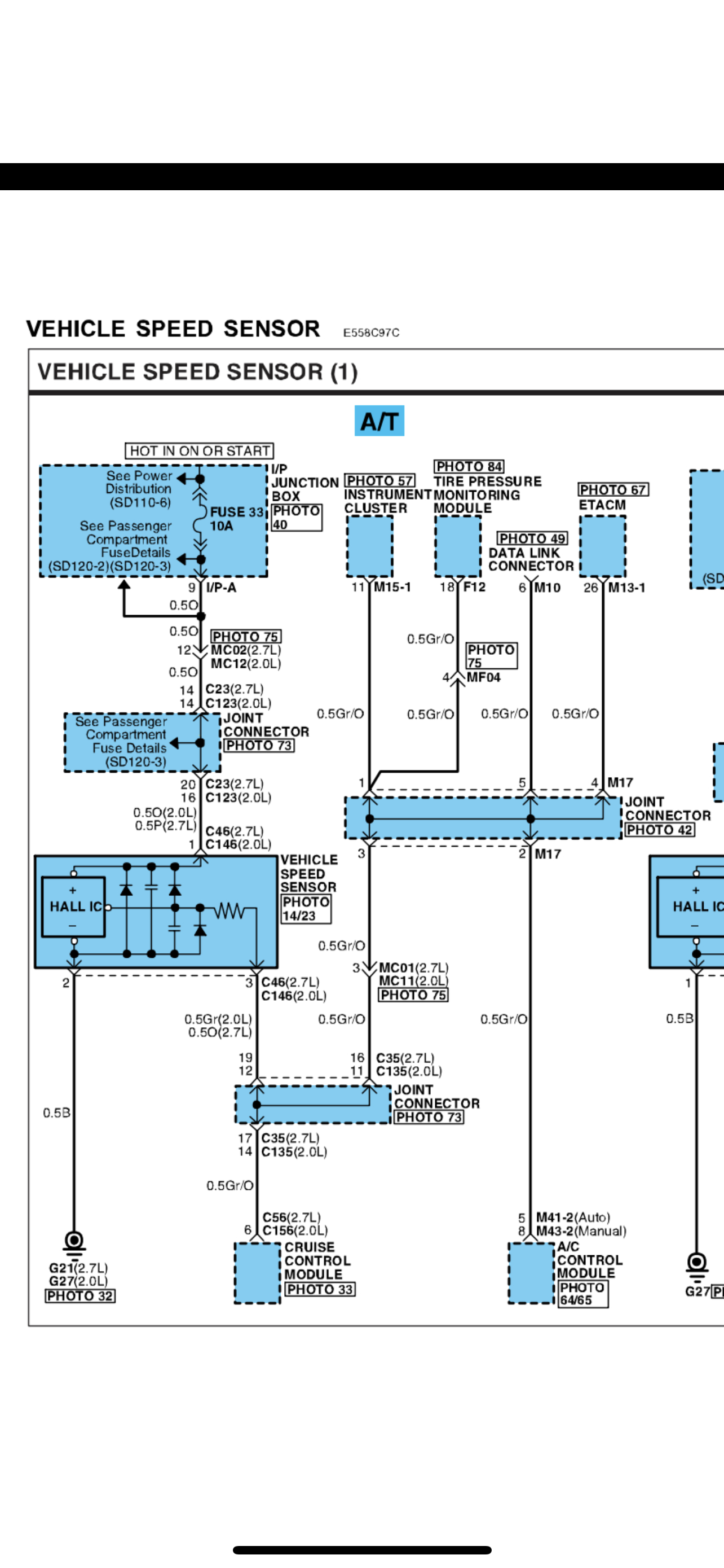

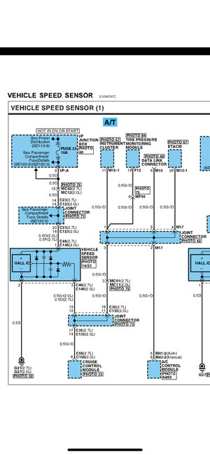

Thank you so much. That was some much-needed knowledge. I’m feeling confident that it’s a bad ground to the sensor. Now it’s determining where the break is. I’m trying to study the wiring diagram. I enclosed a photo of the one I found. If you have a better one let me know. At the bottom left of the diagram it shows a ground. Would that be the ground to the sensor? I don’t see any other grounds in the diagram. What is Hall IC in the diagram with the speed sensor. Thanks for the help.
Monday, March 13th, 2023 AT 6:01 AM
BRENDON S
  • 653 POSTS
Good morning, BDAB68,
You are very welcome. A bad ground is definitely a good possibility. Considering the vehicle age and mileage, a wiring issue is something I would be looking for myself. The Hall IC is a Hall Effect Sensor. I have included a video that explains how a Hall effect sensor works to give you a better understanding to aid you in diagnosis.
https://youtu.be/MEpZRcPZGxM
As far as the wiring diagram, I am not sure. You have to be careful what you get from the internet. I am working on getting a better diagram for you. Sometimes I find it helpful to draw my own as some of these wiring diagrams can be confusing and hurt your brain lol. But sometimes certain information is just not available.
But do the best you can to follow the wires and see where they are going. Previous diagrams I have looked at says the PCM is under the left side of the dash so the ground might lead close to that. The PCM may also be providing the ground.
Continue to work on it and see if you can find a bad ground and I will continue on my side to see if I can get you some better diagrams.

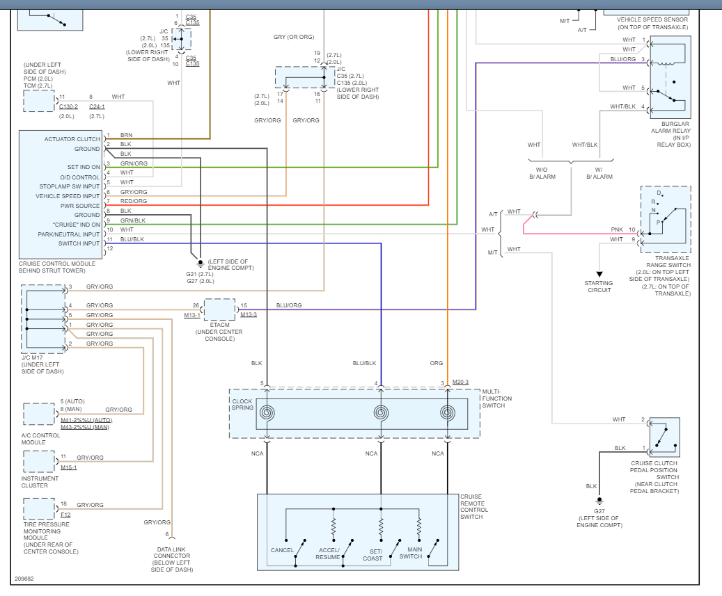

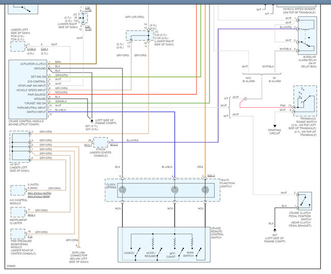

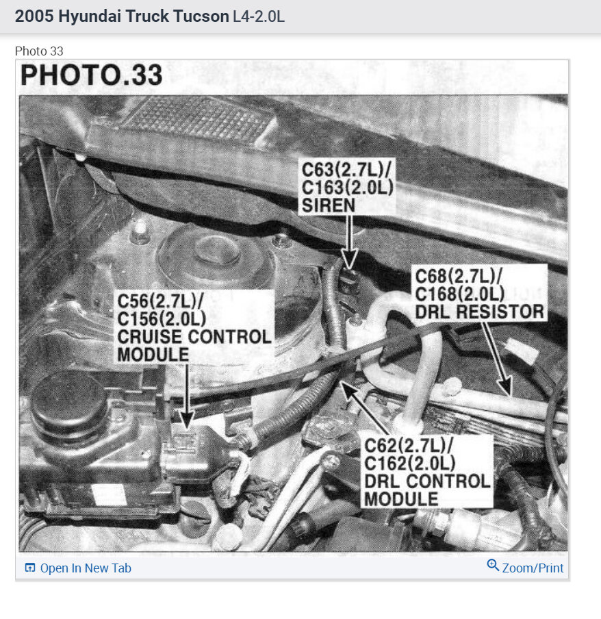

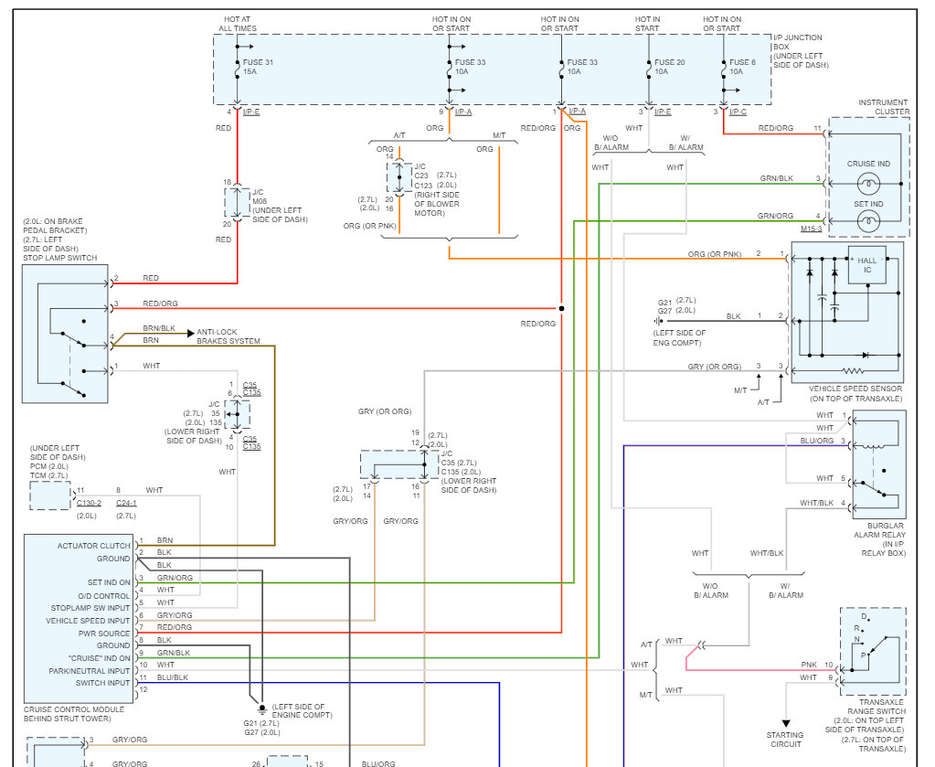

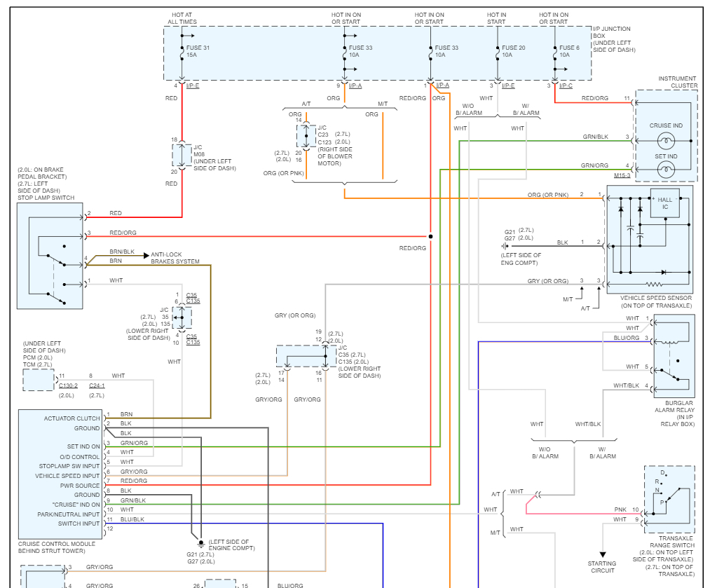

I wanted to jump in here if I could, the speedometer signal is generated form the cruise control module via the VSS, I would swap out the module to see what happens, here is the wiring diagrams so you can see how the system works and the location of the module in the images below. Please let us know what happens. I also see the spiral spring behind the steering wheel could cause the problem as well. A questionable connection through the spring would produce the same effect.

Thank you, Ken. I think my issue is the ground on the sensor. The reason being is using my multimeter when I use battery negative than touch the power source connector on VSS harness I get 12v. The signal wire gives me 10v. However, if I move my negative probe to the ground terminal on the connector, I get a big voltage drop. Only reading 2.7v on supply and 2.5v on signal. From your diagram it looks like the ground for the sensor is at the body in engine bay. So, splicing in a new ground should hopefully fix it. If it doesn’t then I will go into looking more at the cruise control module. I really appreciate all the help I’m getting with fixing this problem. I’ve learned so much and keep learning more thanks to you all.
Monday, March 13th, 2023 AT 9:13 AM
BDAB68
  • 30 POSTS
So, I ordered a new replacement VSS connector. I have a theory that might let me test if it is in fact the ground before I go splicing wires. My unorthodox thought is to hook up the new connector to the VSS then take the leads and place them in the original connector routing the ground to a new ground. See if the speedometer works. If it does, I’ll install the new connector and ground. If it doesn’t then I need to do some more digging. Perhaps like Ken said my problem lies in the cruise control module. I’m however feeling confident it’s a ground issue. It just surprises me that no codes are popping up. Usually, a bad ground would throw a code. Maybe that system isn’t monitored by the computer.
Monday, March 13th, 2023 AT 9:48 AM
KEN L
  • MASTER CERTIFIED MECHANIC
  • 48,323 POSTS
Yep, it should, that is why I thought it would be the cruise module shunting the signal.
Monday, March 13th, 2023 AT 12:23 PM
BDAB68
  • 30 POSTS
Well, I got it figured out. It was a bad ground. I did like I said to test it out. I got a new connector and ran the power and signal wire leads into the original connector. Then ran a temporary ground to the new connector lead and the speedometer worked. So did cruise control. Now I just need to splice in the new connector and run a good ground. I honestly can’t thank you enough for all your help with this. I have learned so much and now feel confident on how to test wiring. We can now consider this solved!
